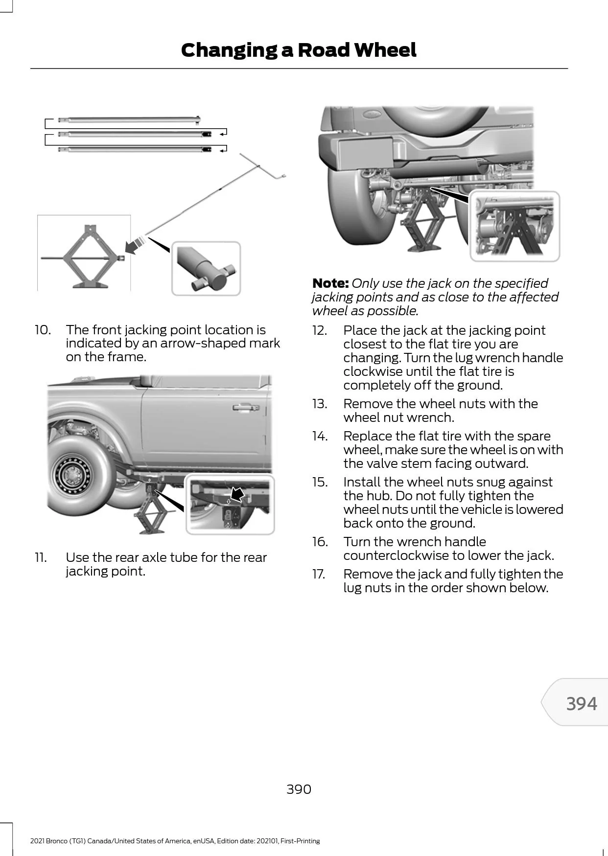

A bottle jack under the axle. Don't bother lifting from the bumper or frame.
Front jacking point is indicated by an arrow-shaped mark on the frame. Rear jacking point is on the rear axle tube.
Ford Bronco Jack options? 470C5659-29E3-408A-B7DB-B077D372834E
