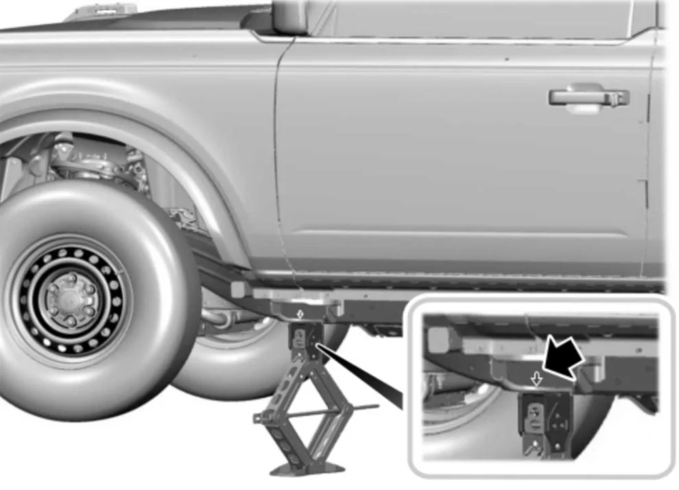

Ford Bronco Jack stand location 5F2B37E9-C859-4F40-A5A9-2698A55E0FEA

Looking closely at the drawing,... I wonder if the site is confusing the Bronco with the Bronco Sport.
The site says they didn't receive info from the OEM in time for publishing. I'm not even sure that image is a Sport. It's a misleading placeholder.

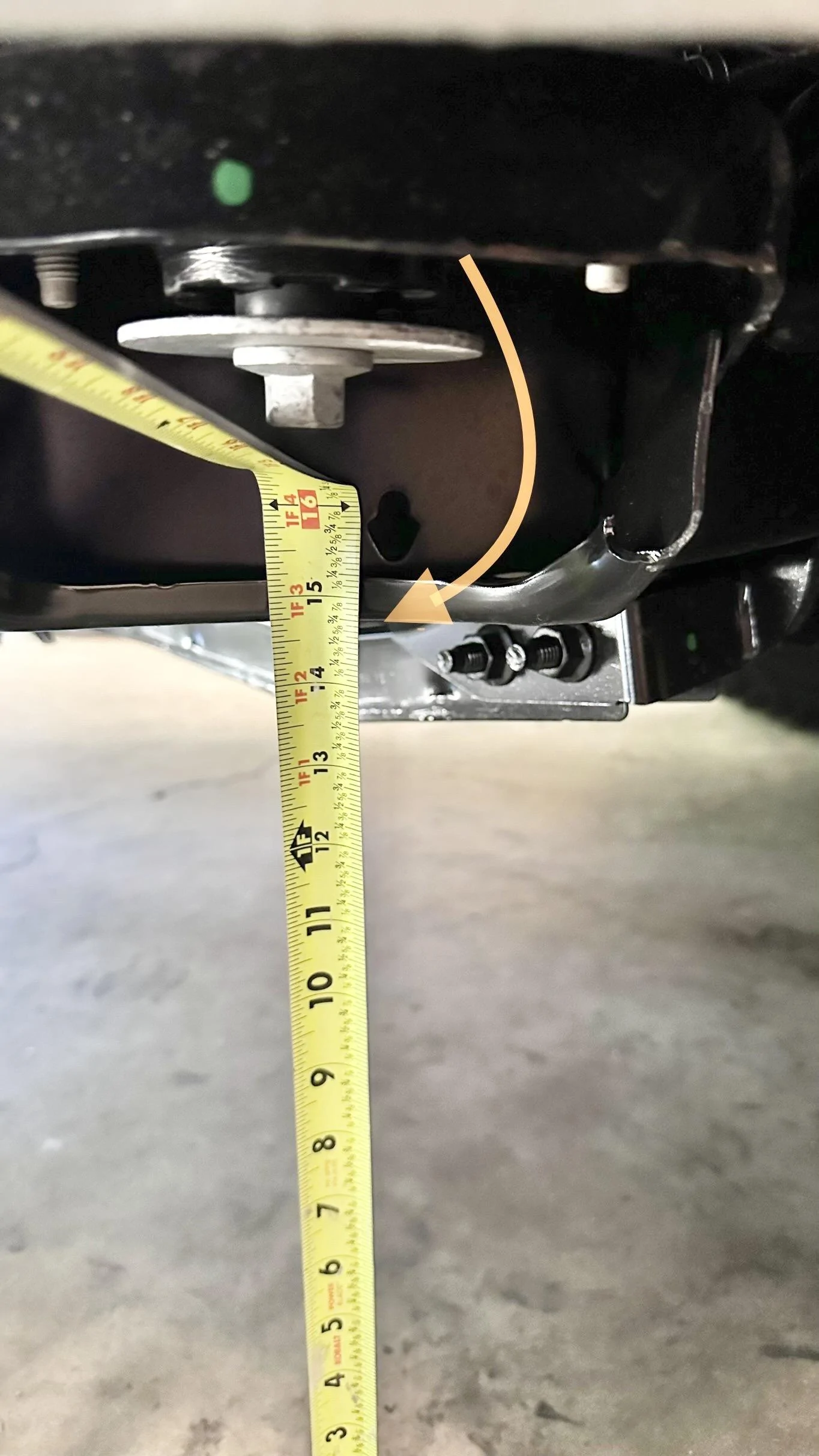

Photo on Stock SAS bronco behind the front wheel - note the cutout arrow on where to place your jack or stand
