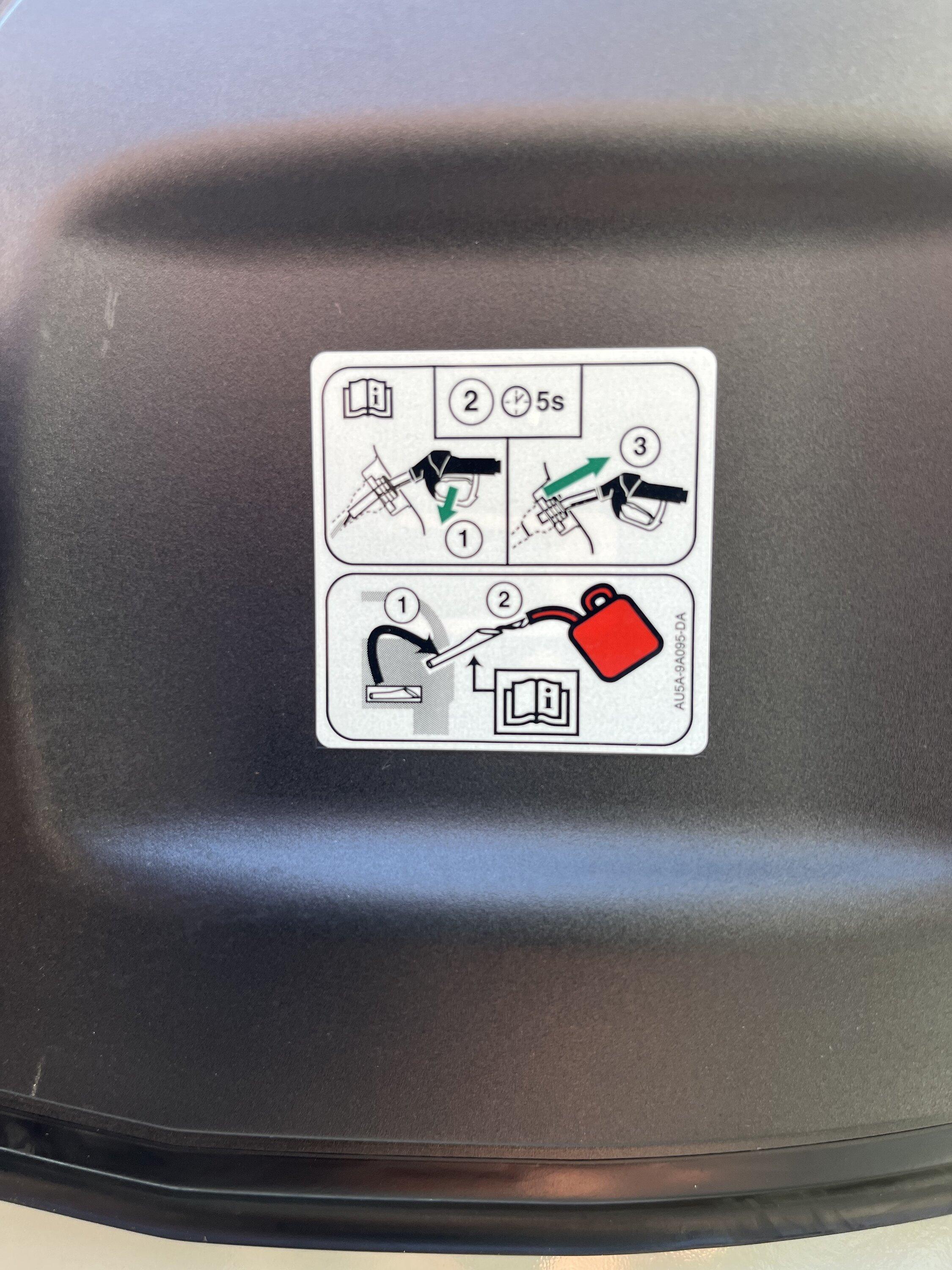

So I have 2 jerry cans for fuel but I’m yet to figure out how to actually get the fuel into the bronco. The jerry can fuel attachment doesn’t work, purchased a funnel from Amazon and that also didn’t work. What am I missing? I’m sure it’s something stupid, but here I am. Thank you in advance

Actually, it’s a great question that most people probably couldn’t answer. Unfortunately, how to fill from a ”jerry can” is depicted on the inside of the fuel filling compartment door.
Ford Bronco Jerry can fuel storage B9B9CE7D-AF2B-40ED-94A3-EAB0164642E6
My interpretation of this pictogram is “Read the instruction manual”!
My fuel door doesn’t have this sticker, so thank you

you have to shove the oem funnel thats by the jack in the rear floor cubby into the fuel hole first. That opens the flap. Then you stick the can in that. Just a short narrow black funnel.
