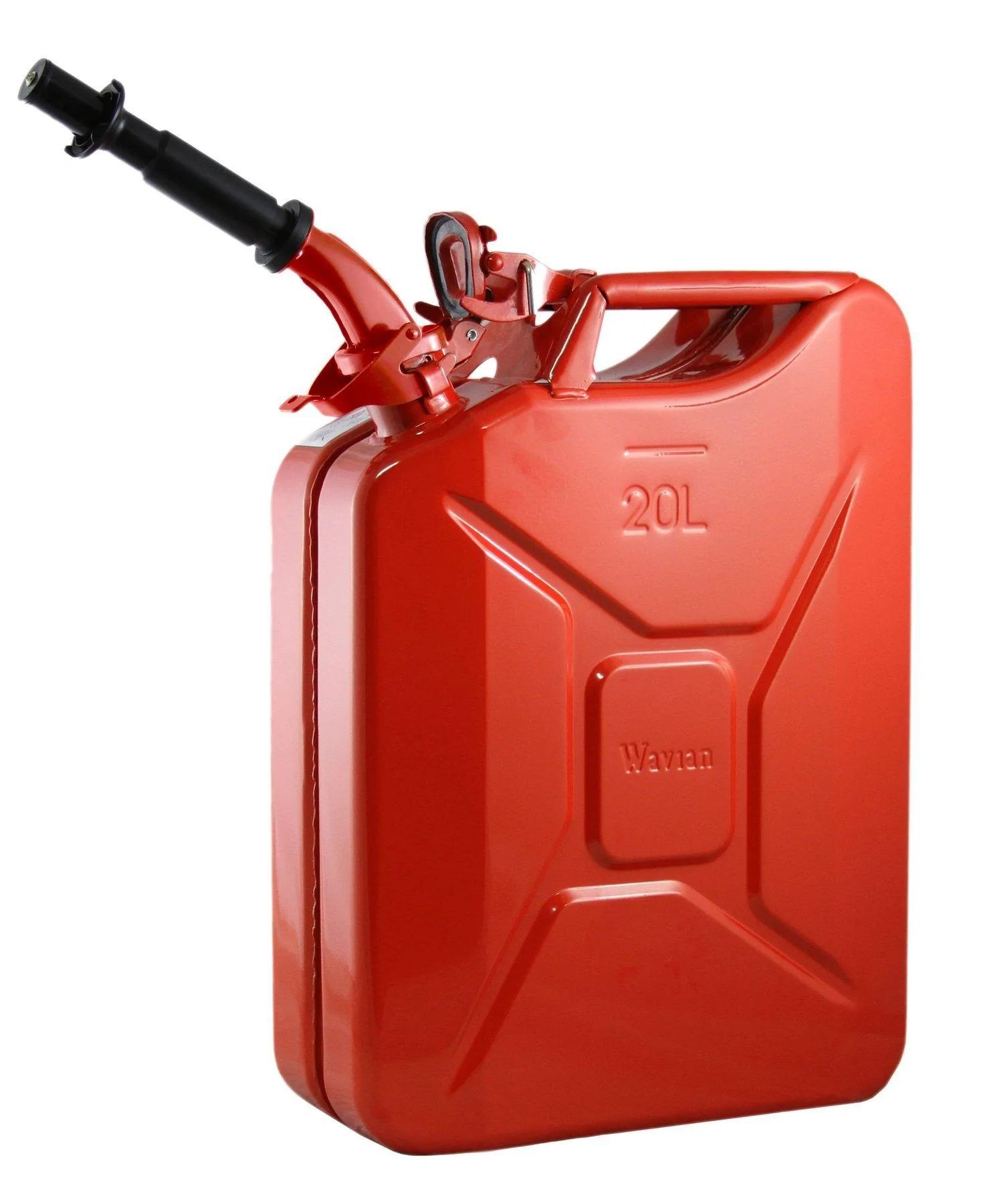

I have always run the Wavian 20L Jerry Cans which, yes, you do need to vent every few days in temp/altitude, but it's a 20 second affair so not even the wife will mind.

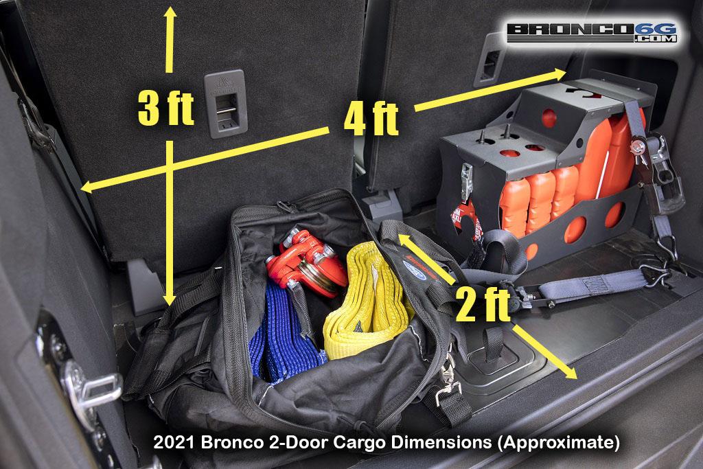

As for storage, i'll fabricate a simple fuel containment box out of aluminum sheet to fit between the two floor tie-downs to hold two Wavian Jerry cans longitudinally that allows me to safely stack gear on top of the fuel box, thus not losing that space for storage inside.
The closest thing I could find to what i'm going to fabricate is the silly oil and lube holder that was used for the overland showcase model. Except i'll have floor provisions for the D-ring to flip up through the floor of the Jerry holder, and slots in the side so a ratchet strap will go across the top of the Jerry's, between the handle and body, snugly keeping them strapped down.
With the floor mounted D-rings going over the base of the fuel box, I can also use a spider net or bungees to secure objects over the whole of the cargo area. If those D-rings prove to not be sturdy enough, then i'll simply make the fuel box plate sturdier and affix additional tie-downs there and weld a few nuts under the cargo tray for bolts to hold everything down.
This stuff can be done yourself with minimal cost (assuming you already have the tooling and space to work).
Ford Bronco External fuel / jerry can mounting? 2-door-cargo-area-trunk-size-volume-dimensions-
Wavian Jerry Cans, if you aren't familiar with them, they are pretty damn awesome.
Ford Bronco External fuel / jerry can mounting? Wavian Jerry Can
