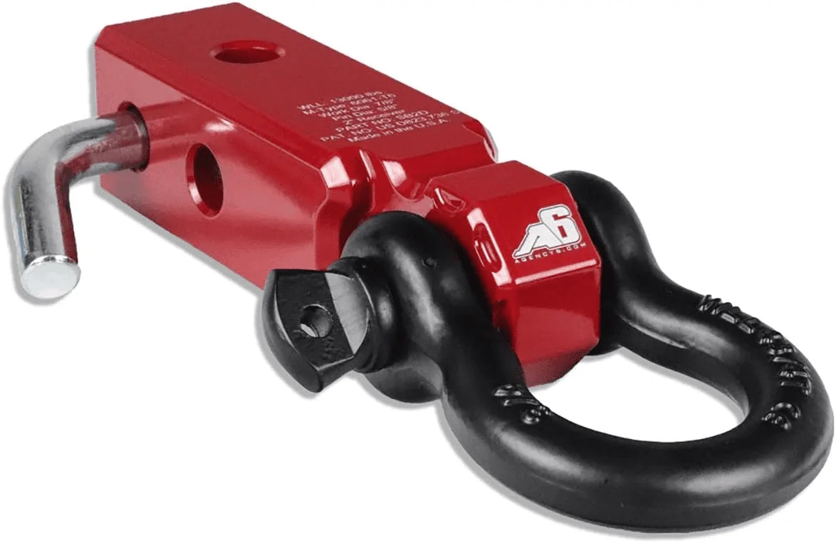

Looks great installed. Installed lock for this and then about to install lock for Red shackle. Those seem to walk away allot.

I don't understand why people leave removable shackles on when not in use. If you stowe it, it won't "walk away."
Cool factor?...or, in my case - laziness.
Mine are beat-up bare steel and not that attractive anyway...
one less step to do when you need it? Also not that it takes up much space but if you leave it installed you don’t have to worry about storing it. To each their own.

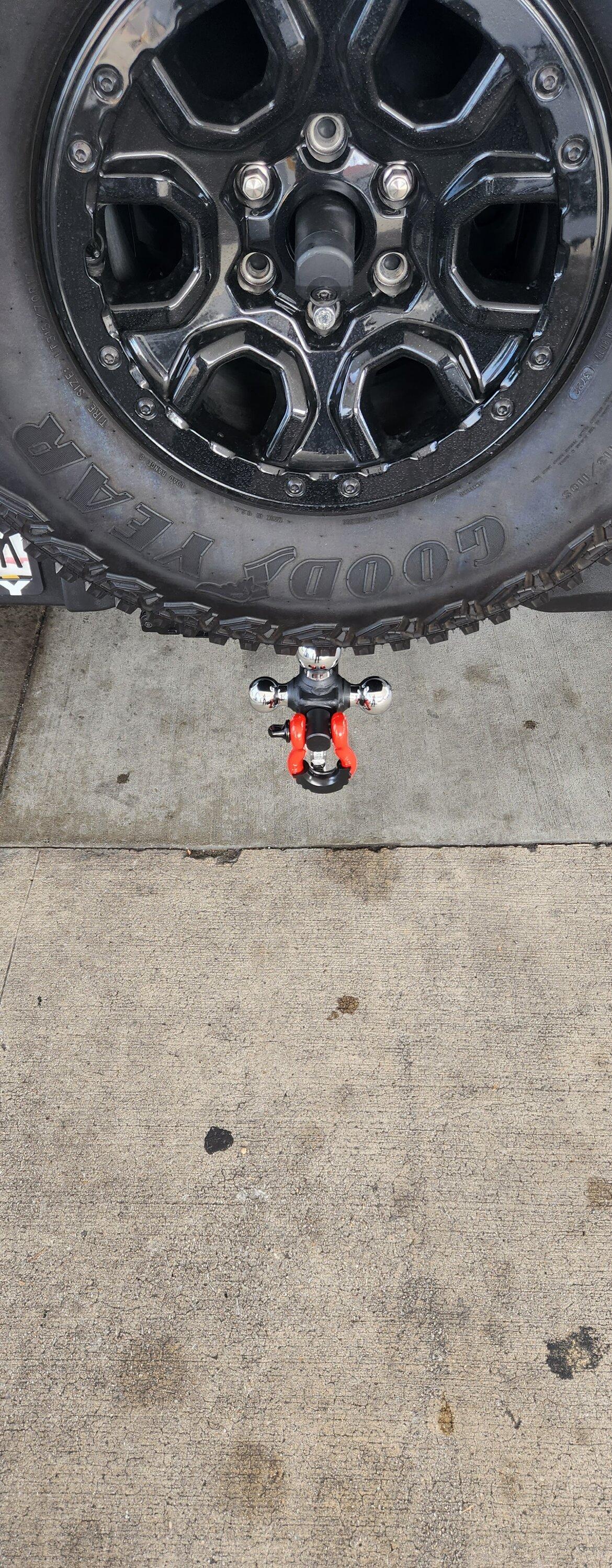

My hitch with a 3 1/2" drop just clears, how is that 3 ball mount with zero drop usable?

Just say no to hitch recovery points. They aren't safe and you can kill someone.
Are you referring to ball hitch recovery point or any hitch recovery point? Wouldn't these be safer with the proper care?
The tow hitch on any vehicle is designed for towing and attaches to a lateral frame member. The forces incurred in towing is different than that of a snatch to overcome a vehicle stuck (mud having the greatest suction force to overcome). You want the force used in such a recovery to be applied to a recovery point that is a part of the longitudinal frame member.
It was just a week ago that a recovery went wrong at the Ol' Florida offroad park. Landcruiser was stuck and recovery was attempted from the tow hitch. In a split second, the entire hitch carrier was torn off the LC and sling-shot into the rear gate of the recovery vehicle. People standing around in the kill zone unknowing the danger that they exposed themselves and their loved one too. In that split second, the carrier could have easily killed them.

Makes sense. Terrifying. So many mistakes happened there. They are very lucky.
The video was quite dramatic. No way to post it here as it was posted in a private group. Not much to see other than hearing the rev of the recovery engine and the loud cavernous smash of the carrier hitting the gate. That carrier would have severed limbs of those standing around as quick as it happened.
People need to understand that the phrase "kill zone" is not being melodramatic. In this incident, it very well could have been deadly.
But to get back to the point of hitch recovery points, just use the intended recovery point a few inches to the left or right. If you don't have a hitch recovery point, you'll never be tempted to use it.
