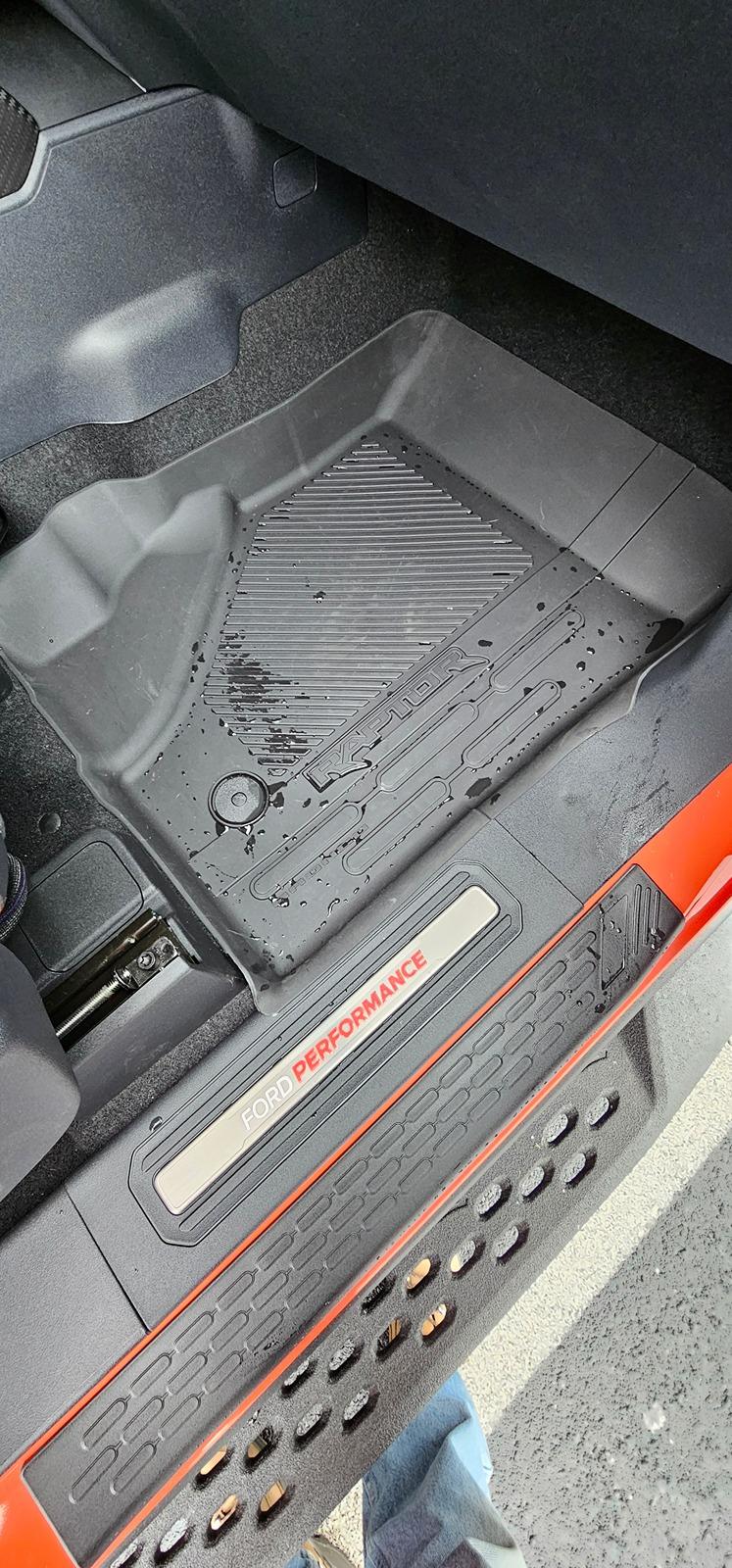

Sorry to hear. I just bought a Braptor 2 weeks ago. First rains yesterday and guess what? Leak on the right side front passenger...Gonna call dealership tomorrow as I am not happy. Had a recall on the rear quarter windows as mine was built between the recall dates. 3rd party installer scrat
Ford Bronco Leaking roof 20240505_160104
ches the graphic on the left side and the glaze job on the left looks like a 3 year old did it..Then when I was looking with a flashlight for where the leak was coming from I noticed wires just hanging on the passenger side. Not sure what they go too.
