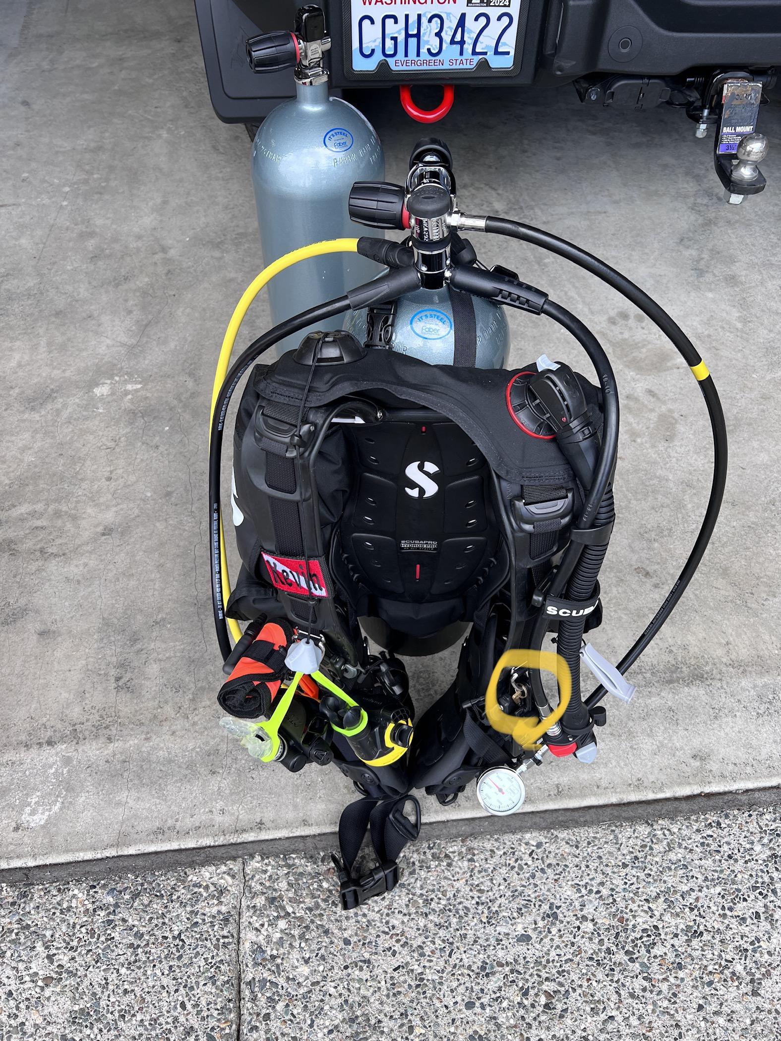

Locking my FOB inside the Bronco.
There are lots of reasons you might want to lock a FOB inside. Hiking, biking or whatever.
In my case I like to Scuba Diving. A lot of divers just hide their key/FOB outside the car or area somewhere.
I have done it a bit differently.

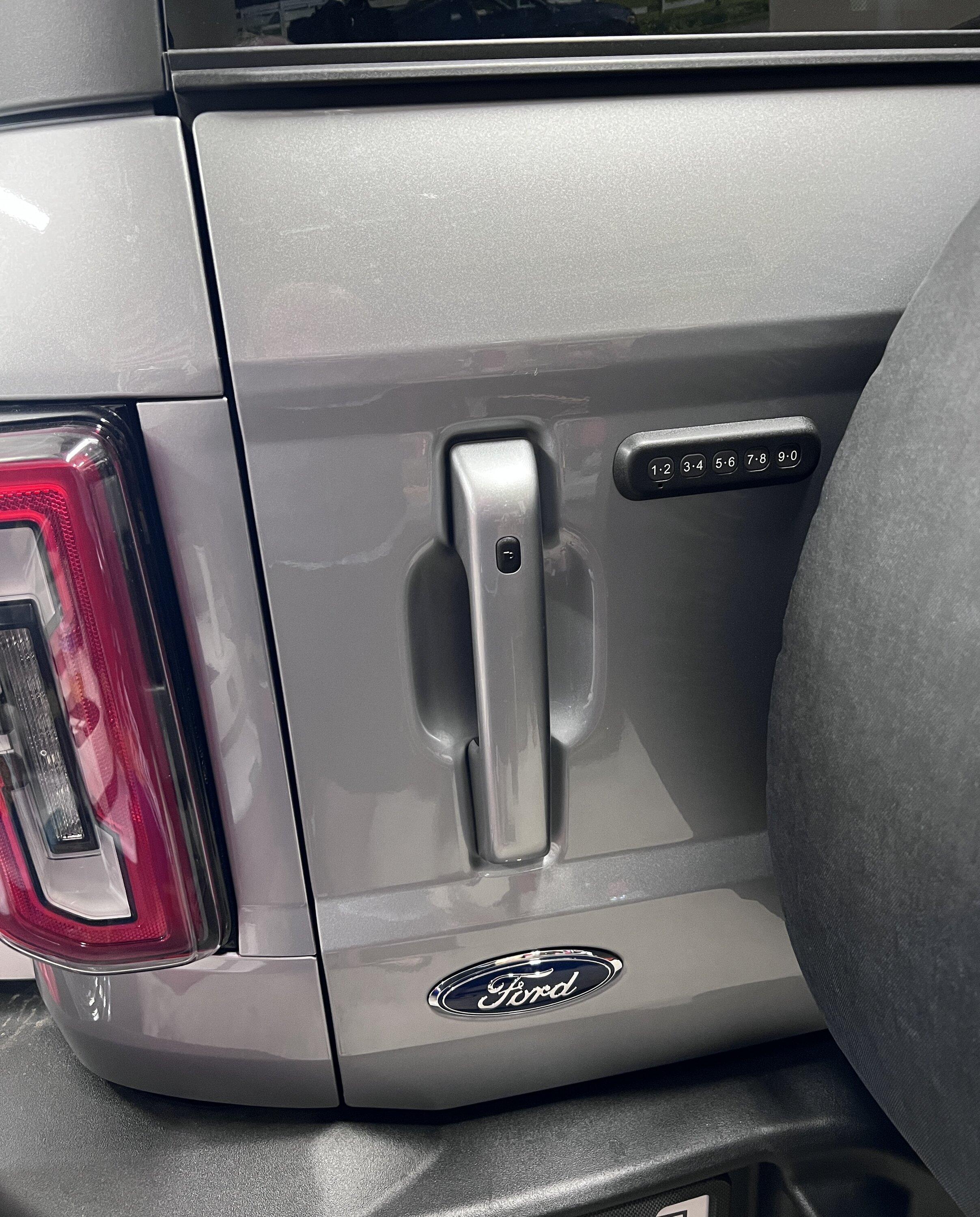

I started by getting a Keyless Entry Pad. On the newer Fords you can’t just program it like another FOB. You have to use FDRS, Ford’s software (haven’t figured out how to do with Forscan yet). Luckily I have access to that. Took 10 minutes to activate and the set the code I wanted. Most dealerships will do it for their minimum charge.

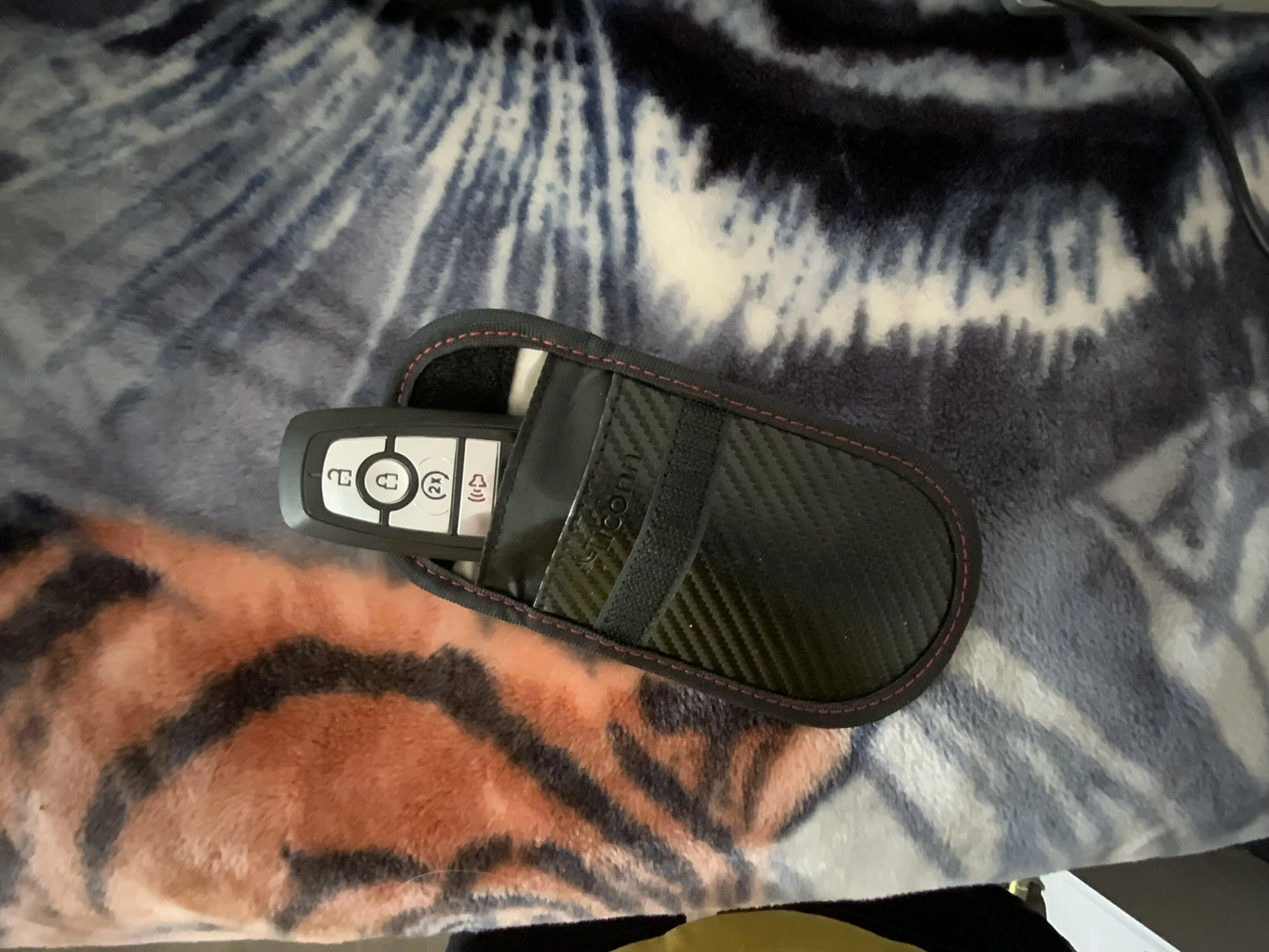

I use a faraday bag (puchased two pack on Amazon) and put inside the vehicle. Another person on this forum showed a great place in the rear tailgate door to hide it.

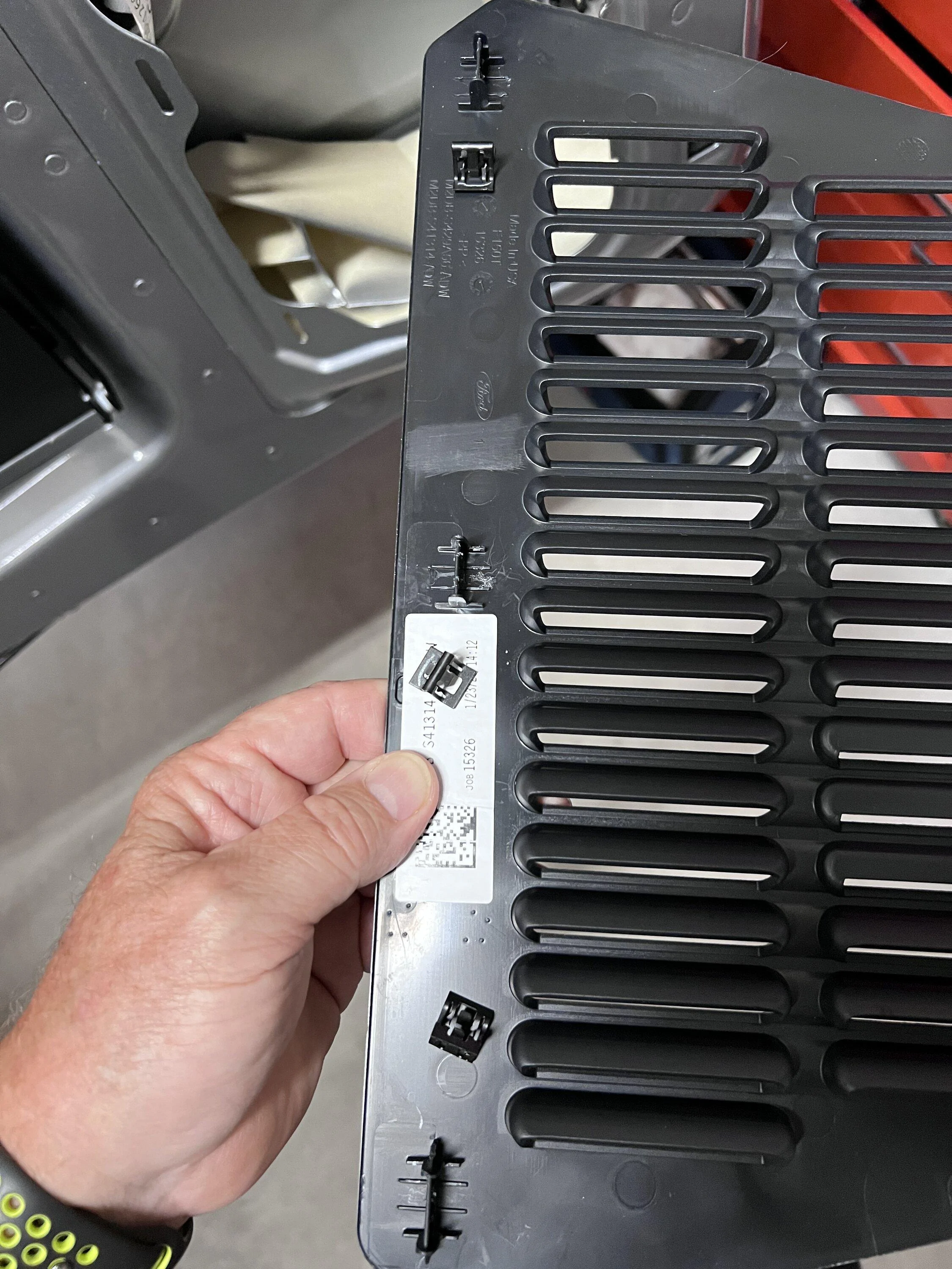

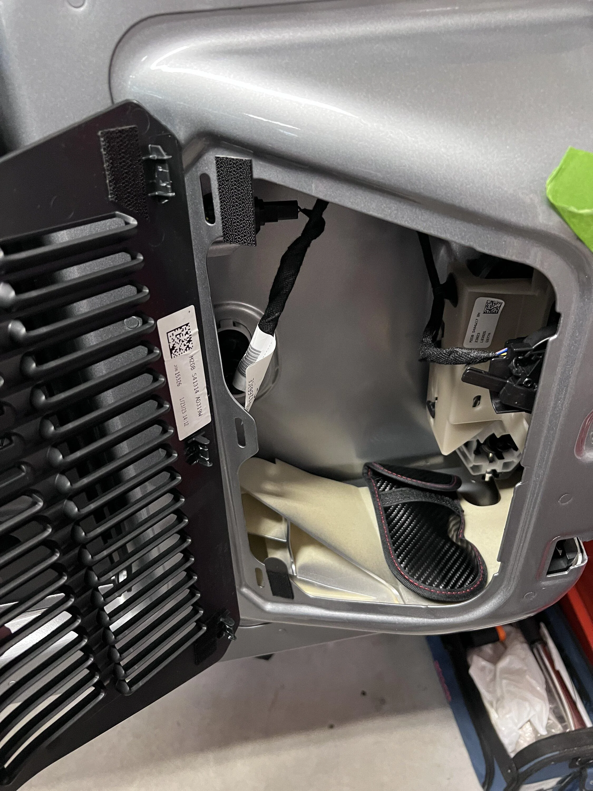

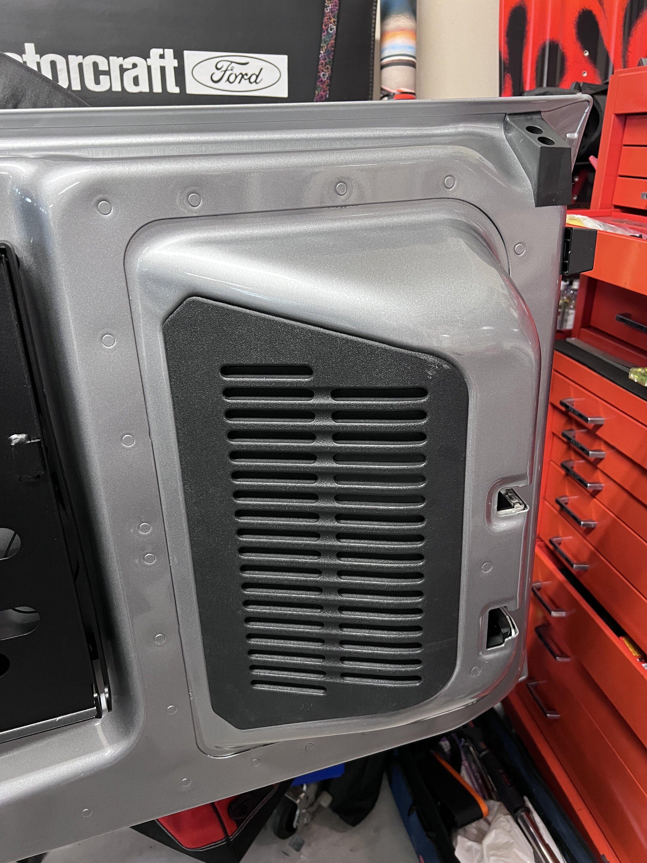

I took the inside cover off the rear gate/door (take off from the center so you don’t break the tabs) and removed the clips. I used 3M velcro and it comes/pulls off so nice.
I put the faraday bag in there.
The reason I put the keyless pad on the back is some places I dive I still have all my dive stuff on. You can put it wherever. Some folks like the area in the gas filler compartment. I also had a couple key blades made and have one on my BCD and one in my wallet.
Here are some photos.

Yes. That’s why I got the bag. I used to use aluminum foil but found with the Bronco I could put my hand on the door and it would unlock unless I was four layers thick. Bag works great.
