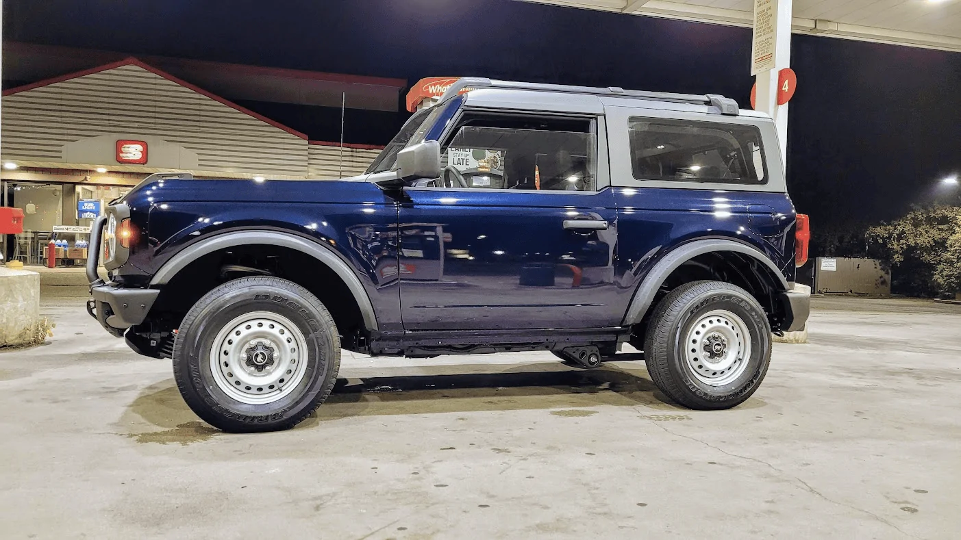

315/70/17 on 17x8.5 0 offset wheels on stock 2dr Big Bend. Removed crash bars. No lift. No spacers / level. No rub or scrub even under flex.

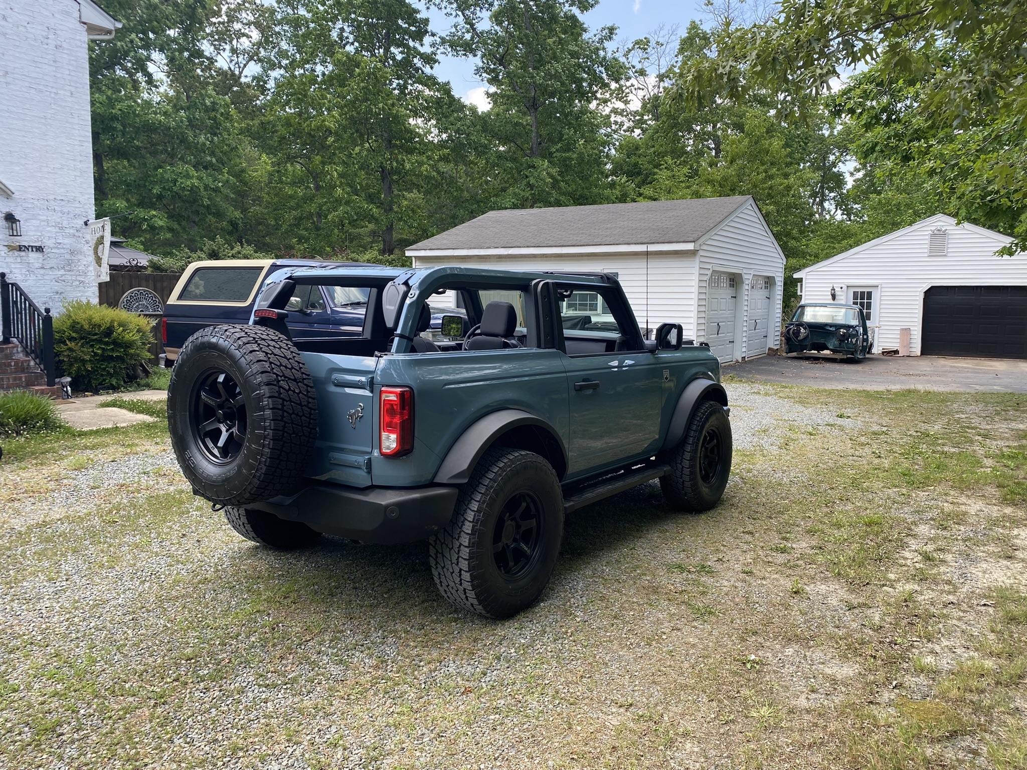

2dr BB, no lift. Removed crash bars. 17x8.5 0 offset and 315/70/17. No rub, even under flex.
Ford Bronco Looking for recommendations on upsizing tires IMG_4133
I did add SAS flares. The poke with base flares wasn't bad at all - I live on a gravel / dirt drive and didn't care to see mud splattered on the side of the Bronco constantly. If I want it muddy, I'll get it MUDDY.
Duffy705
Jun 20, 2022
Sudbury, Ontario, Canada
2022 Bronco Big Bend
Do you have photos of what it looked like without the squatch fenders? They're super expensive here so I won't have the fenders for a bit. The 315s or ideally 35s will be going on my BigBend
