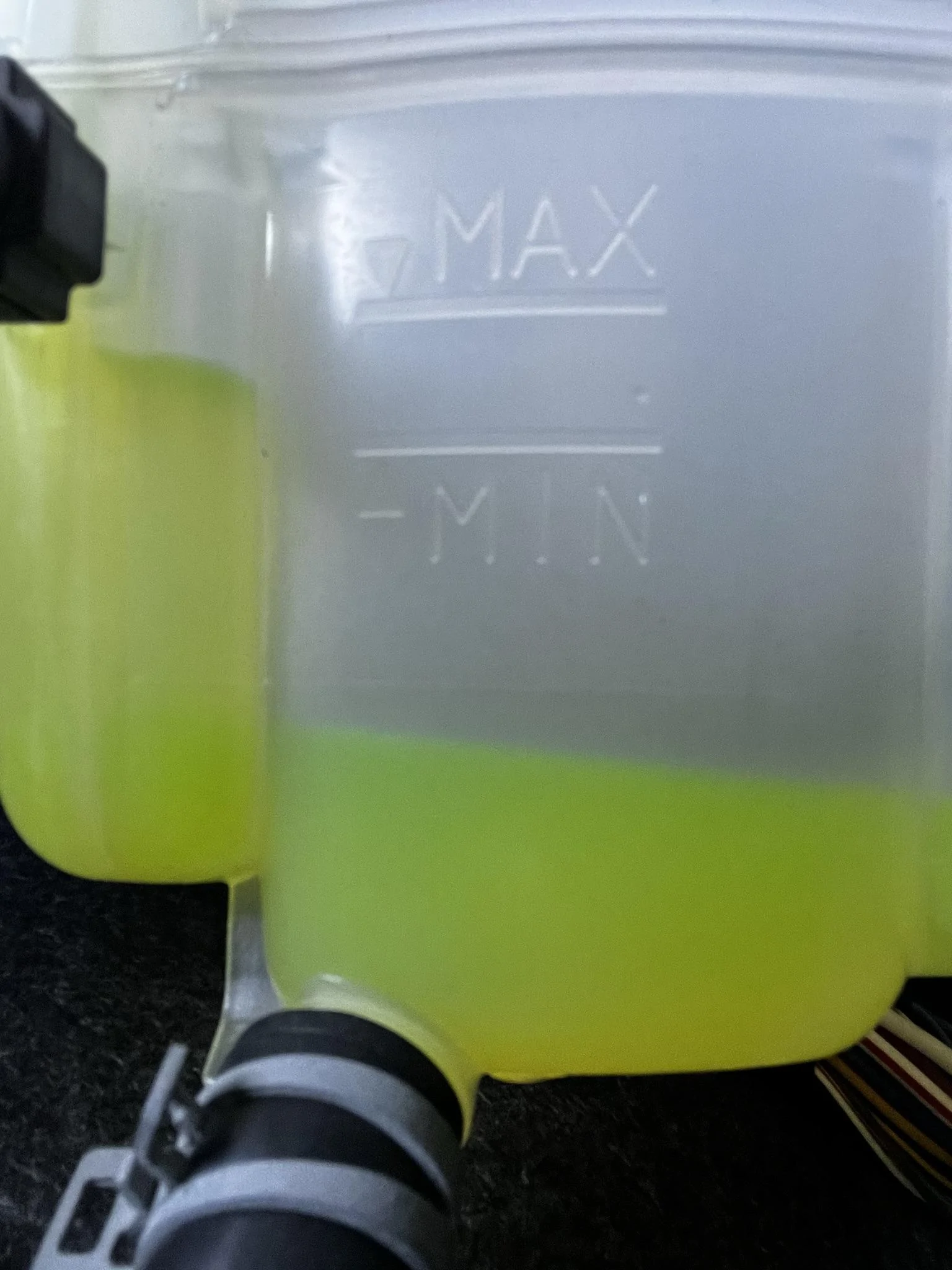

I checked my levels today and noticed that the reserve radiator level was below min. Its never been much higher than minimum, but always above.
Its been sitting for about 10 days and just wanted to get yalls opinion on if i should top it off.
The level and pic was taken without the vehicle being started.
Thanks.

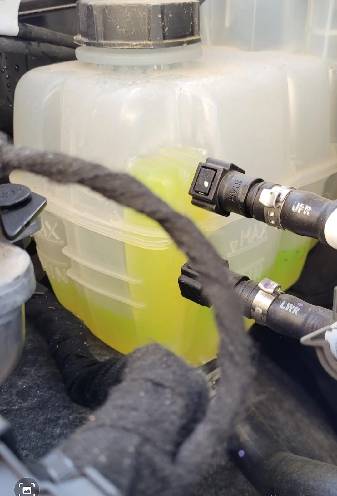

From what I can see, I think you'll be fine without topping it off but keep an eye on it. The coolant level does need to be checked when the vehicle is cold. Now, if your level was like mine a few days ago, then you would definitely need to add coolant. Lol

I had same issue I have an appointment to get looked at there are other threads of people having slow leaks with no noticeable puddles or smell

Been tracking my levels also.
I've also had to add about 2-3 oz. of fluid every couple thousand miles (topped off 5 oz. total so far). Currently at 9500 miles and I'm between low and high when the engine is fully warmed up. Might need to add a few more oz again, bringing my total "topped off amount" over the vehicle's lifetime to 8oz.

Honestly, I've been in the car business for 25 years. 14 of which with Ford dealers in fixed ops management. I can tell you(with certainty) the majority of vehicle come off the truck with low fluid levels, (not just washer fluid) and aren't topped off properly at time of PDI. I would top it off, visually inspect for leakage, maybe mark a reference level on the degas bottle and watch it.
