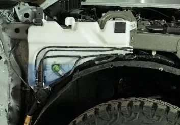

When I took delivery I drained the tank and it took all of a gallon bottle to reclaim and Iā€™m sure I missed a little. Now thereā€™s some caveats as well to how much youā€™re using at any given time too. If you have the front camera youā€™re going to be spraying that whenever you activate the washer fluid as well. I do have the front camera but Iā€™ll be honest I am very sparing with my fluid usage since it doesnā€™t need to be slathered on to be effective enough for my tastes. My windshield stays treated with rain-X so cleanup is always very easy.
Bonus: here is a visual of what the tank looks like. Also, purely cosmetic but I would recommend wiping out the ā€œbowlā€ where you pour fluid into when youā€™re done, it tends to crustify and stain after time.
