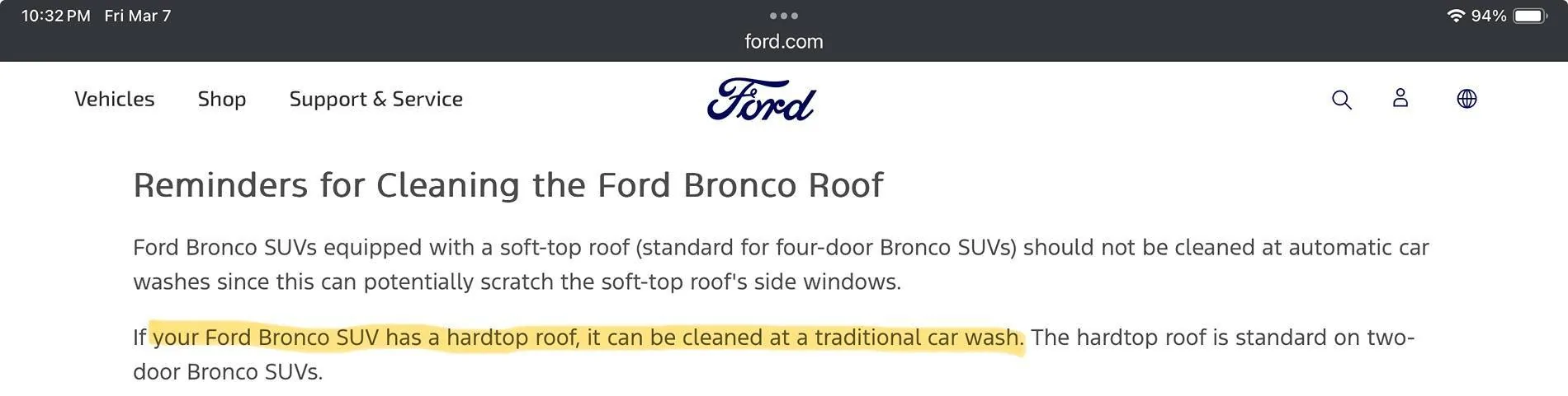

Just don't use high pressure washes/automated car washes on your MIC top. There are stickers on them from the factory saying not to. My dealer removed them but thankfully I like to read my owner's manuals so I found out about it.
This is from Ford’s website. Not that you can’t find errors in it’s own literature…
If your Ford Bronco SUV has a hardtop roof, it can be cleaned at a traditional car wash. The hardtop roof is standard on two-door Bronco SUVs.
They're probably speaking in relation to the soft top, which is a big softie and gets ticklish at traditional car washes. (I've seen them rip clean off from the overhead brush in TikTok posts lol)
