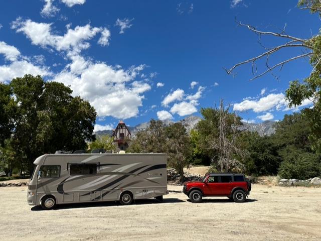

4dr OuterBanks w/Sasquatch Package is our third tow vehicle behind our 28' ACE with Ford Tritan V10 engine. While power was not an issue, stability was a real problem as when we got to 60-65mph the RV starting swaying, making it difficult to keep within the lane. Slowing down to 50-55mph took care of most of the problem but it was still a lot more concentration type driving than without the Bronco behind.
Consulted with a friend who is an offroader/fabricator/mechanic and his first blush was the aggressive 35" tires that come on the Sasquatch package, believing they want to grab everything on the road and hence, the "tail is wagging the dog".

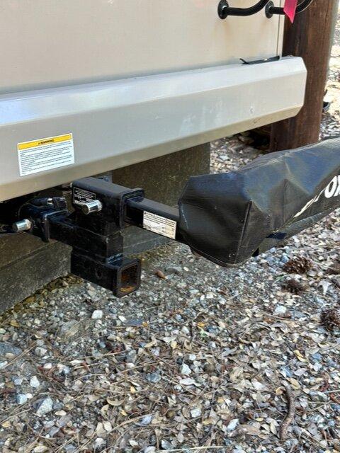

Another thought is the combination of the standard Blue Ox tow bar now has a 3" higher adapter so the RV and the Bronco are on a level towing angle, creating a bit more play at the two connections vs. just one connection with a typical hookup.
Looking for some suggestions, lacking not towing the Bronco, as to how to correct this...

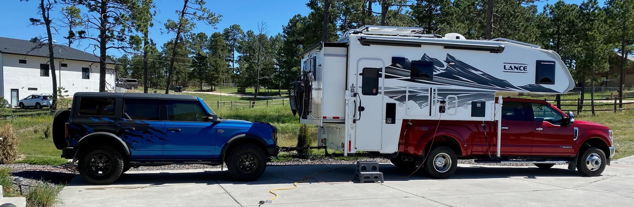

I experience the sway issues mentioned but really only during a sudden direction changes on curvy mountain roads. My setup isn't recommended by any manufacturer. I'm pretty sure the weight ratio between the dually and bronco coupled with the distance from the rear axle to the hitch is the main issue. Most rigs flat towing out there are those 50k+lb 45' class A or C's so the Bronco won't push those around. The track bar above seems sketchy/snake oil to me - I'd question anything that is bolting up to a differential - asking for expensive issues. I could be wrong though. I would suggest a better sway bar. It won't fix tail wagging the dog but would probably help with stability a bit. I'd suggest looking at Hellwig to see if they have "bigwig" one for your chassis. Maybe fill the water tank in the motorhome too? Those yellow speed signs on curves are my friend :)

Thanks for the solid replies...
Our last toad was a Jeep Cherokee Trailhawk that has a GVWR of about 6000lbs and with the exception of a couple of "death wobbles" at low speed which got corrected with a updated wiring harness we never had these sway problems.
I am keying on on both the hitch movement/tightener and maybe upgrading our already upgraded sway bars to something more robust.
Any thoughts on the greater distance between RV and Tow that occurred when I added the 3" height adapter? The total distance grew 9" and could be reduced by about 6" by having some new pin holes created.

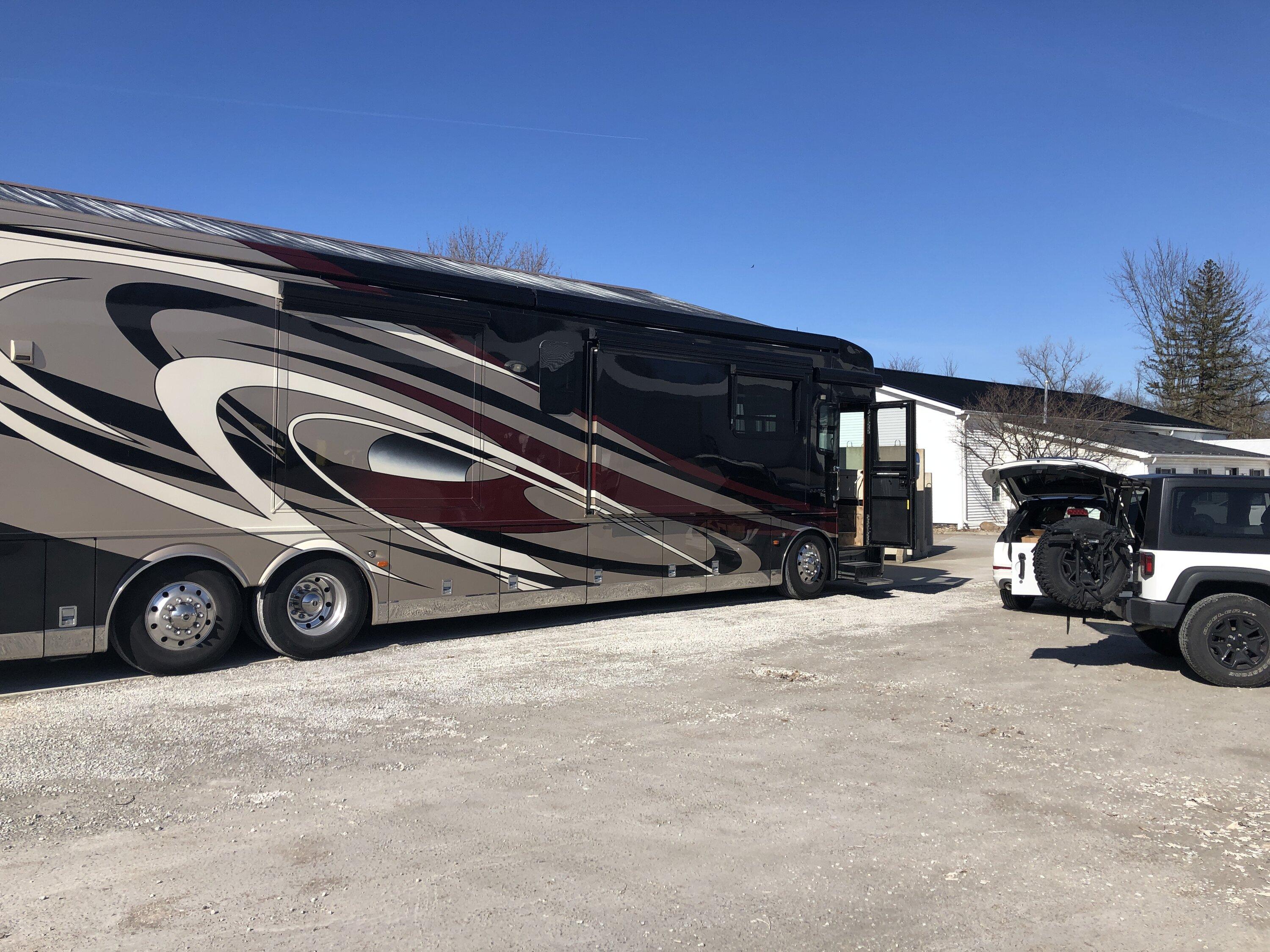

Ford Bronco Motorhome sway when flat towing Bronco 42AA6C7D-B4DA-429A-8972-8C52337834CB
I will be towing my OBX behind this. I am currently waiting for delivery. I will be using using my Ready Brute Elite with the ready brake too. I order to Curt LED wiring for 4 wheel tow. My vehicle just switched to built so hopefully I will get it this week, fingers crossed. I never experienced any wag like you described with my 2 door wrangler.
Bsenecal
Aug 16, 2021
125
115
Vermont
'19 Ranger crew cab, '17 Fusion sport, '68 Mustang
Nice coach, I can see why you don’t have any “tail wag” with a large diesel pusher like that.
