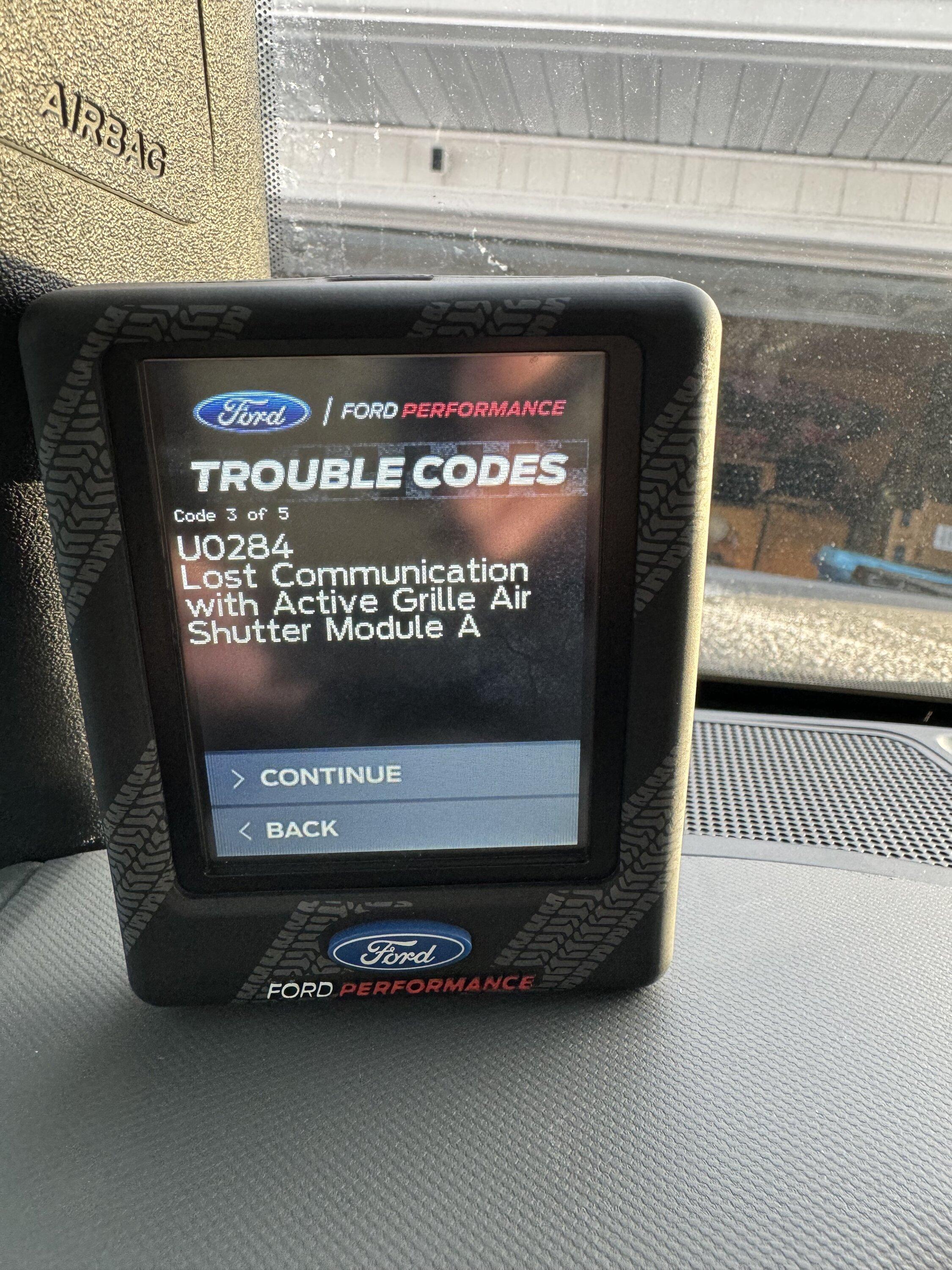

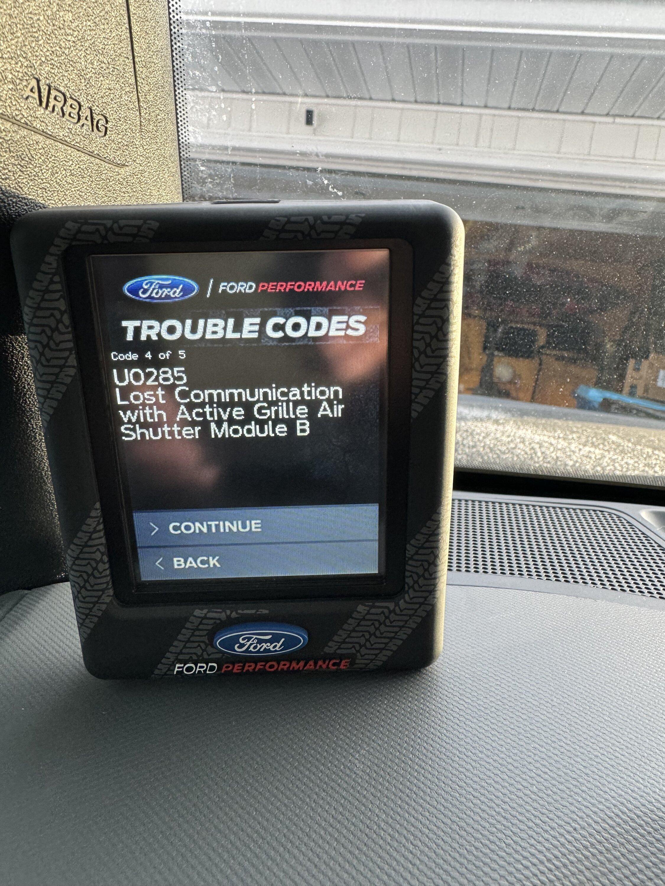

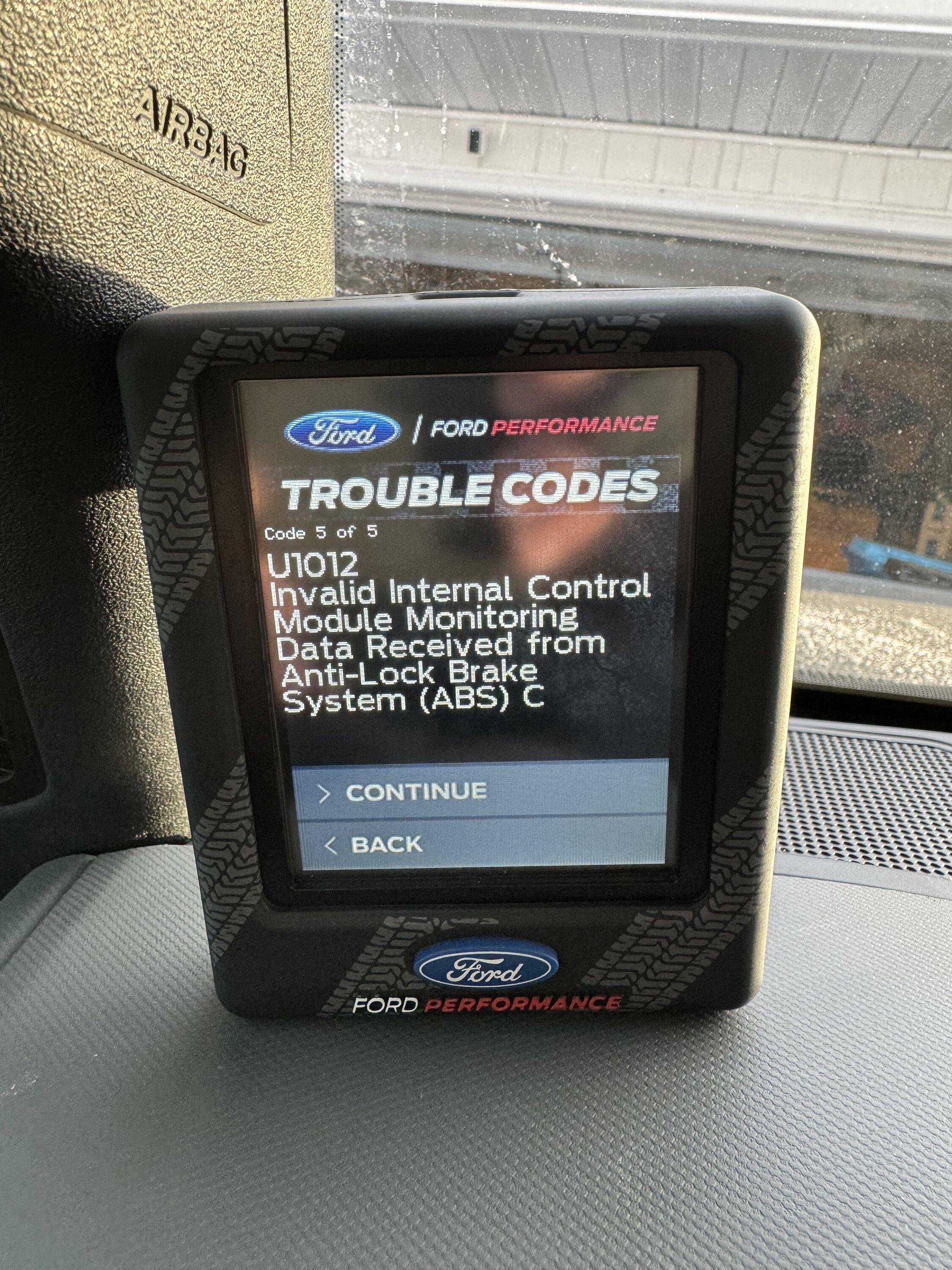

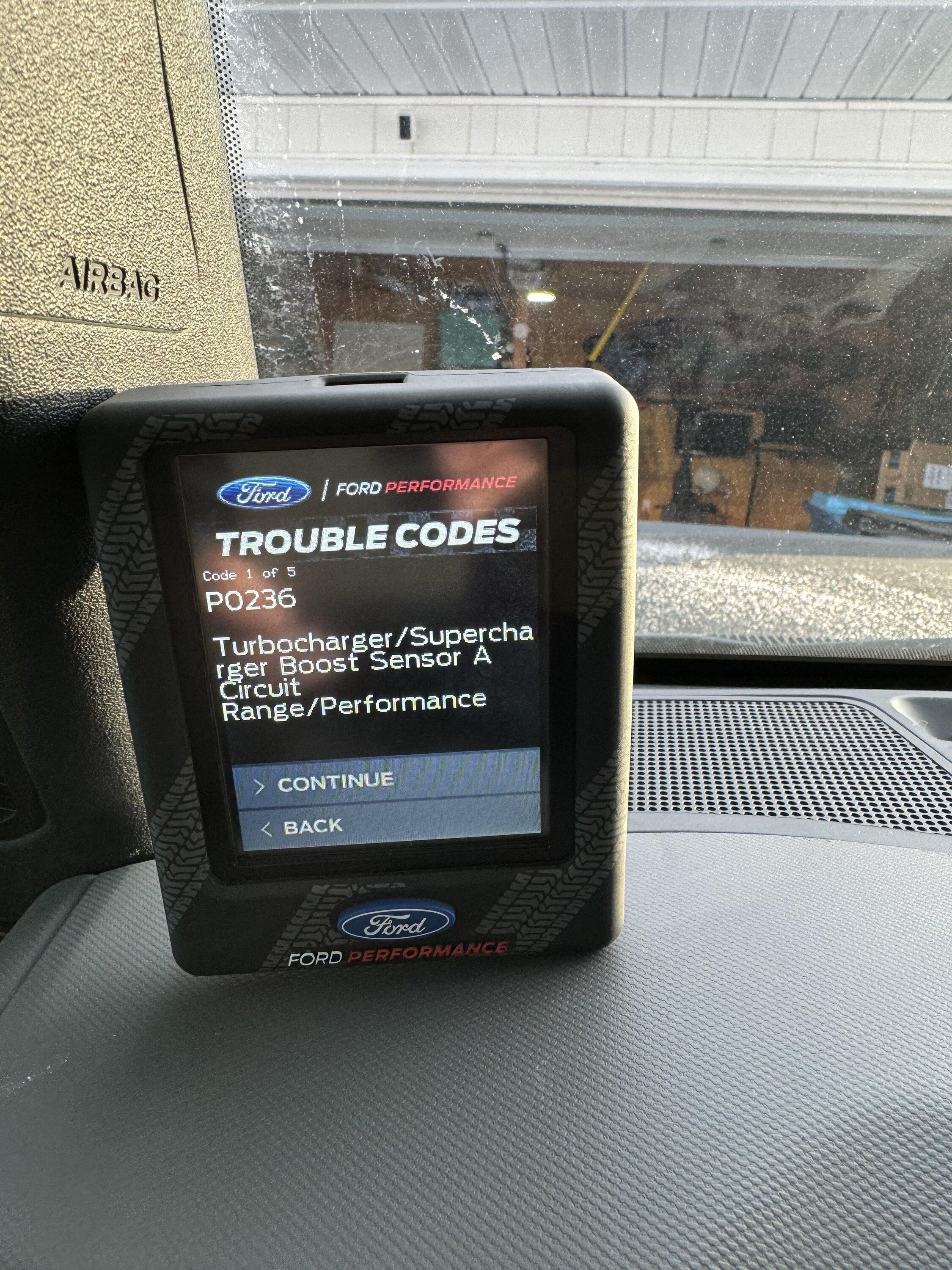

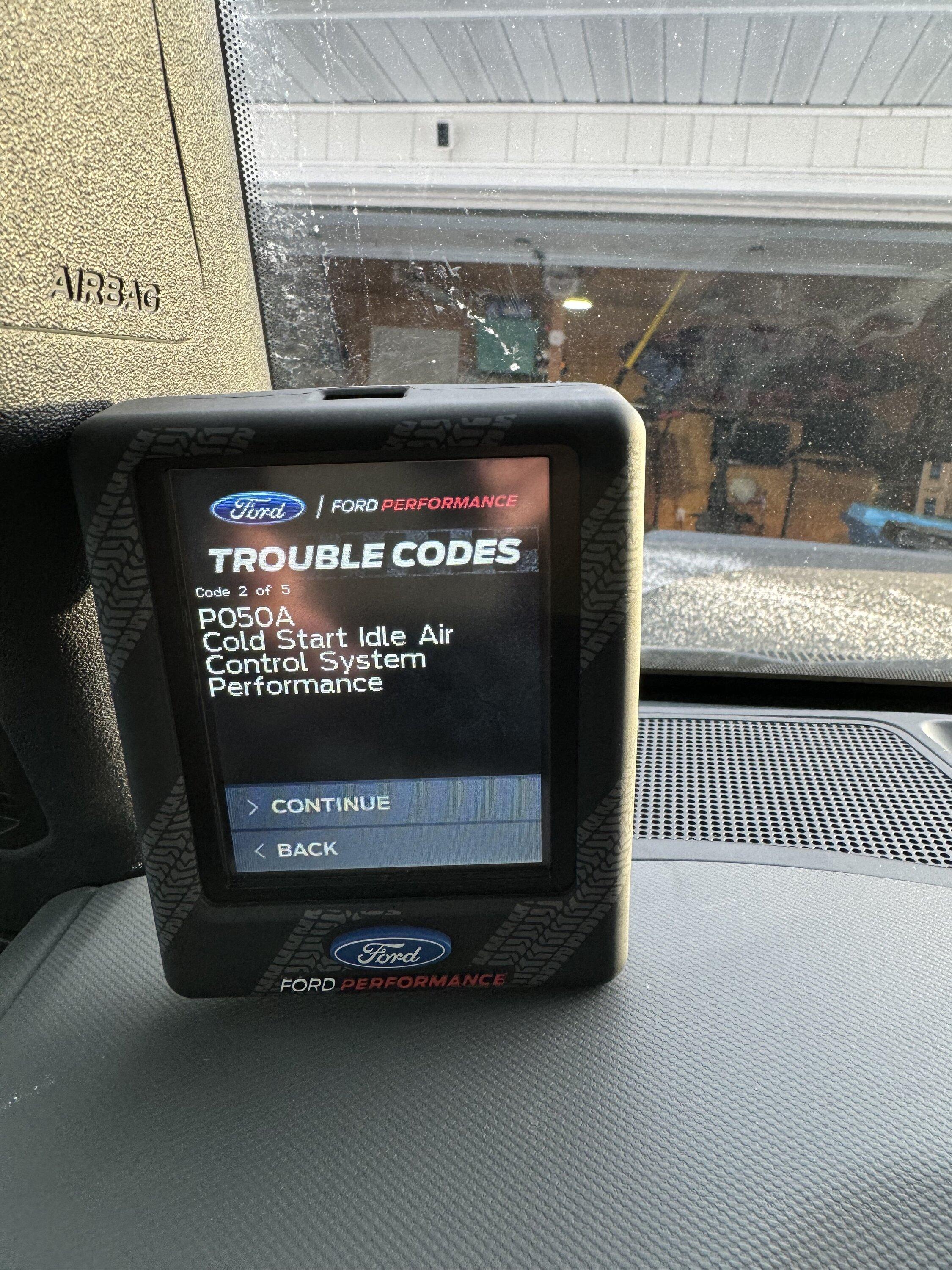

Remote started my 21 BD this morning. No issues with start up, but when I got in and hit the engine start button, a bunch of notifications came up. Service engine soon, Pre collision assist not available, and driver mode not available which is the ability to change G.O.A.T Modes. I have a Ford performance tune so I hooked up the Pro Cal and read the following trouble codes.
There are 5:
P0236-Turbocharger Boost sensor A Circuit Range/ Performance
P050A -Cold Start Idle Air Control System Performance
U0284- Lost Communication with Active Grille Air Shutter Module A
U0285- Lost Communication with Active Grille Air Shutter Module B
U1012- Invalid Internal Control Module Monitoring Data Received from Anti-Lock Brake System (ABS) C
I never had these codes before, and I drove it 5 hours yesterday and it was just fine. I am in Illinois, and the temps last night were -12. When I started it this morning it was -10.
I drove it down the street about a mile and it runs like garbage. Loss of power, and exhaust sputtering.
Just wondering if anyone else has had this happen to them in extreme cold over the last few days. I don't know if it will be fine once it warms up above freezing, or this is a dealer visit.

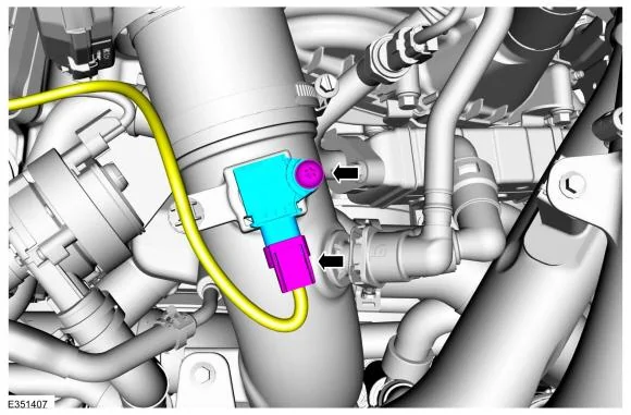

Pop your hood and take a look at the sensor right in front of the throttle body and any wiring in the surrounding area. Maybe there is something obvious. If not, I’d recommend just bringing it to your dealer so they can properly diagnose the issue.
Ford Bronco Multiple Trouble codes- Sub Freezing temps 2021 BD 2.7 IMG_2662
akturbo
Oct 15, 2020
637
1,044
Seattle Eastside
'21 Bronco, 3500HD Chevy, Rav4Prime, Turbo Skidoo
What sensor is that? MAF?

I'm going to take it to a heated garage this morning and let it sit for a few hours and see if starting up later today will change anything. I'll check out the sensor on the throttle body as well. Thanks for the input. I'll post later today on what I find. I appreciate the help all.

Heated garage did nothing. I checked the sensor and surrounding area... Nothing obvious. Made an appointment with Ford, but of course, the soonest available is 2 weeks out. This sucks!

So yesterday I took the turbo boost sensor off and cleaned it. It didn't look like there was any buildup on it, but I tried anyway. After cleaning it, and starting it up, boom, it was fixed, for a few test drives anyway.
Drove around for about 5 miles.Ran great. Parked it. Had to run to the store a few hours later... fine. The third time later in the day, the codes came back and it ran like garbage again. I think it is the sensor, and it is possibly going bad? If that's a thing. I ordered a new one to see if it completely fixes it. The only code showing up now is the P0236 (turbo boost sensor A circuit)

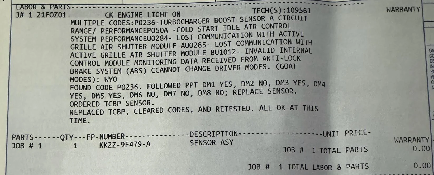

*** Update***
After 12 days in the dealership, the diagnosis and fix was replacing the turboboost sensor (MAF) as we all thought. Literally a 2 min. fix, which I was going to buy and do myself, but the sensor was $120, and I still would have waited 7 days to get it so with it covered under warranty I just let the dealership keep it till they fixed it. I’m just glad it was covered, and she is running as good as ever now.
Just wanted to update this thread in case someone else runs into this issue.
Thank you all for the input on this.
