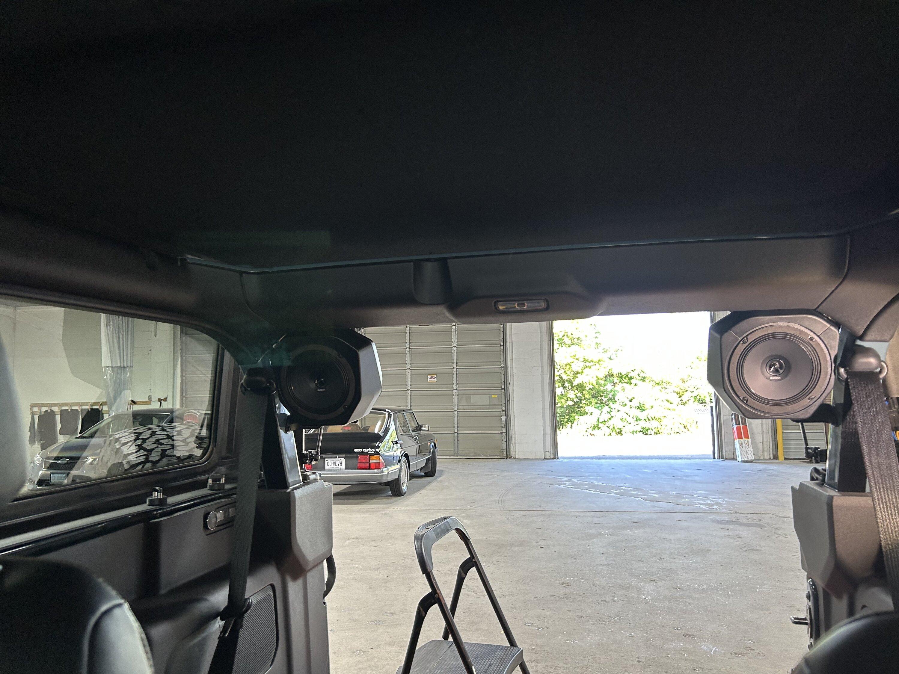

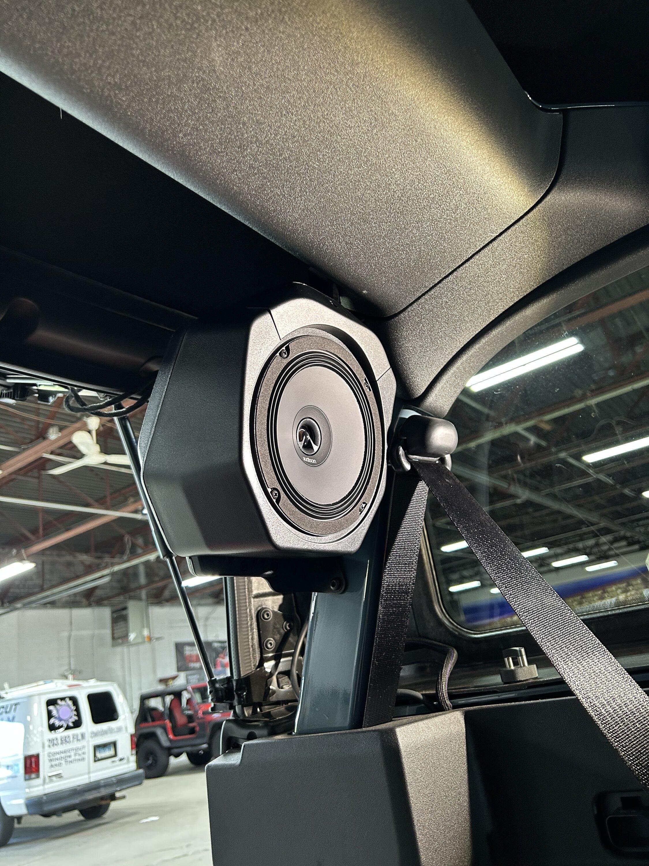

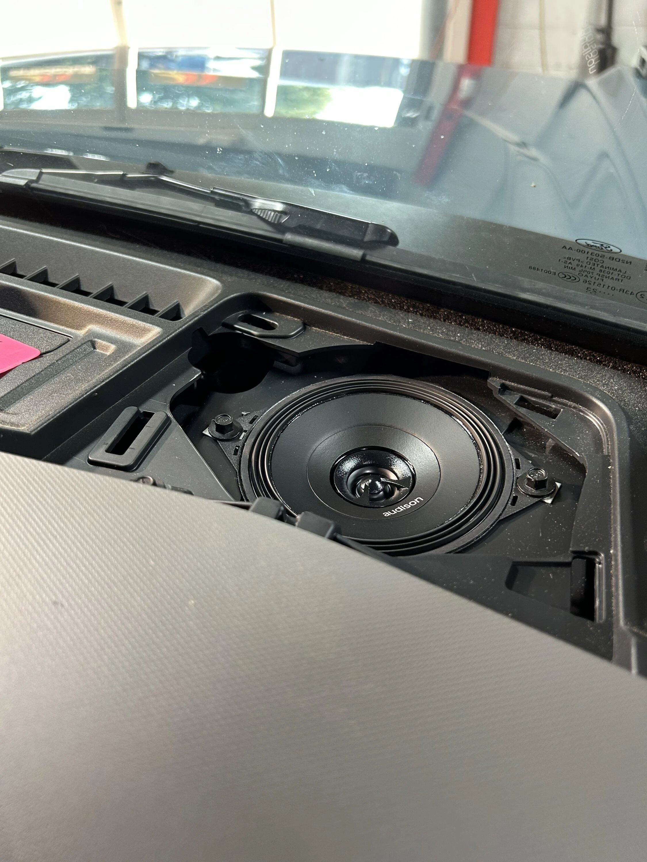

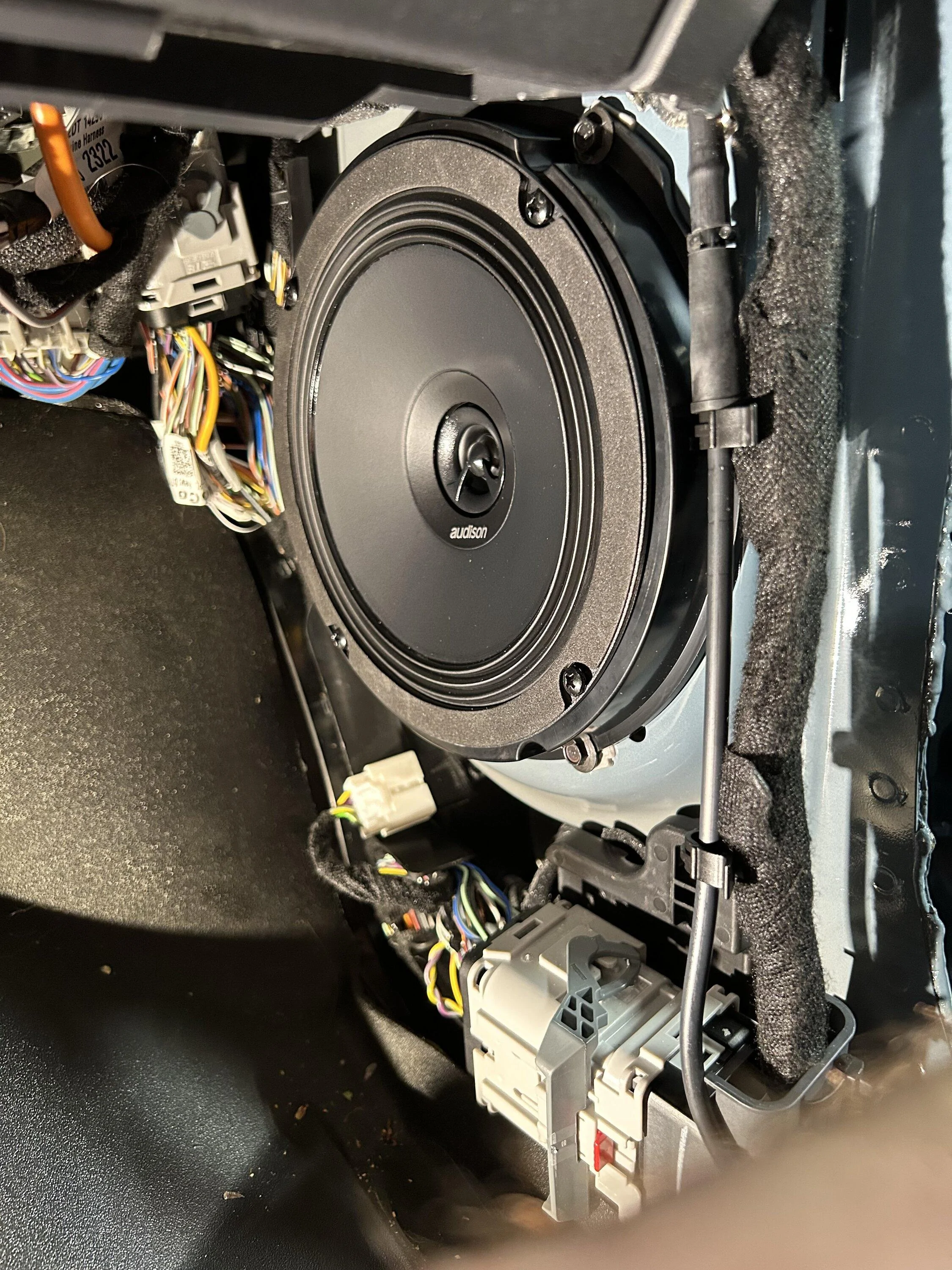

Here is what I did. I found a really good deal on 6 Audison Speakers-4" Coax for the Dash, 6.5 coax for the kick panels and 6.5 inch for some unloaded SSV pods I bought. I chose the Audisons as both installers recommended them and I liked that they were efficient speakers at 94DB. I also bought some cables with 300 htz bass blockers for the 4" and Metra rings for the kick panel installs. I met up with @dubseed who tinted my front windows of my Bronco-highly recommend anyone in the CT area go see him for tint, PPF and he also does a bunch of other Bronco work. Andrew is a great guy and was really impressed with his work. He has done the Kicker Key install and other stereo upgrades to his own Bronco.
He installed all 6 speakers, got wiring done and mounted the SSV pods and most importantly used Forscan to send a full range signal to the new pods, eliminated auto stop/start as well in under 2 hours. Here are a few pics
Results
Even without the sub, Bass is finally a part of the soundstage and the rear pod upgrade with Forscan is a massive change. I can't stress how big a change this made. I listen to pretty much all forms of rock music so I want to hear bass but am not looking for the Bronco to shake or give up space in the very limited back of the Bronco. Besides I think my dog would probably destroy it. If the Bronco shipped like it sounds now, I never would have thought of doing work to it. The Audisons are really efficient and I went from loud settings being like 16 or 17 when I was driving to 13 or 14 on the dial.
The Big Question is if I am done....Not sure yet. The Audison's are really bright in the dash-I almost have the treble all the way down-I may try removing the bass blockers or just get a set with a lower value. I may also activate the deleted sub or add an amp. If I do any of this extra work, it will be with a limited budget as I think the stereo is massively improved with what has been done so far. Also the SSV pods do not block anything out the rear window which was an important consideration as well.
Results
