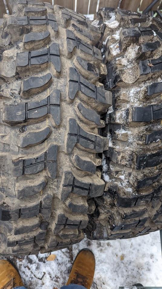

Video basically says it all. I modified my MAXXIS Trepadors with some tire grooving/Siping for improved winter performance. I think I can call this successful, but unfortunately we've had such a mild winter I have had limited opportunities to properly test or quantify the improvement.
Additionally, due to this mild winter, there has been little need for improved winter performance. So, I am not confident I can really say the juice was worth the squeeze. Regardless, it was an interesting and rewarding project!

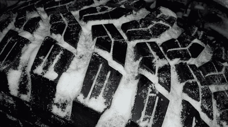

Stuggling to add photos... Most of its covered in the video. Heres another picture of the grooves doing their job.
Ford Bronco My experience using a tire groover on 37" MAXXIS Trepadors Packed Grooves.PNG

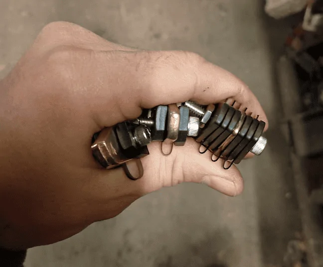

The number 2 (pack of three), number 3 and number 4 tools side by side.
Ford Bronco My experience using a tire groover on 37" MAXXIS Trepadors Tools.PNG
