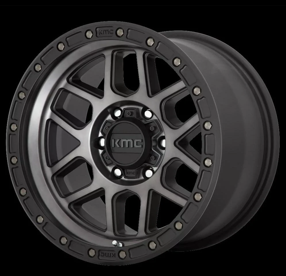

Going with KMC Mesa 17 X 9 with +18mm offset.
Went down and ordered them and a set of 6112 shocks from local 4X4 shop this afternoon.
Reuse the stock Goodyear 315's for now. When they wear out I'll see about something more aggressive.
ARB bumpers are on the way as well.

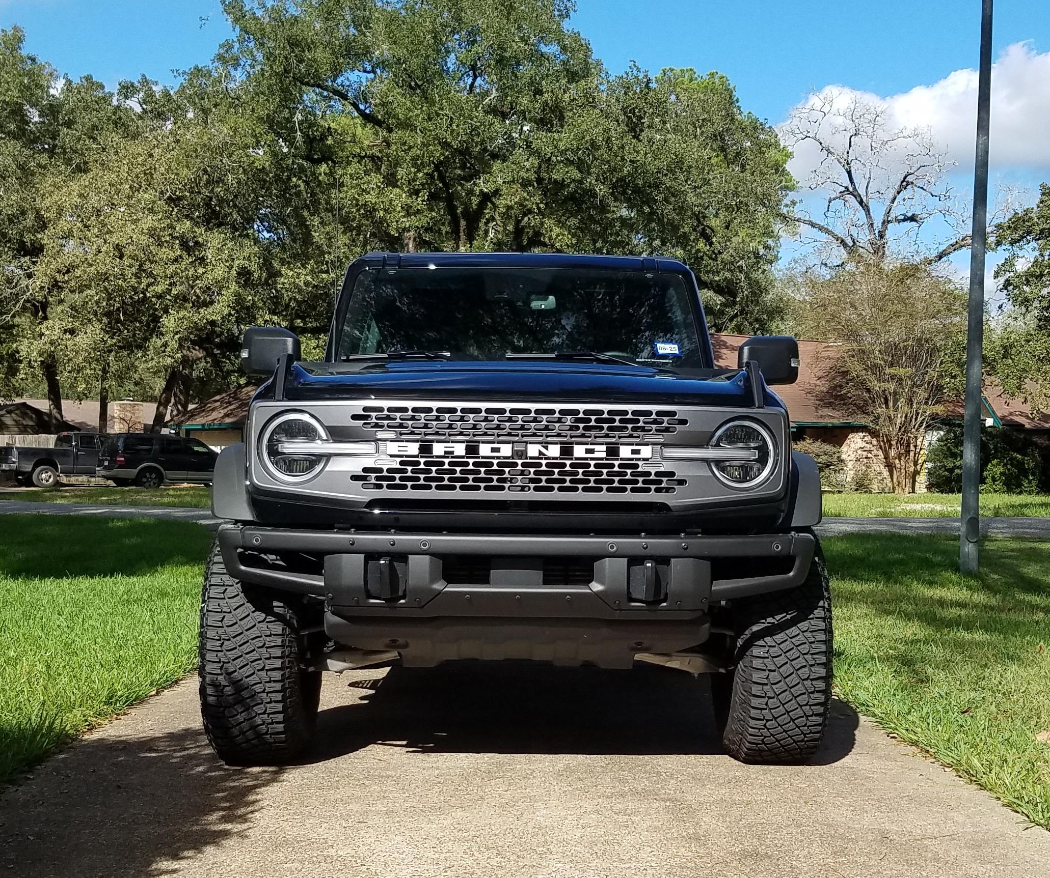

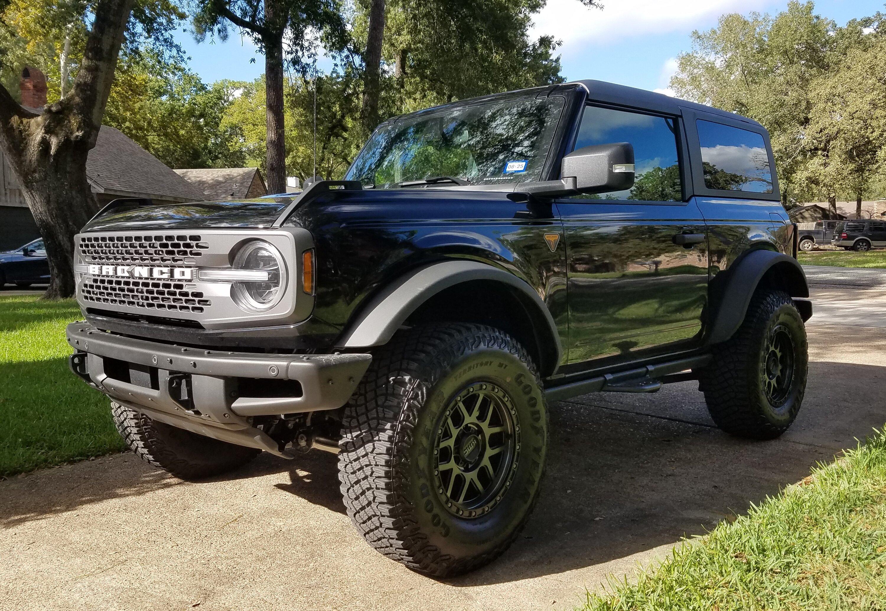

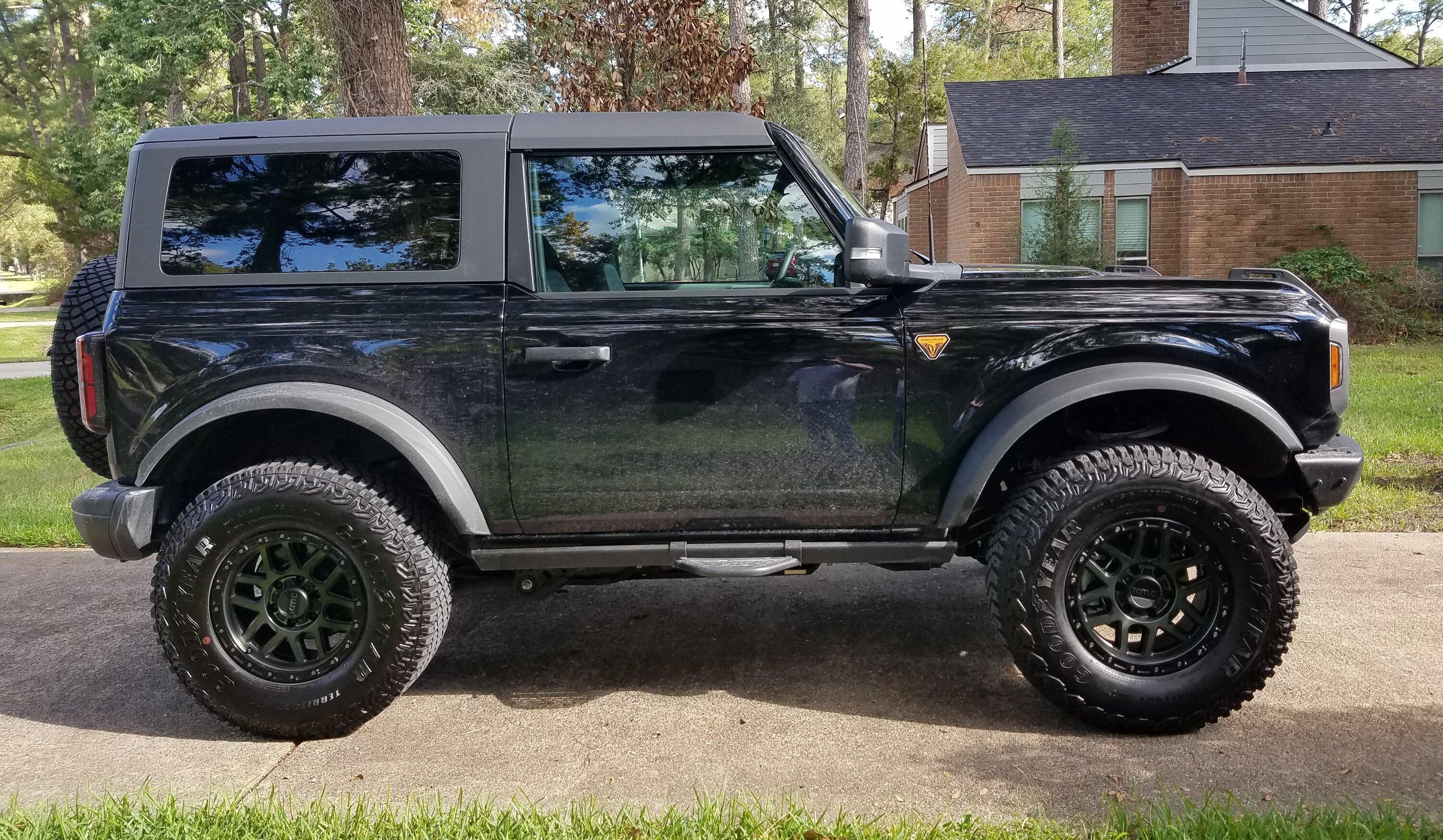

Well the Mishimoto intercooler and charge pipe kit is on back order until end of the year :(
Mishimotor airintake is here. One huge red flag that I already dont like about it is the entire box must be unclamped from the inlet tubes and removed from engine bay to change the airfilter. Not a very good design Mr Mishimoto.... other than that it's really well made.
Had them set the 6112's a half inch higher in the front in prep for the ARB bumper.
Perfect poke on KMC Mesa 17X9 at +18mm offset. Tread comes right to the edge of SAS fenders with nice sidewall bulge past them.

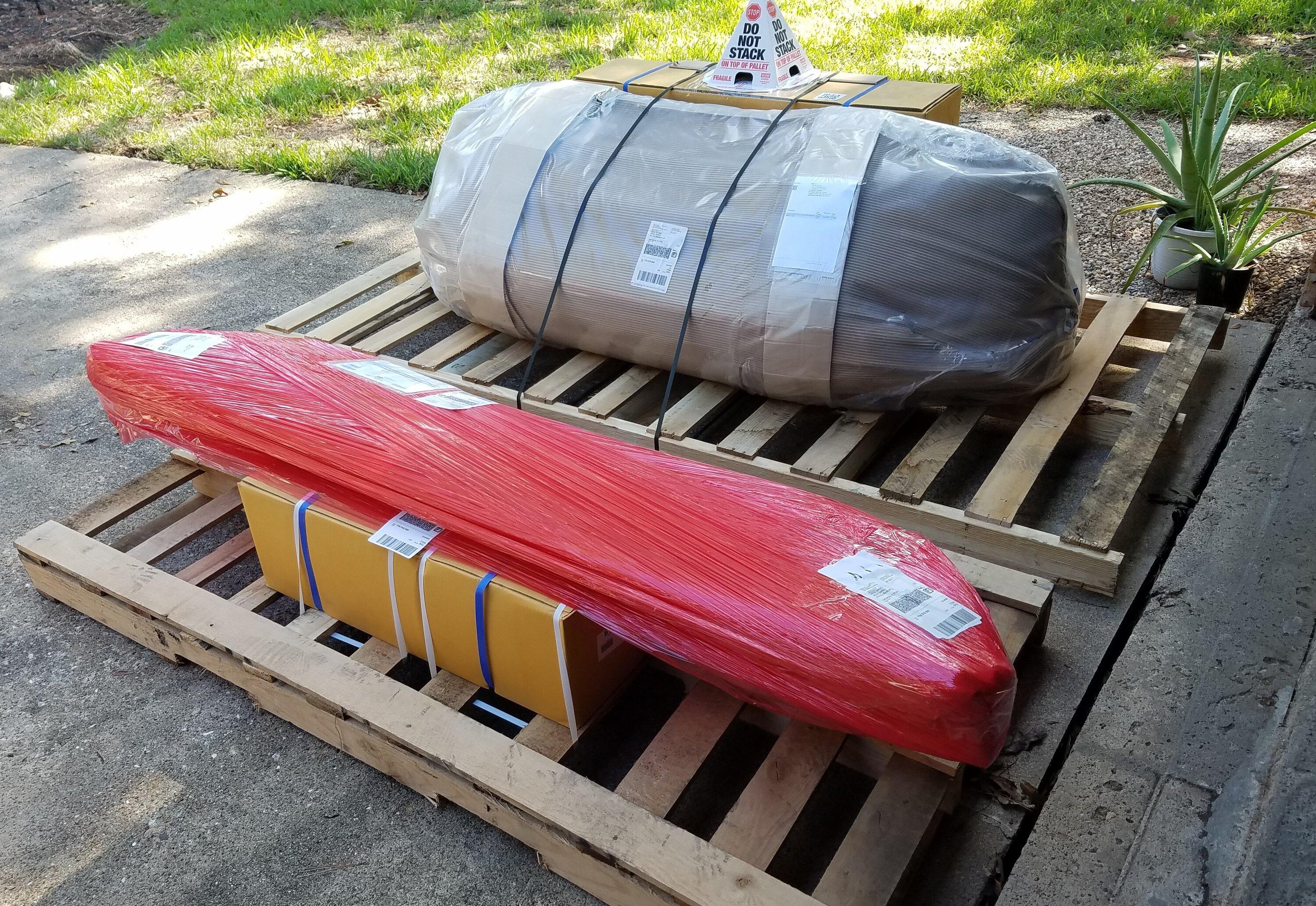

Bumpers are here too. For those worried about shipping damage, ARB seems to have figured it out. Oversized pallets bigger than the bumpers and multiple layers of packaging protection
Sitting at 40 1/2 in the front for total 1.5 inch of lift and 40" in the rear for about 1/4" of lift
The 6112's are still firm but nowhere near as stiff and harsh as the ESV stock yellow shocks
