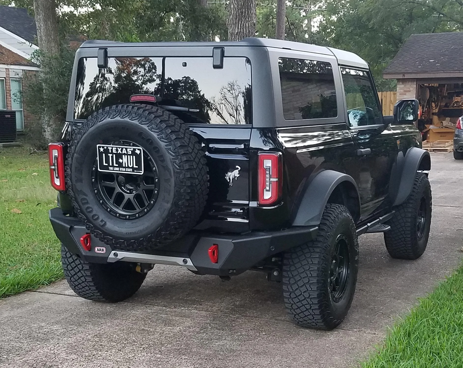

ARB rear bumper installed. Bit of PITA to get the main brackets installed.
Not a fan of the spare tire license plate. Will be ordering the DV8 low tail gate plate bracket tomorrow.

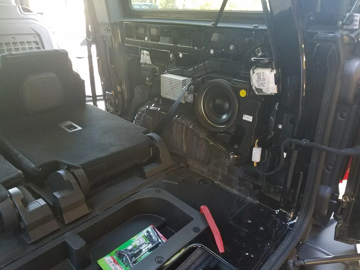

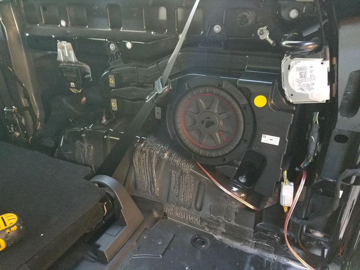

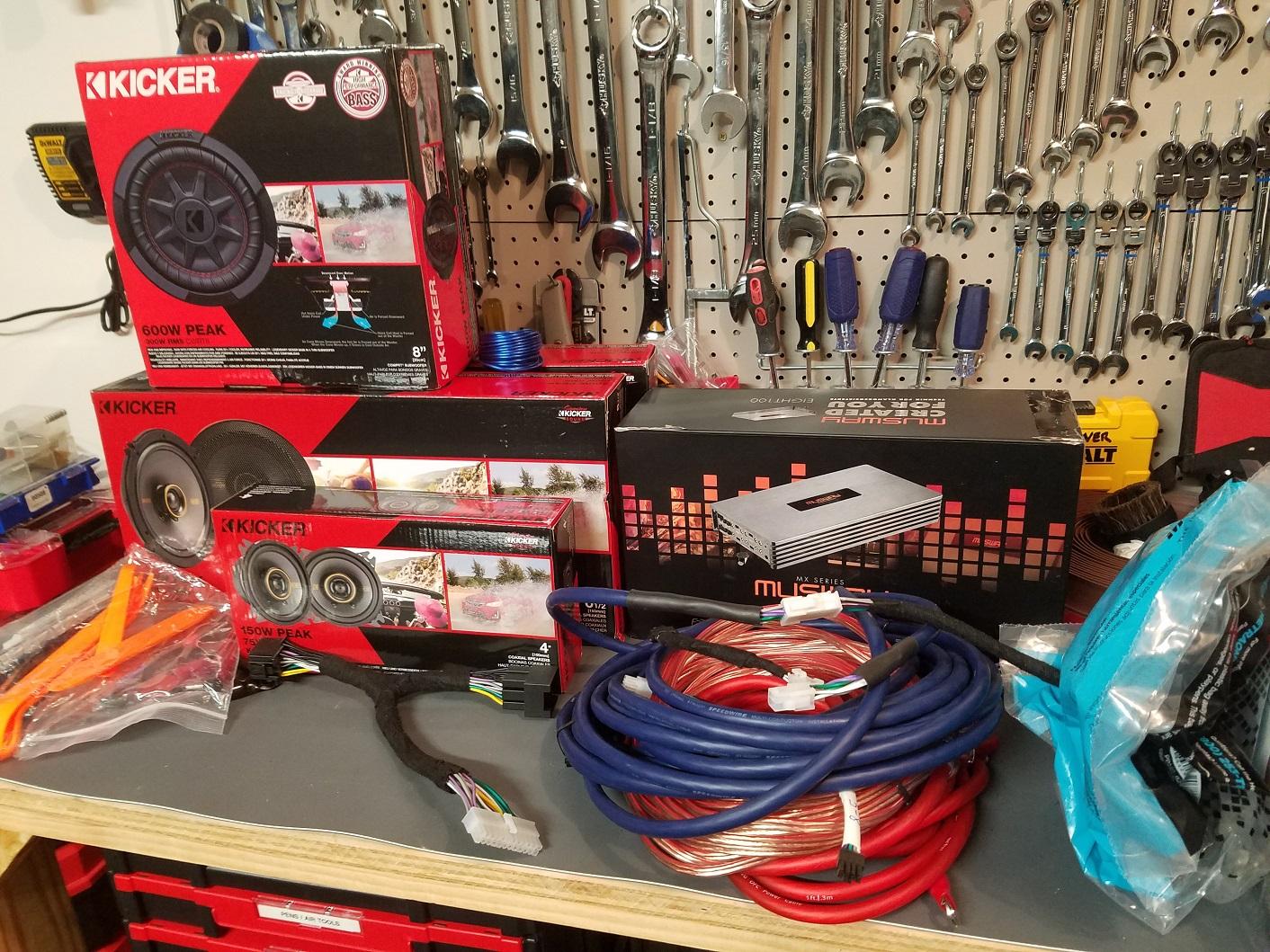

Time for some sound upgrade while I wait for front bumper parts
Kicker 4" for dash
Kicker 6.5" for kick panels
Kicker 6.5" with Mabett pods for the back
Kicker 8" sub to go in factory box and location
Musway 1400 watt amp to power it all
PlugnPlayKits harnesses and wiring.
Very nice complete kit from Plug-n-Play. He even threw in a set of panel removal pry tools for free. Harnesses are well made with OEM wire coloring and everything needed to tap into factory radio and run it back to the amp in the back.
Should sound waaaay better than stock crap in there now.

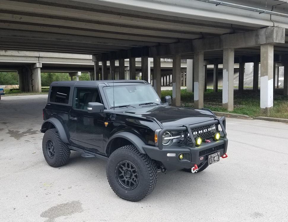

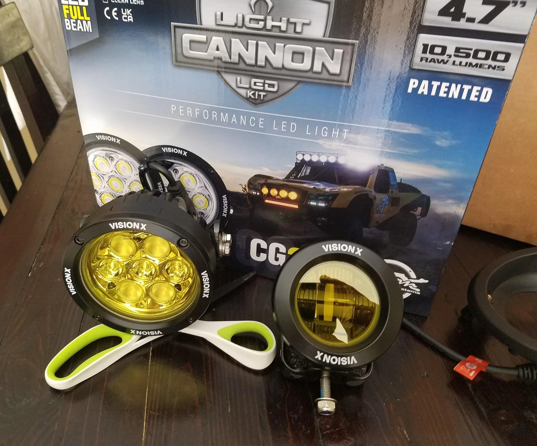

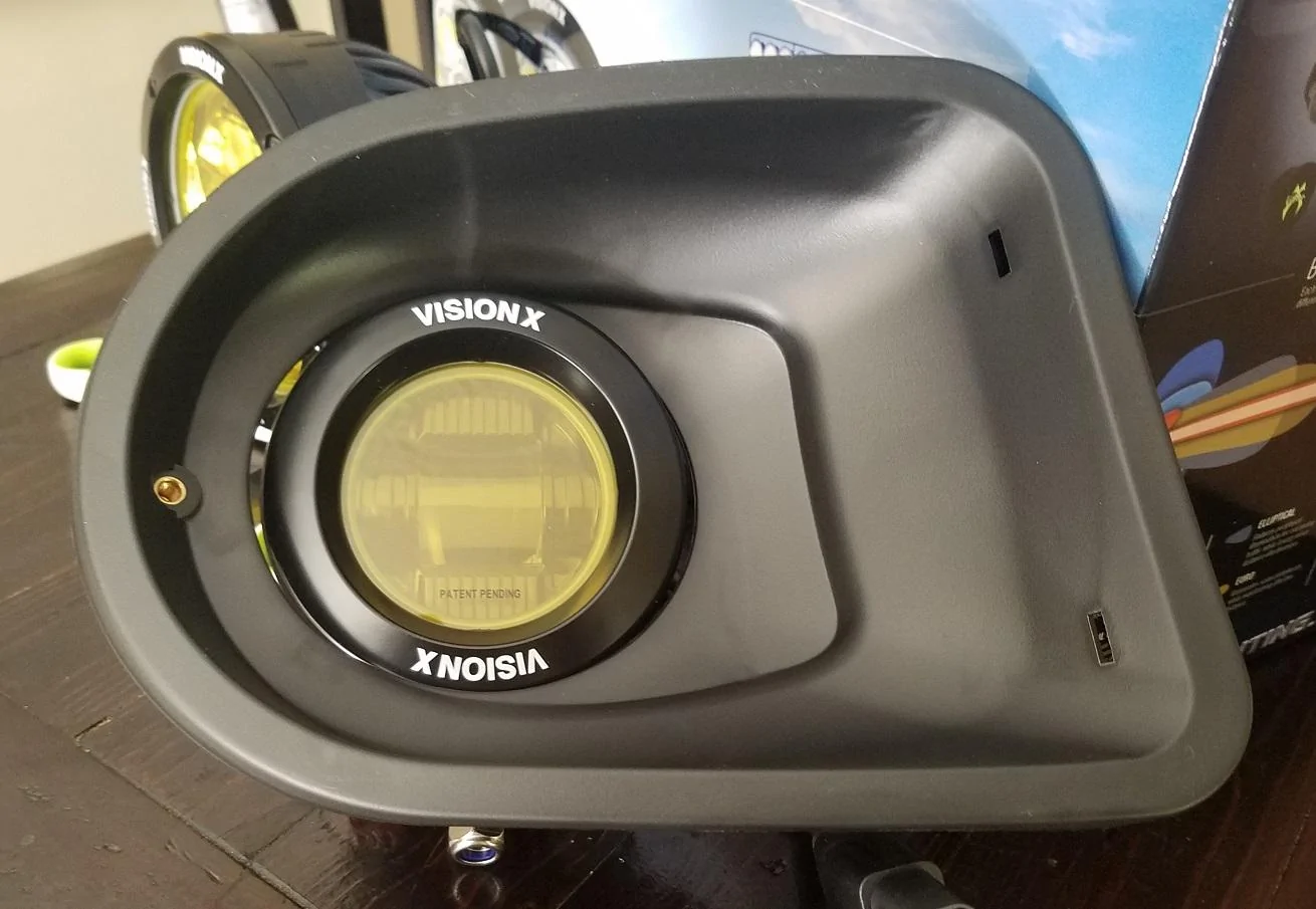

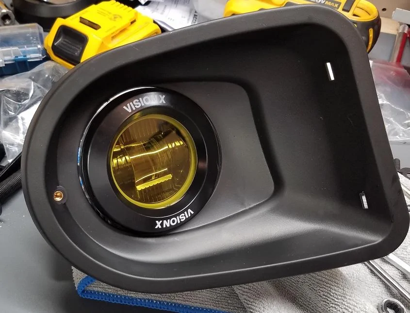

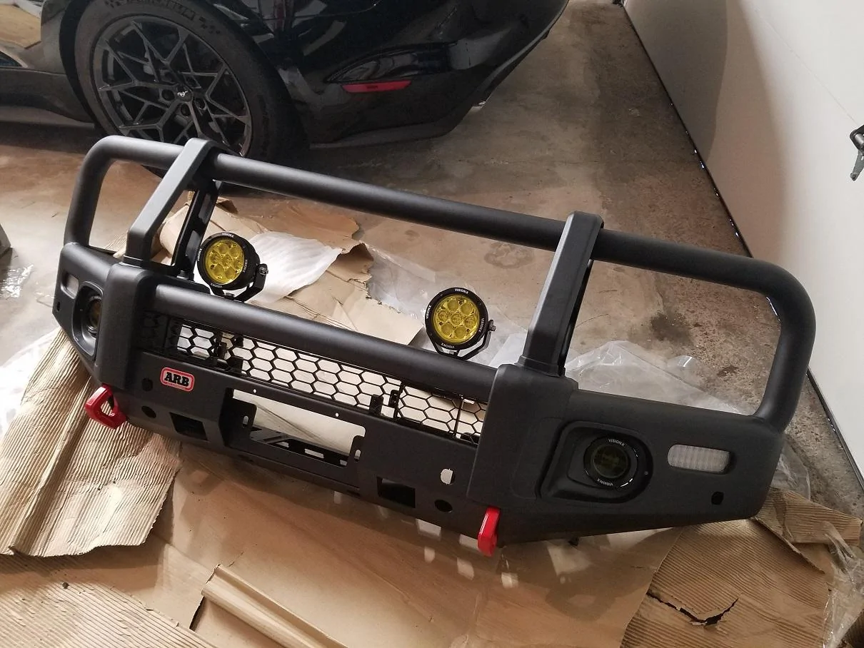

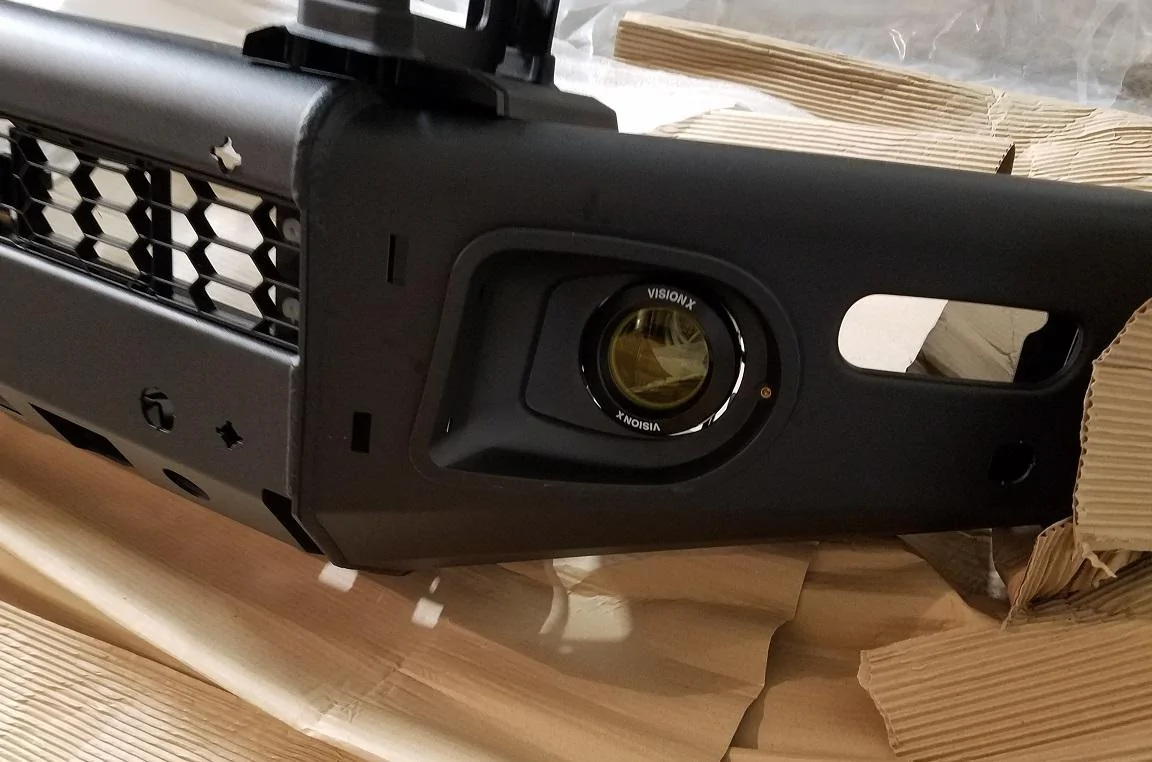

VisionX lights for the bumper arrived.
4.7" SAE cannon for top of the bumper and 3.3" SAE fogs. Both in yellow
The 3" fog lights fit in the ARB bumper fog light holes like they were made to go there :cool:
Kudos to VisionX for fast shipment. Glad I didnt waste $100 on expedited shipping cause their "free" shipping only took 2 days to arrive.
Thanks to @Inlinejohn for the inspiration on the light choice with the ARB Summit bumper
https://www.bronco6g.com/forum/threads/2023-badlands-story.64045/page-9#post-1937238
Now if RTR will just ship the freak'n grille that's been on order for 2 weeks I can get the front bumper installed....

Please share measurement changes from stock to ARB bumper changes… assuming you ll go down a 1/2”+ on both ends. Also photos and any advice on bumper changeout 👍
Lil Mul
Lil Mul
Oct 1, 2023
97
224
2023 2DR Badlands SAS / 2016 Mustang GT PP
Sure thing. Only went down about 1/4" on the back. The rear bumper isnt that much heavier than stock. The two giant frame wrapping brackets that the bumper bolts to are an absolute bear to get fully seated. They were designed for a tight fit without the powder coating... with it they take a tremendous amount of hammer persuasion to get in place.

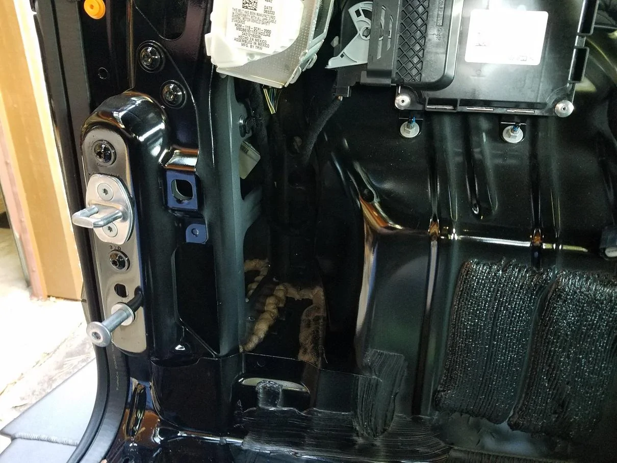

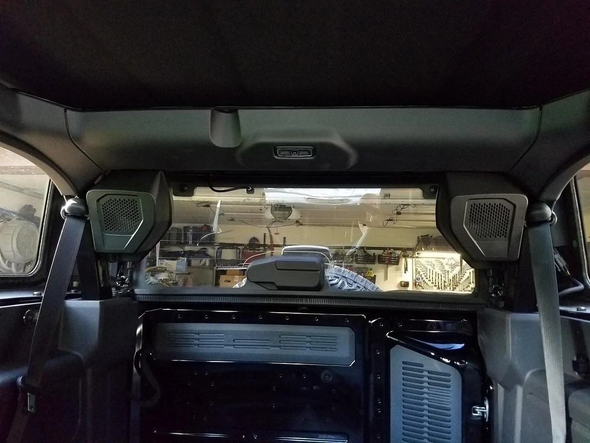

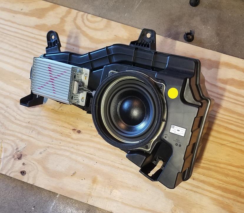

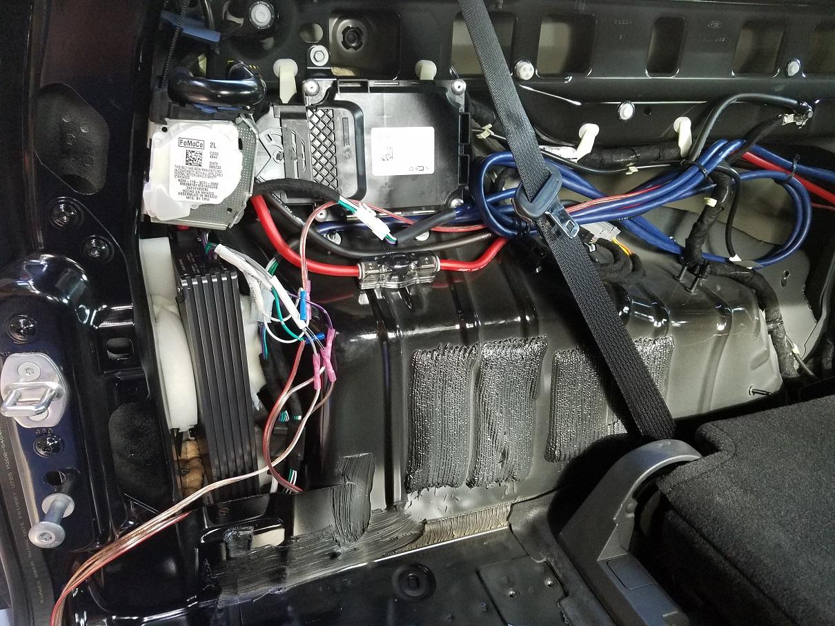

Speaker upgrade is finished. I'm now an expert at removing all interior panels 🤪
I would say it sounds night and day better, but it's more like the deepest darkest cave to noon day sun better. Still need to play with amp gains and cross over cut offs for the different speakers but well worth the time and money spent.
Had hoped to mount the amp to the factory sub box but quickly discovered it was never going to fit there. Luckily Ford left me a perfect little cubby hole on the driver side.

That’s a 2nd fuse holder I hope and you have 1 under the hood near the battery!
Fuse holder needs to be closer to the battery to do its job and protect the wire
Lil Mul
Lil Mul
Oct 1, 2023
97
224
Yes, there is another 125amp fuse right next to the battery under the hood. (y)
You need one next to the amp and next to the battery to really do it correctly.

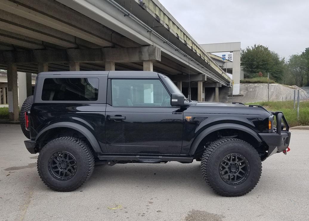

After cruising the forum for a bit now a feel bad for all you guys that had to wait years for your truck to get built.
I got a spur under my saddle a couple of weeks ago and went on Autotrader looking for Broncos with real pics on the dealer lot.
Found this gem sitting at a dealer 2 hours away from an order cancel. Gave them my info to do the paperwork and drove up and picked her up.
I had a very specific wish list. 2 door, badlands, Sas, V6, black or gray, with high or lux trim...... This one has the High trim, which is fine.
Ford Bronco My Little Mule - 2DR Badlands / Sasquatch build bronco16
Daily driver so I can't get too wild on the build.
Mod List to come:
Engine:
Mishimoto airfilter box and catch cans
Whipple intercooler - High Mount Mishimoto intercooler /charge pipes - Backorder end of 2023
RTR cat back Borla Climber Touring
Whipple tune
That combo should push the 2.7 real close to 400hp and 500ft torque.,
Interior:
Full speaker, amp, and subwoofer upgrade with 6" rear speaker pods ✅
Goose Gear full rear seat removal deck system
Body:
RTR grill
ARB summit bumper and rear bumper
RTR rear tailgate reinforcement
Lots of added skid plates underneath
Trailrax roof rack
Suspension:
Bilstien 6112's to start I think. I just want to level it for now
Billstien 6112's installed. 1.5" lift ✅
Wheels:
Something in a 17X9 with gray and 20+ mm offset. Just enough to get the side walls poking past the sas flares.
Probably keep it on 35's for now. 37's would be awesome.... but again its a daily commuter.
17X9 KMC Mesa black with gunmetal +18mm offset. Goodyear 315's ✅
I'll update as I make progress... not in any rush.

Bumper is prepped and ready to install. I highly recommend jumping to the middle of the ARB instructions and doing this BEFORE you tear your truck apart.
The attached PDF is the color copy of the instructions I found on the forum. Very helpful over the black and white instructions that come in the box.

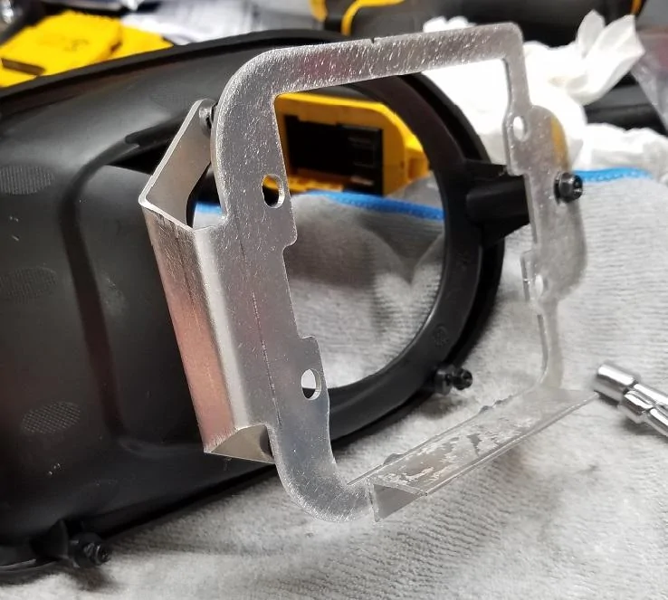

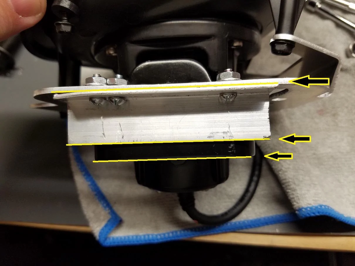

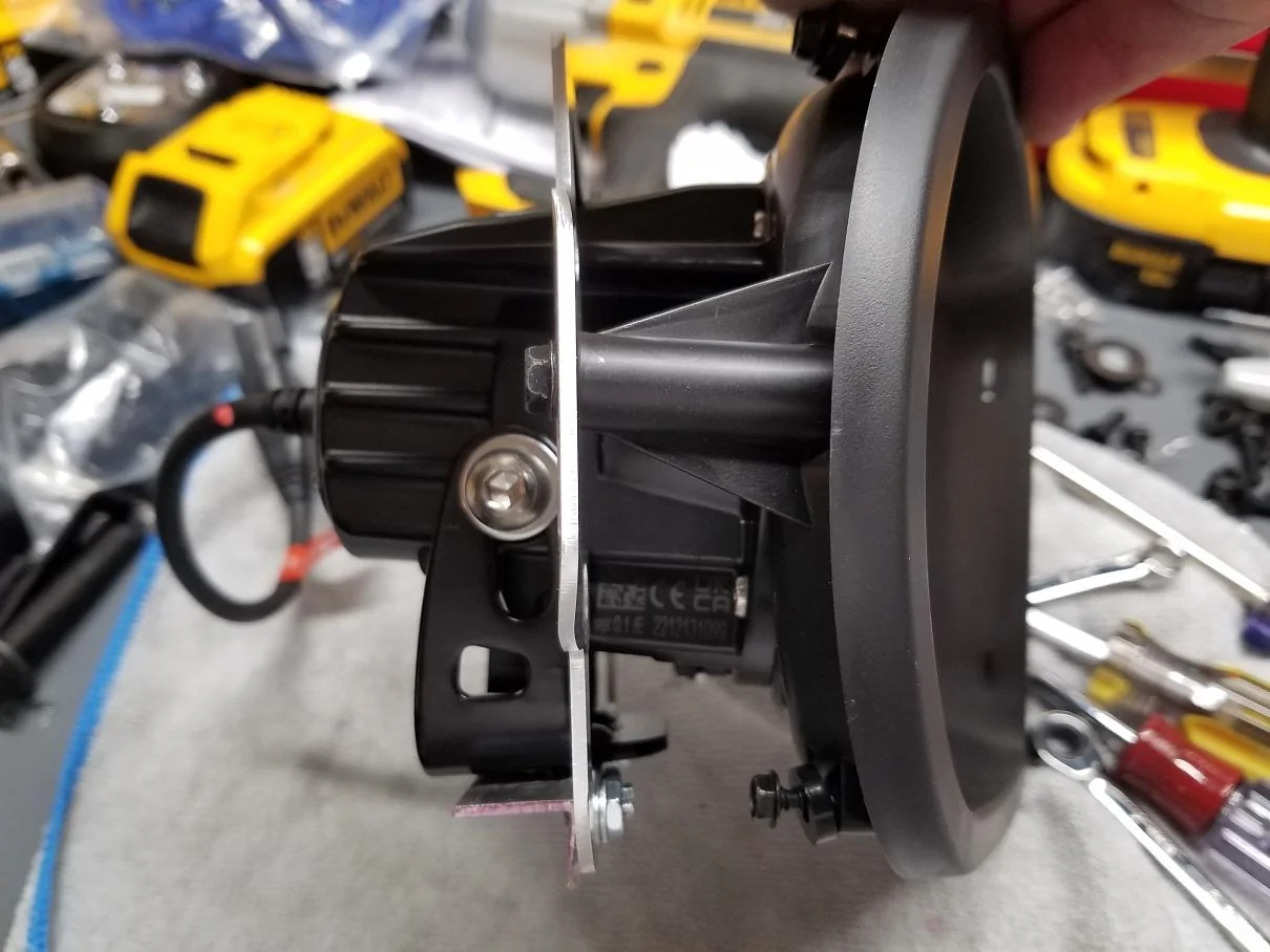

How to install VisionX street legal SAE 3.3" fogs in the ARB Summit bumper using the factory fog light brackets that come with the bumper...
Got lucky they fit with very little trimming and modifying of the ARB bracket meant for the OEM fog light. Just had to attach a small angle piece of aluminum to give the VisionX fog something to sit on and bolt to.
Ford Bronco My Little Mule - 2DR Badlands / Sasquatch build bronco19
Align the VisionX bracket to the fog light bracket to get it square. Once you have it squared up mark where the VisionX bracket's bolt hole is and drill the hole.
Full rotation and tilt adjustment of the VisionX bracket is still usable.
Ford Bronco My Little Mule - 2DR Badlands / Sasquatch build bronco20
Ford Bronco My Little Mule - 2DR Badlands / Sasquatch build bronco21
Ford Bronco My Little Mule - 2DR Badlands / Sasquatch build bronco22

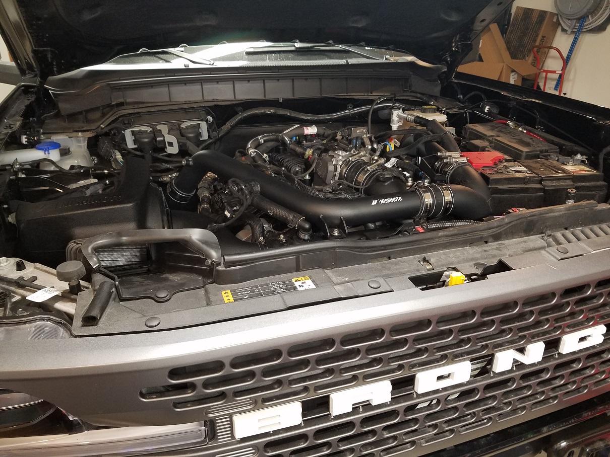

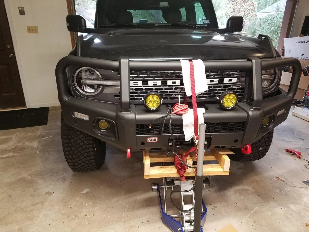

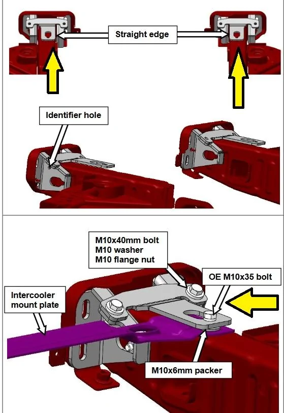

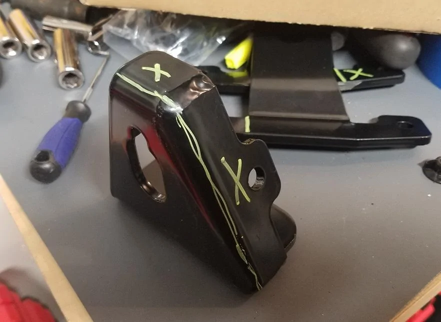

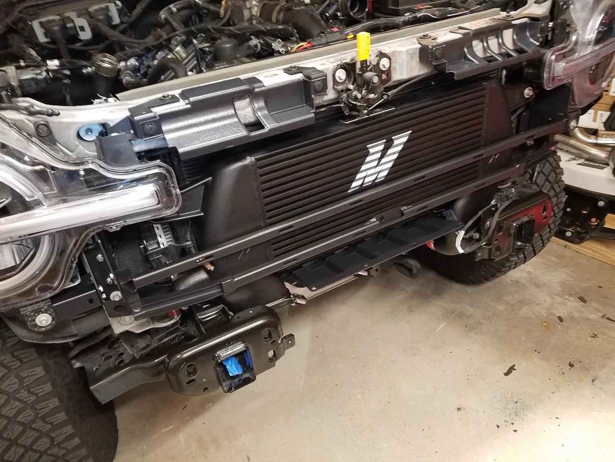

Big note to anyone wanting to install the Mishimoto higher mount intercooler with the ARB Summit bumper. It will take heavy customization of the mounting brackets to work.
Let's start with that....

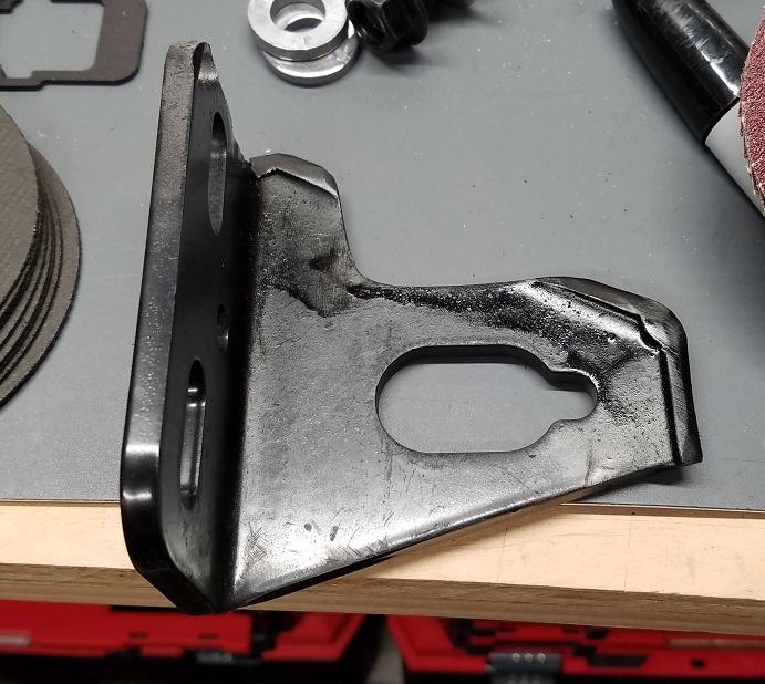

The Mishomoto intercooler comes up right next to the front frame rails. Normally this is not a problem but ARB heavily reinforces that area with brackets and bolts running through the frame rail.
Ford Bronco My Little Mule - 2DR Badlands / Sasquatch build bronco31
The top bracket with yellow arrows pointing to it must be discarded completely.
The inner side bracket must be cut and ground down until it looks like pictured below.
The outer bracket can be installed as is.
Ford Bronco My Little Mule - 2DR Badlands / Sasquatch build bronco42
From this...
Ford Bronco My Little Mule - 2DR Badlands / Sasquatch build bronco25
To this...
Ford Bronco My Little Mule - 2DR Badlands / Sasquatch build bronco26
After looking at what ARB was doing here I had no problem making this modifications. ARB is reinforcing an already strong assembly from the factory. I was able to maintain most of ARB's reinforcement and feel confident it's stronger that what came from Ford if not as over the top as ARB had in mind.
Be prepared for struggle to make it work, but it can be done...

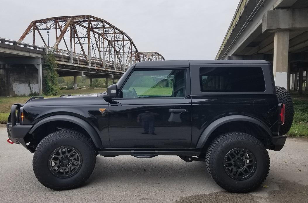

With Bilstein 6112's on perch #4 on the front it really did not sag at all from the weight of the bumper and winch. Maybe 1/4". Truck is sitting level front to back at 40" from ground to top lip of the SAS flare.... About 1.5" higher in front and 1/2" higher in back than stock SAS ride height.
The Bilstein 6112's ride about the same as the yellow shocks, but with noticibily less body roll when pushing it.

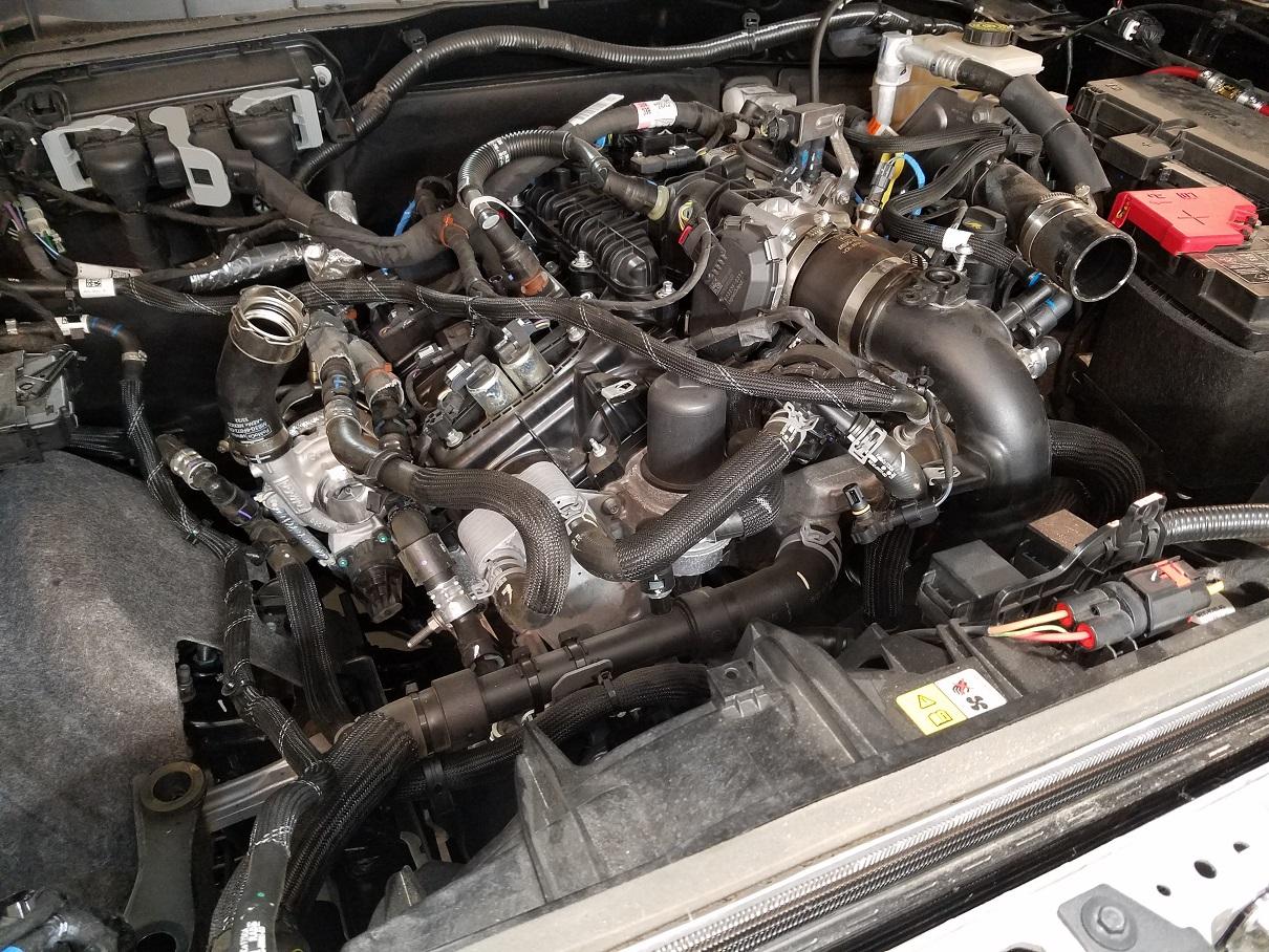

The Mishimoto high mount intercooler and charge pipe kit was extremely well made and packaged. ARB gives you a giant grab bag of nuts and bolts. Mishimoto individually bags, labels, and bubble wraps every piece to OCD levels.

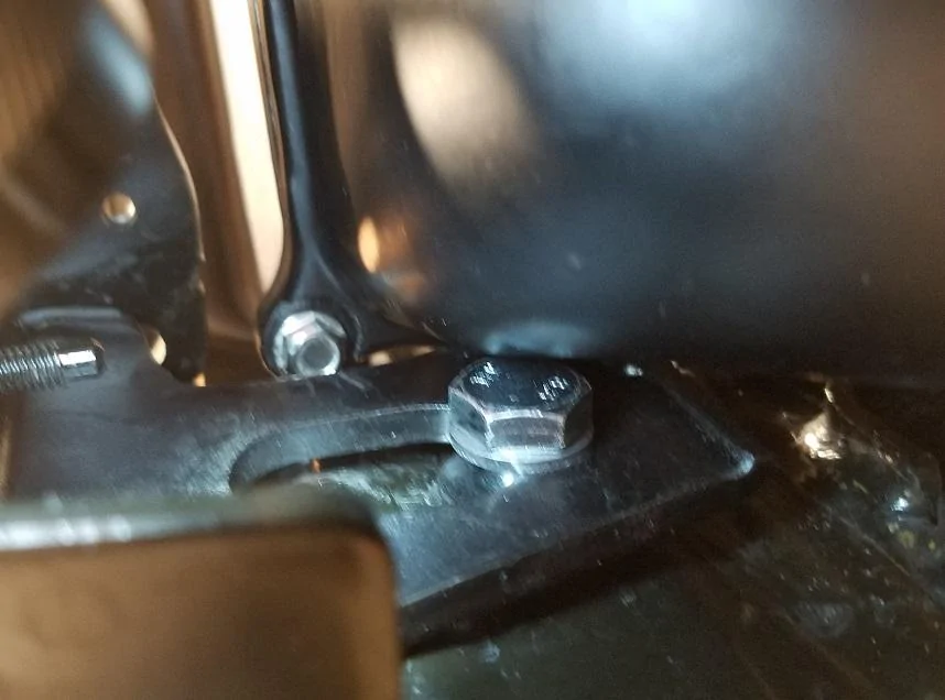

To help hold the spacer shims in place while mounting the bumper I loosely bolted them in place to get the alignment perfect then used a hot glue gun to glue them to frame. Worked like a charm.

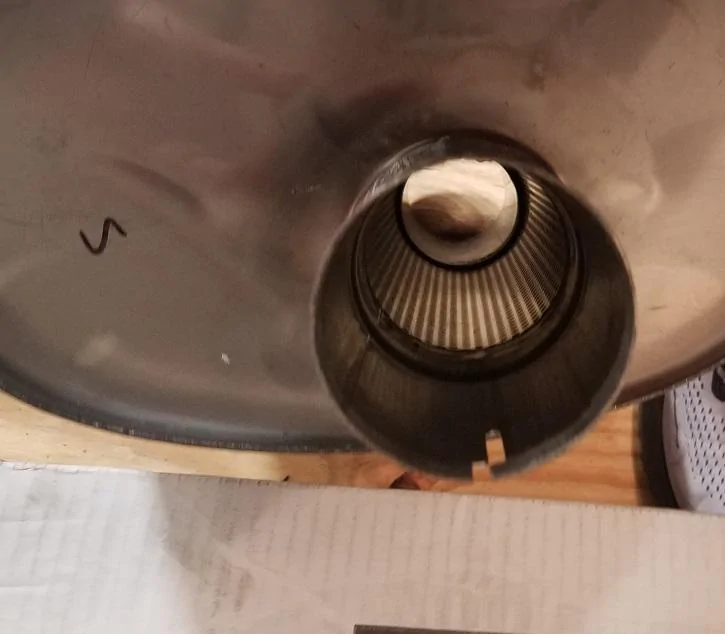

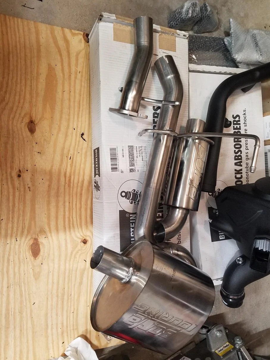

The Borla Climber Touring exhaust took about 1.5 hour to install and I love the sound. With Mishimoto stuff and the exhaust the truck sounds awesome at WOT. No drone and not loud on cold start.
