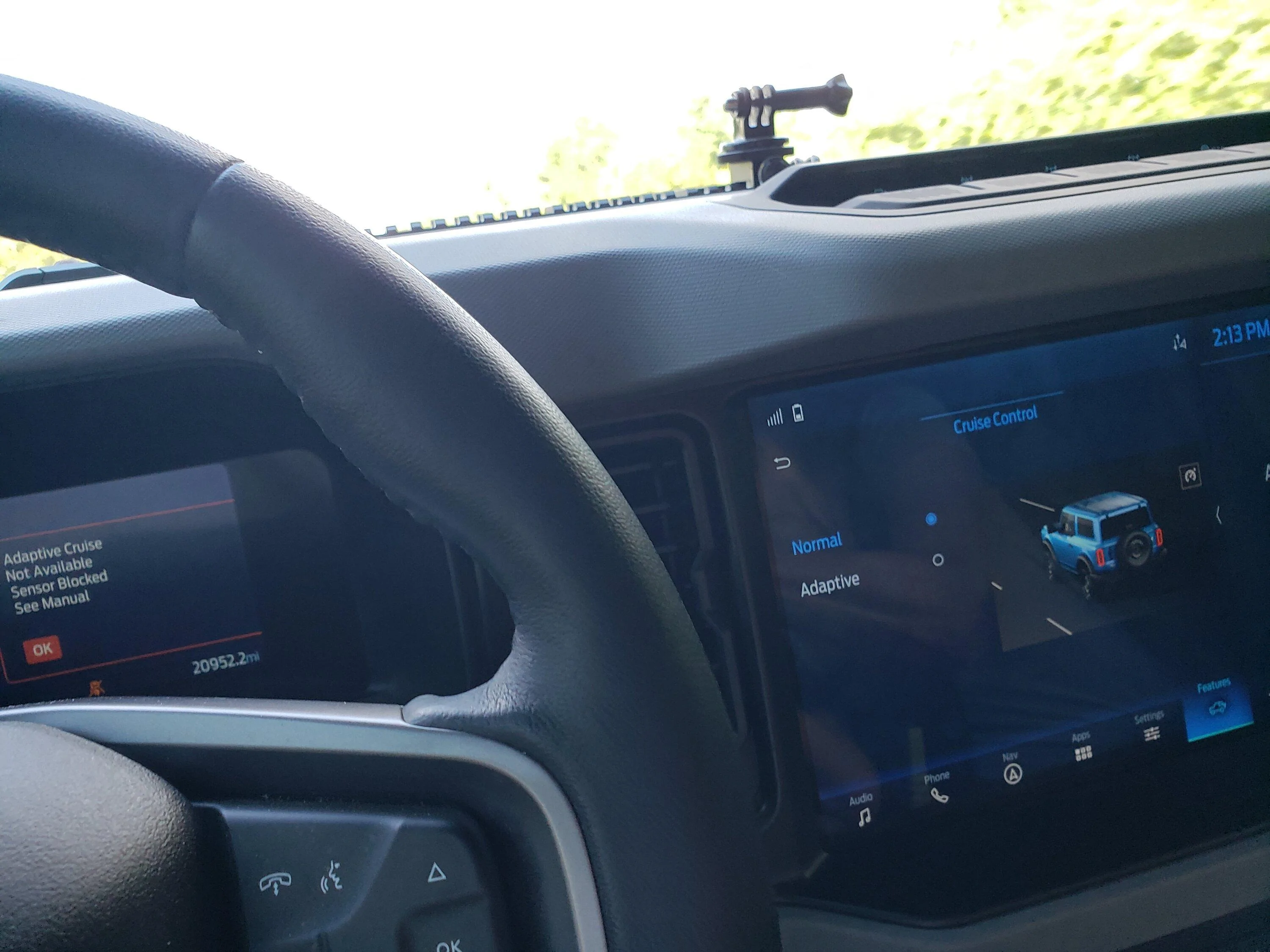

I'll start this off with part of this is my fault. I have the adaptive cruise control module blocked, and might have one of my parking sensors messed up. More on that later. But even with these, I should be able to go into setup and switch to normal cruise control, but its acting like it will only do adaptive. Here's a pic showing its set to normal and when I try to set cruise it throws an error.

Anyone have any idea how to fix this, or have seen it? I'm currently in Maine and have to drive back to Missouri in a few days. It worked most of the way here, just stopped around new jersey. Didnt realize how much I would miss cruise control until its gone.
Extra info: Added winch to bumper causing acc and parking sensor relocation, then added prerunner bar which now blocks relocated acc. I'm going to put the acc back when I get home.

It specifically says adaptive cruise isn't available, so regardless of whether you choose normal cruise control or not, it should just be plain old fashioned cruise control.
Did you actually try to test it?

Thats the error I get when I try to engage the normal cruise control.

Thats the screen on the right. I have it on normal not adaptive.
