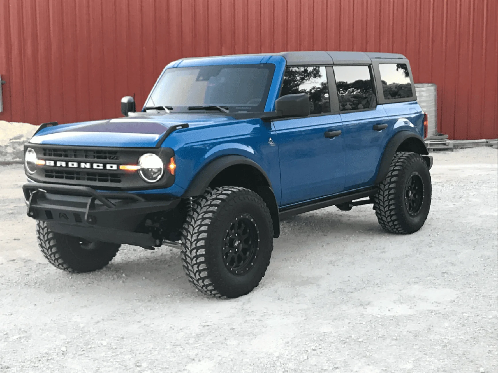

Hey y’all, been driving my 4 door non sas for a few months with the updated suspension. (Sasquatch take odds with eibach pro springs replaced). I do have 35” tires on it as well. Am I gaining any lift or comfort by replacing them with the Ford performance coil overs, or even the eibach pro truck coil overs? Definitely seems like a rabbit hole to me.

The Eibach Pro Truck coilovers are adjustable. I just installed them on my ‘24 BD non SAS. The front adjusters are about halfway up and the rear are only about 1/4 of the way up. I plan to lower it a bit. I’m running true 35” tires. Your tires do not appear to be a full 35” tall. Maybe just an optical illusion idk. I feel it’s a better option than the Ford Performance setup.
Ford Bronco Non sas 4 door suspension question! IMG_8122
They may not be a “true” 35”. They’re the Kenda klever. Website says like a 34.8” or so…. I do forget that the Ford performance aren’t adjustable. Reckon there’s a reason why I see so many broncos with the eibach adjustable ones.
A perfect height. Well done sir.
