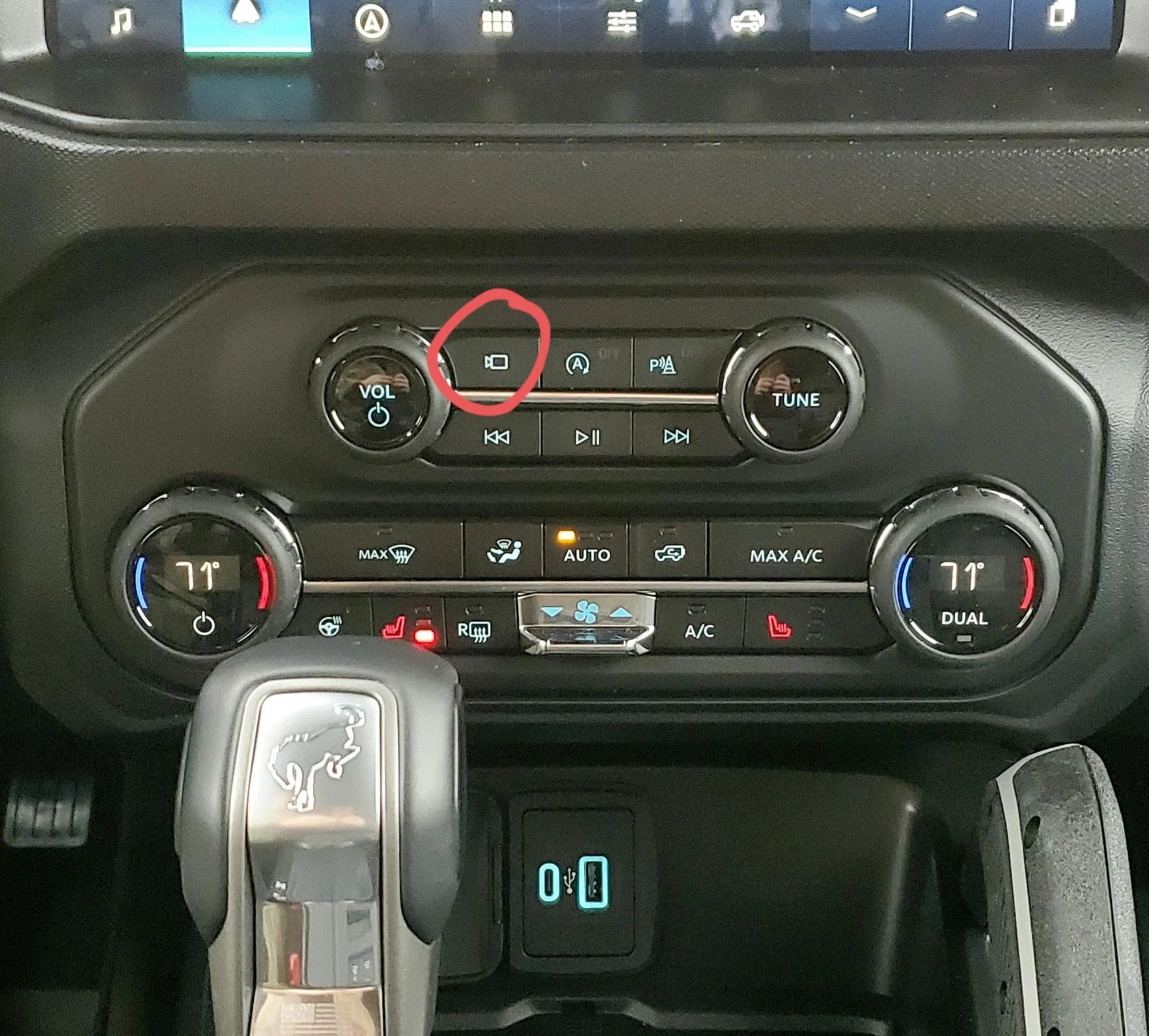

Where is that camera button? I have looked all over for how to activate the front camera when I am parking, and all I have been doing is popping it into "R" to see the over head view.
Assuming you have the camera package, it's here:
Ford Bronco Option to turn front camera on when using Park Assist? 20211118_085051
If it had been a snake it would have bit me. I've looked right past it a hundred times now. Thanks!
