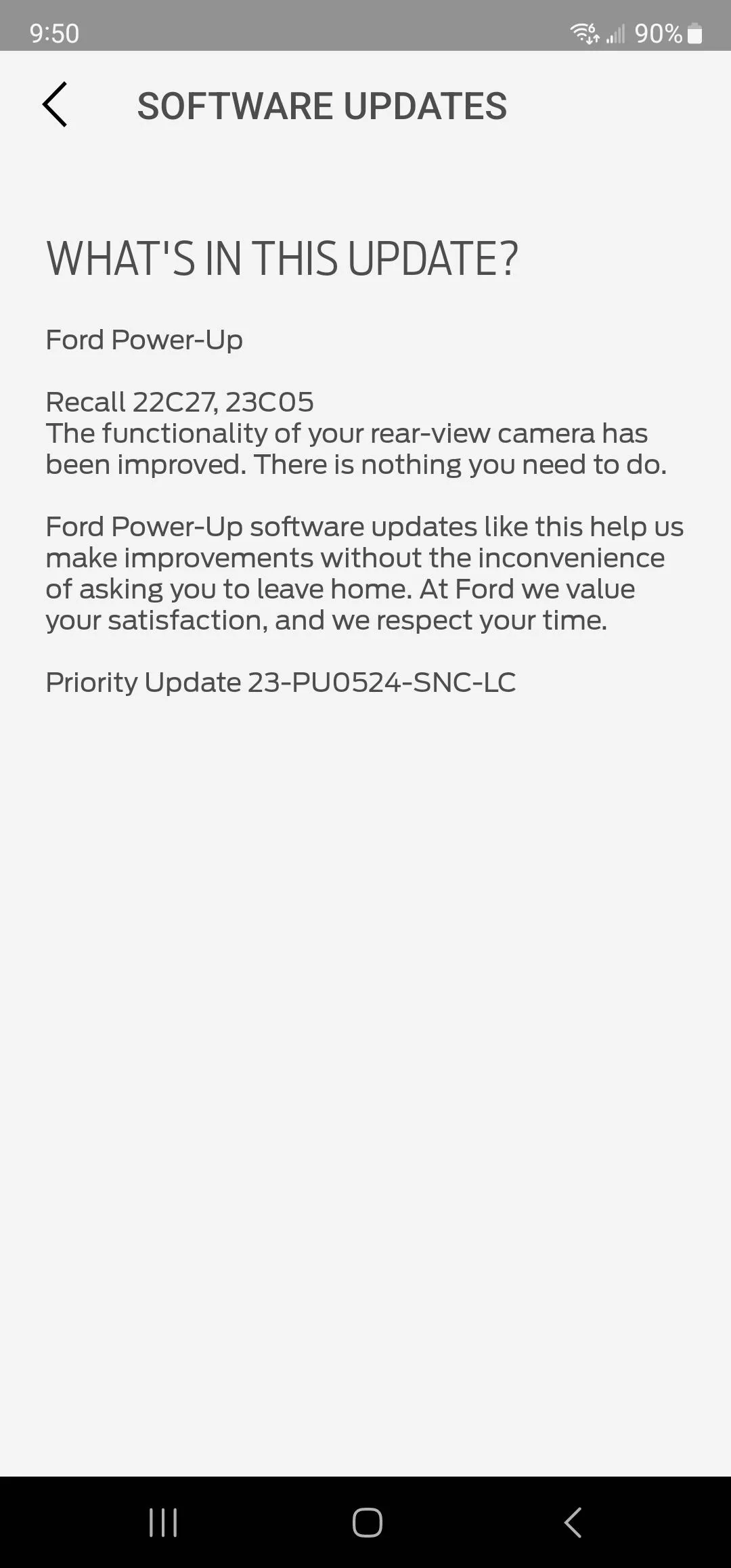

I found it @Ford Motor Company, can you tell me WHY my rear view camera keeps cutting in and out when it didn't before this update?
Ford Bronco OTA update (for rear camera) Screenshot_20231113_095020_FordPass
If you have a 21, you more than likely have another recall for the rear camera replacement due to it cutting out. 23S48 is the recall number.
I suppose that will be my next recall then. Have a '21 BaseSquatch. Damn camera worked just fine BEFORE that October update 🤦‍♂️ And along with that update, now sometimes music will skip every couple of seconds in Android Auto. Works just fine after a few minutes though. That last update, just messed up things that worked ok previously.
