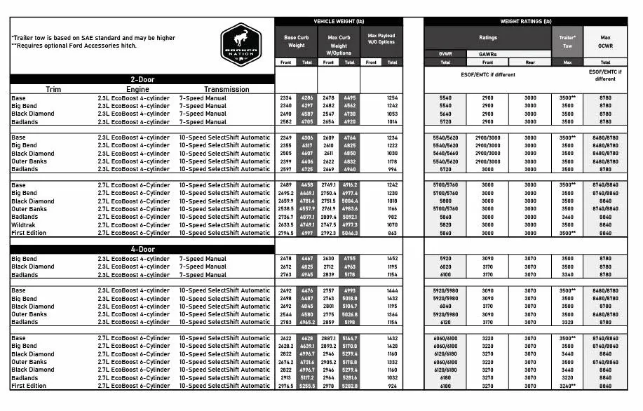

Anyone know if it is possible to spec a 2 door to over 6000lbs GVWR?
I’m wondering how heavy the HD bumper and brush guard are and if it’s enough to push it over that magical number. :)

I don't really know what you're asking, but there is this:
Ford Bronco Possible to spec 2dr over 6000lbs GVWR? GVWR Details V31024_1
