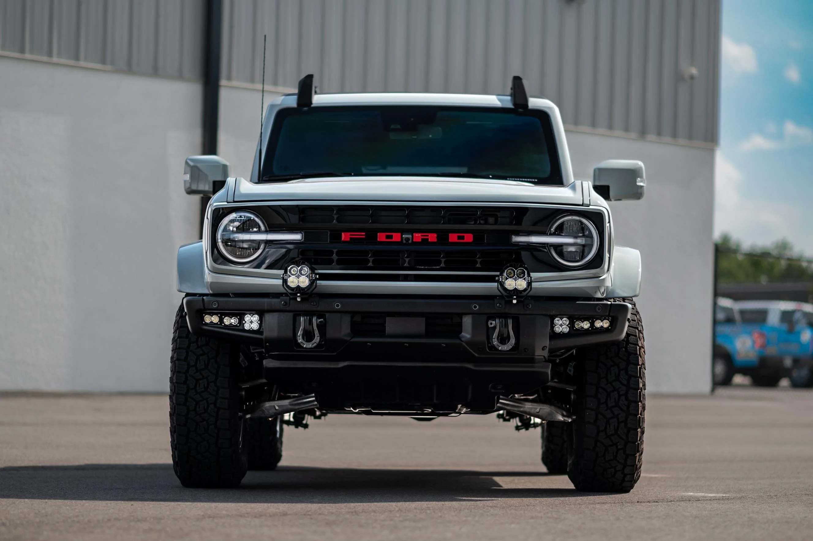

The Ford Argent would be the correct Silver color if you are going for the Early Bronco look. Top with Clear Coat for shine. Body color around the edges of the Grill.
The current 6G Bronco has the Iconic Silver which also would look great on the center of the Heritage Grill.
I went with a Black Center for a Special Decor Grill.

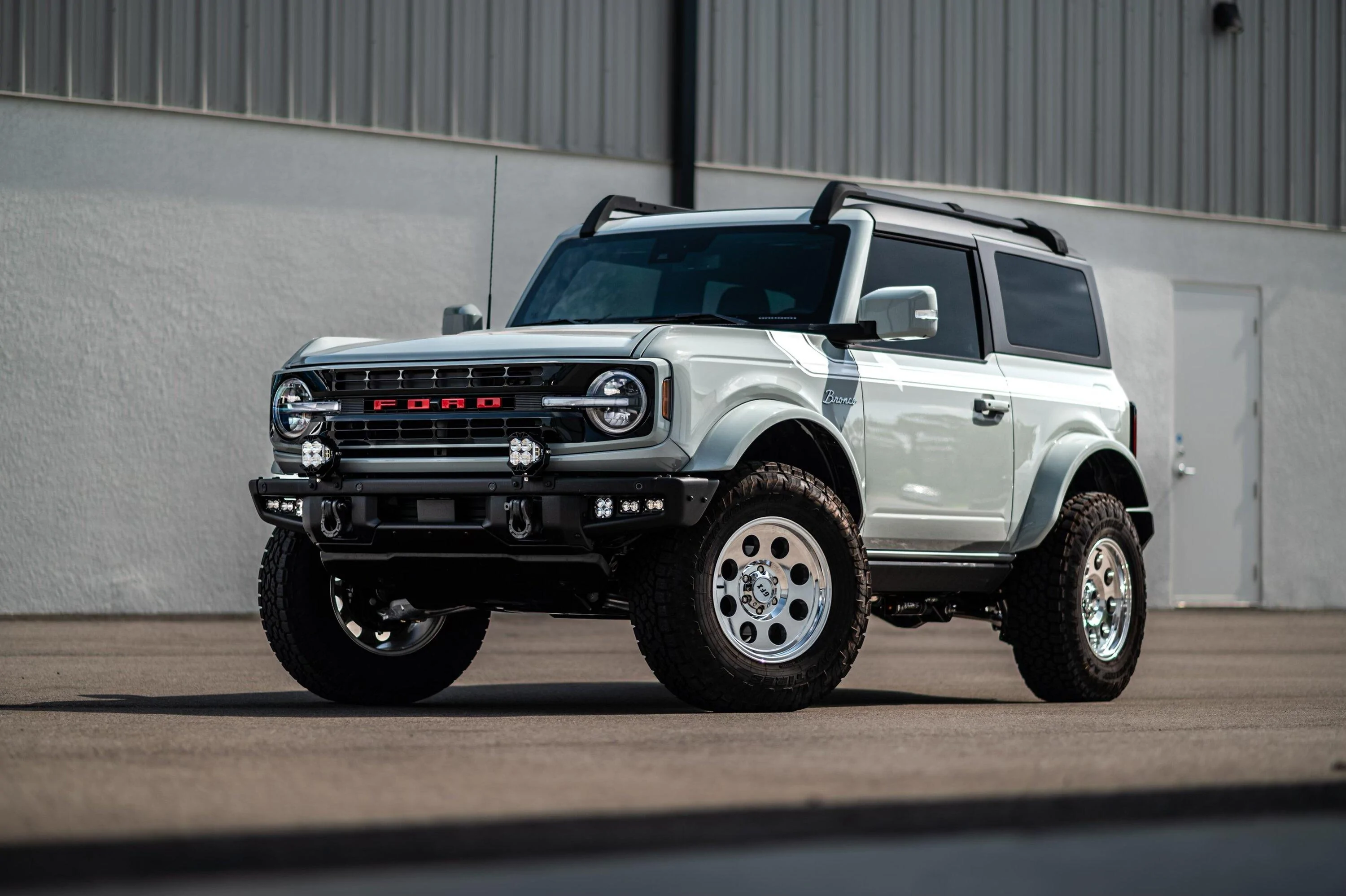

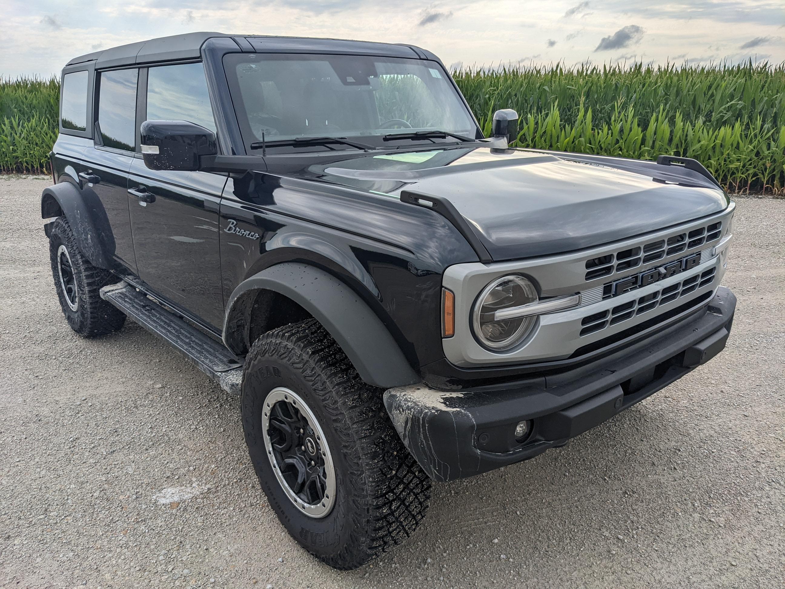

Here's silver on Heritage grille and then a painted surround on a grille like your WT. Your call, painted surround mimics the EB a little better.

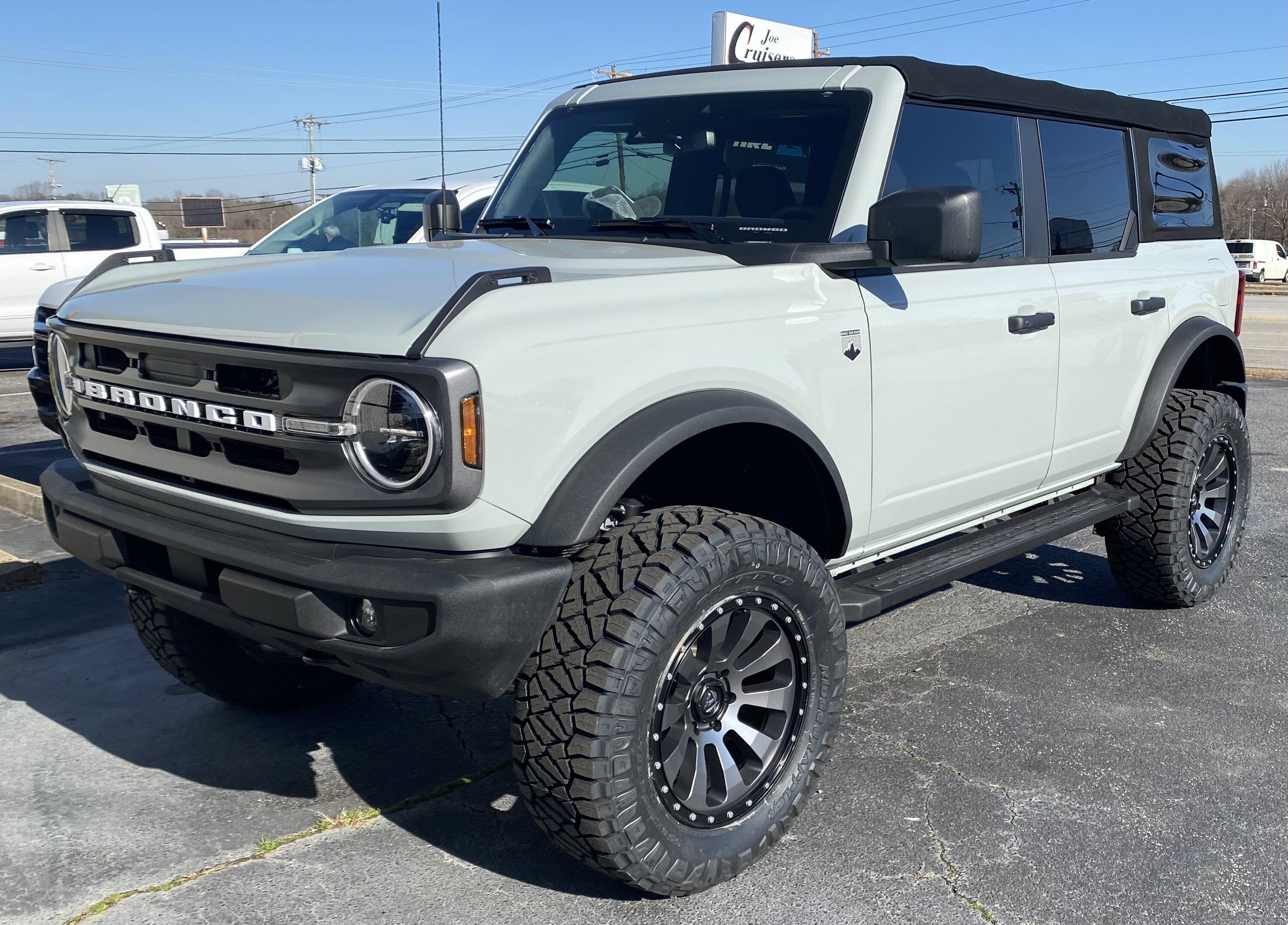

My 2021 Big Bend Grill is a great grey color. I actually bought my wheels to match the grill. Stock Ford Color I am sure.

It’s an opinion thing, really. But I personally like the body-colored surround look.
I did mine and it is one of the top 5 favorite changes/additions I’ve done.
To me it helps disguise the bulk of the plastic grille, invokes more of the 1st gen look, and just plain looks better.
