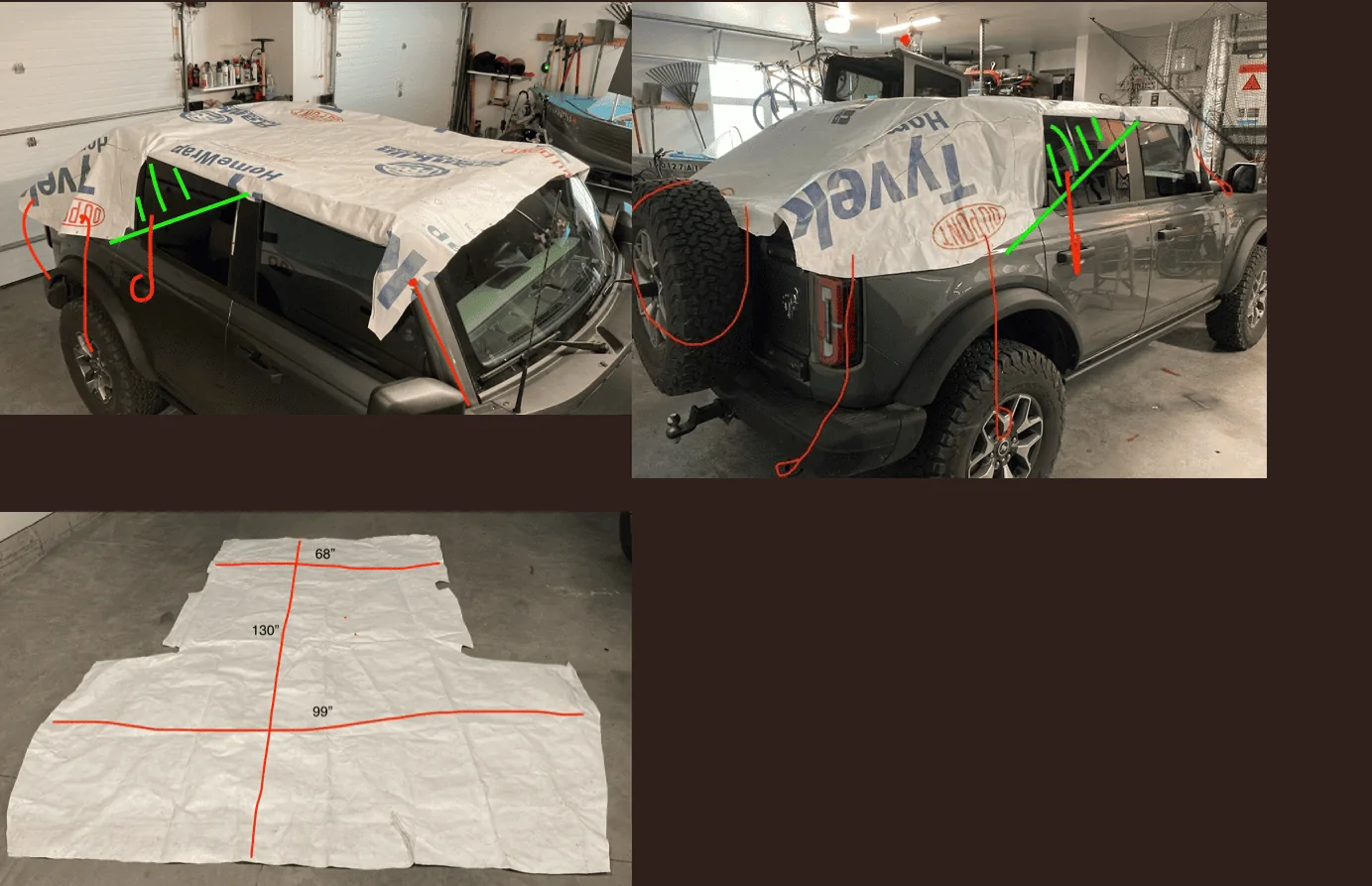

This is in prototype.... a quick "emergency cover".
However not to drive with, just to protect during camping and such.
Yes, you should care about flapping as it will rip the @#$@$ out of your paint.
If you want something to drive with, the issue will be that back section, you need to hold it so tight as you drive, it really needs to be hard mounted or have some sort of frame to it to bold to the bolt holes. The transition from the back door to the trunk area will be tough.
I suppose you could wrap something into the interior and then close the rear door on it to make that seal, but then the flapping on the rear quarter panel will be killer for your paint.
At this point, what you are looking for is called "the soft top" :(
