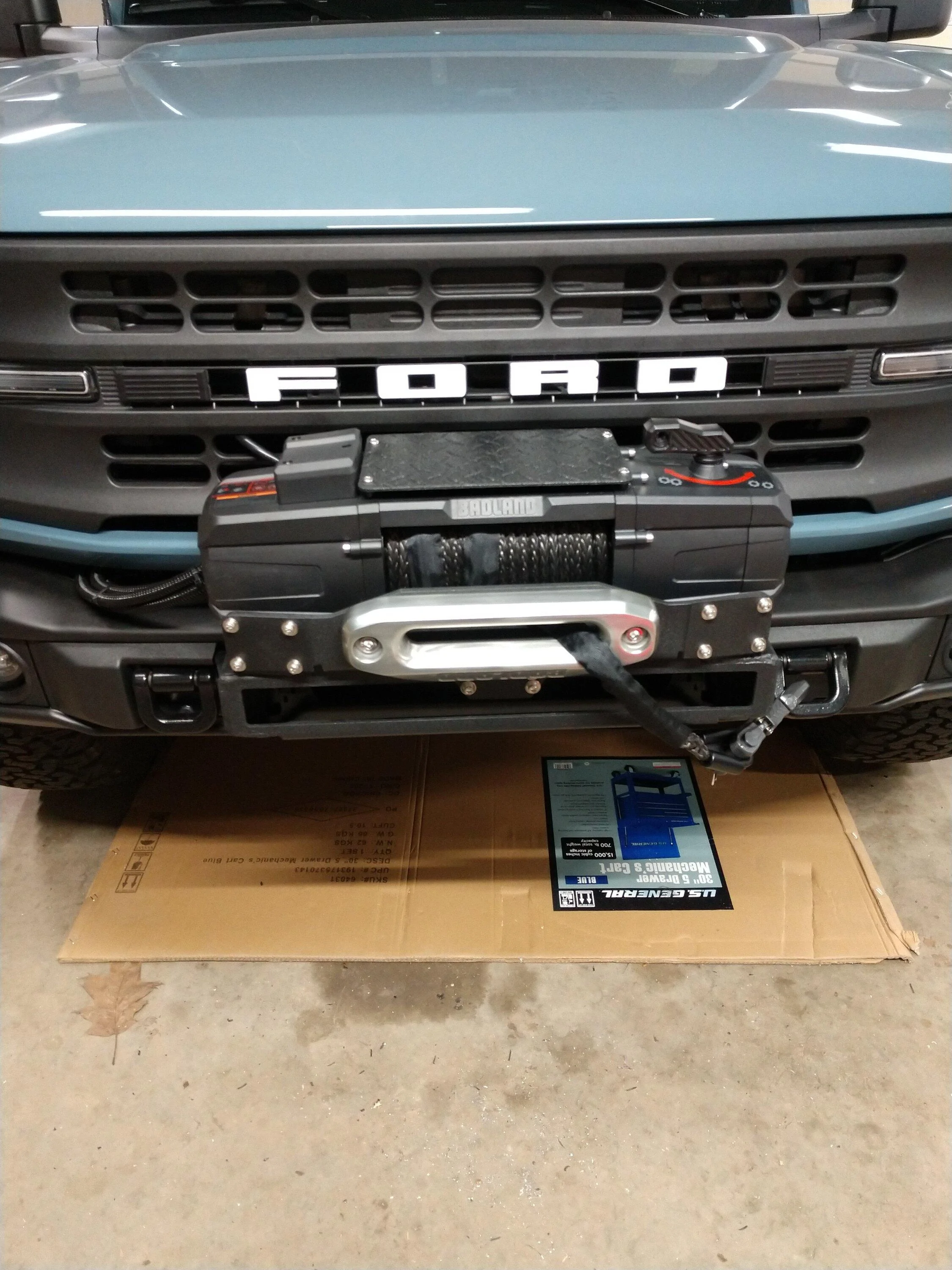

This looks really good but, does anyone else notice the misalignment of the winch vs. the ends of the sensor mounts? I feel like every photo has this. My OCD is a nightmare I guess, but it's really bothering me 😂
Depends (a little) on the winch. The comeup winch is longer, but still looks a bit off center. I hadn’t looked closely before.

Yeah never noticed on mine before either or cared I guess. But your spool should be centered with the fairlead.
Most winches are not symmetrical about the spool.

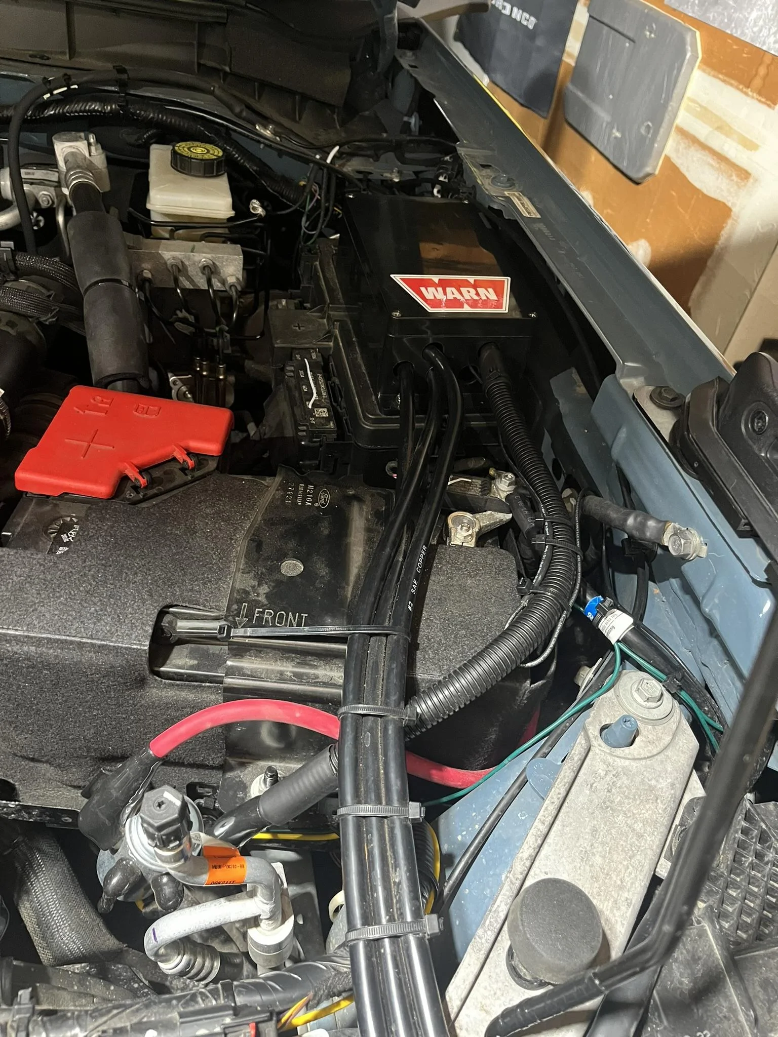

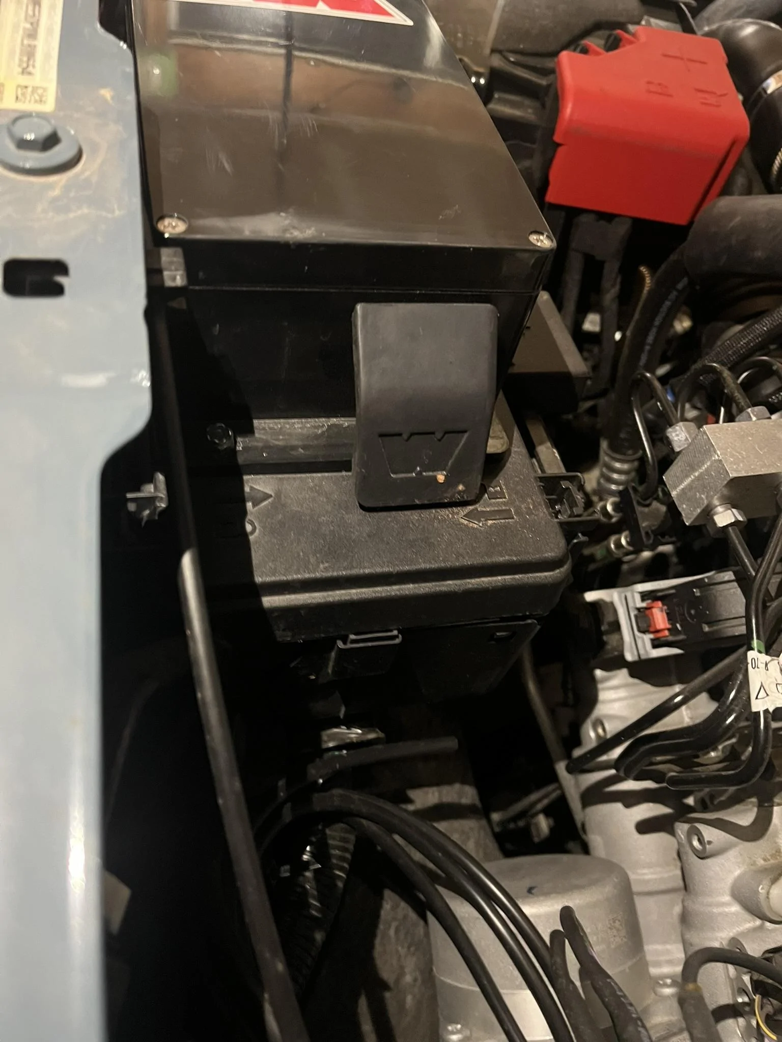

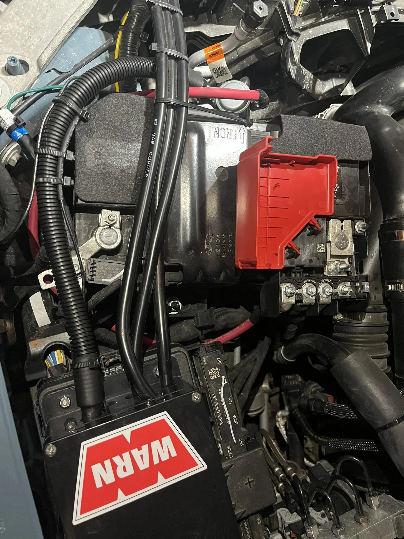

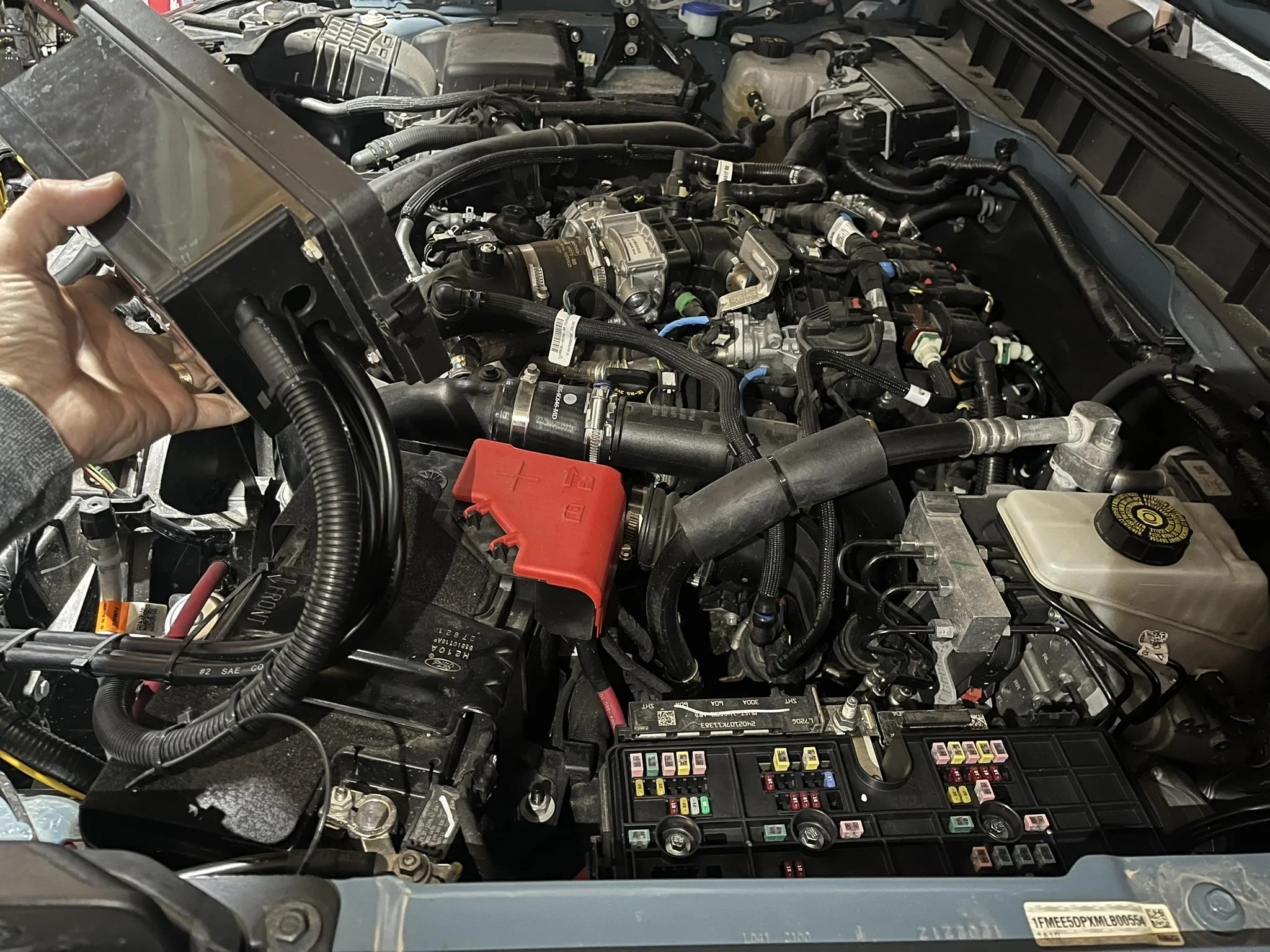

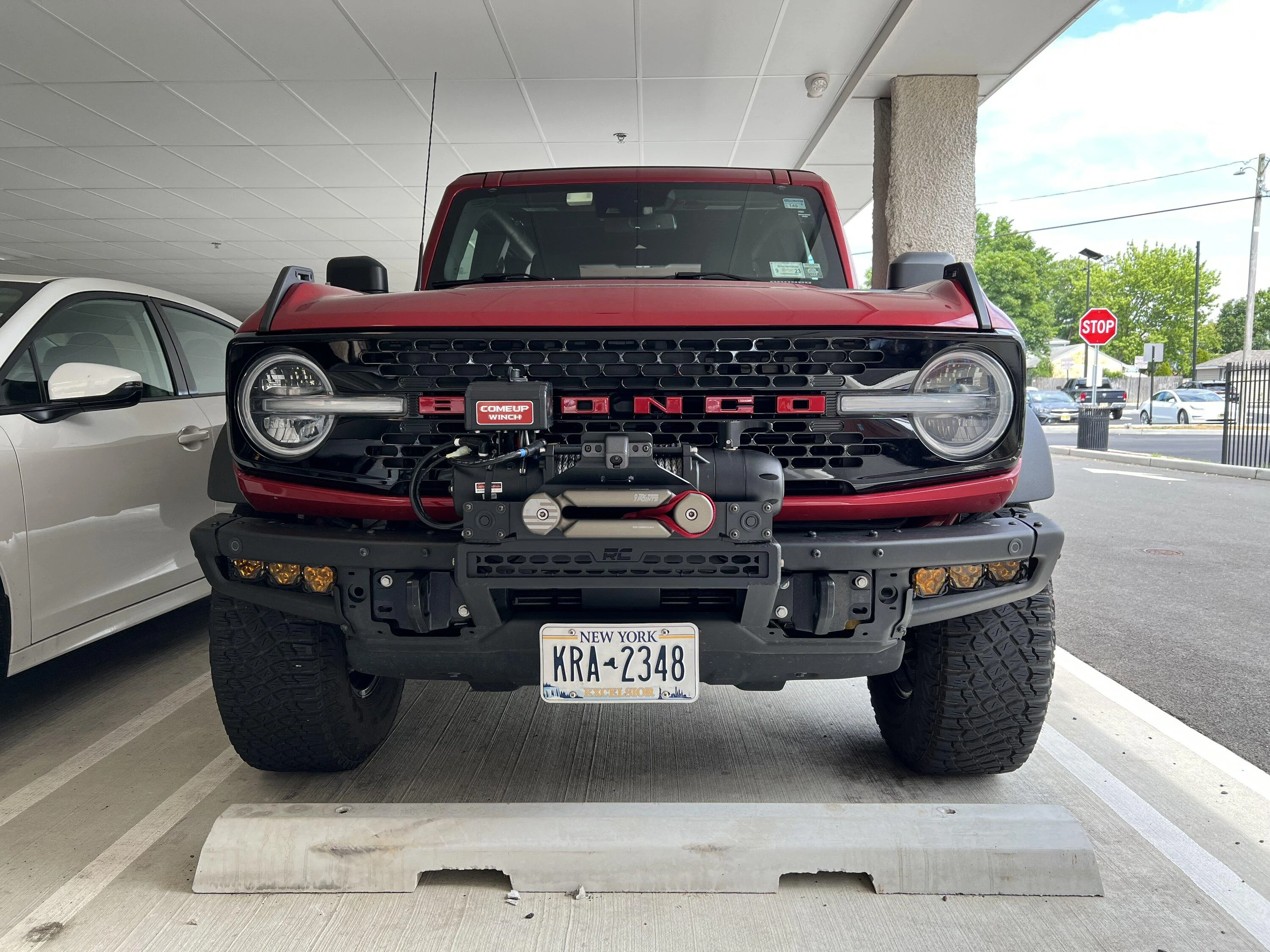

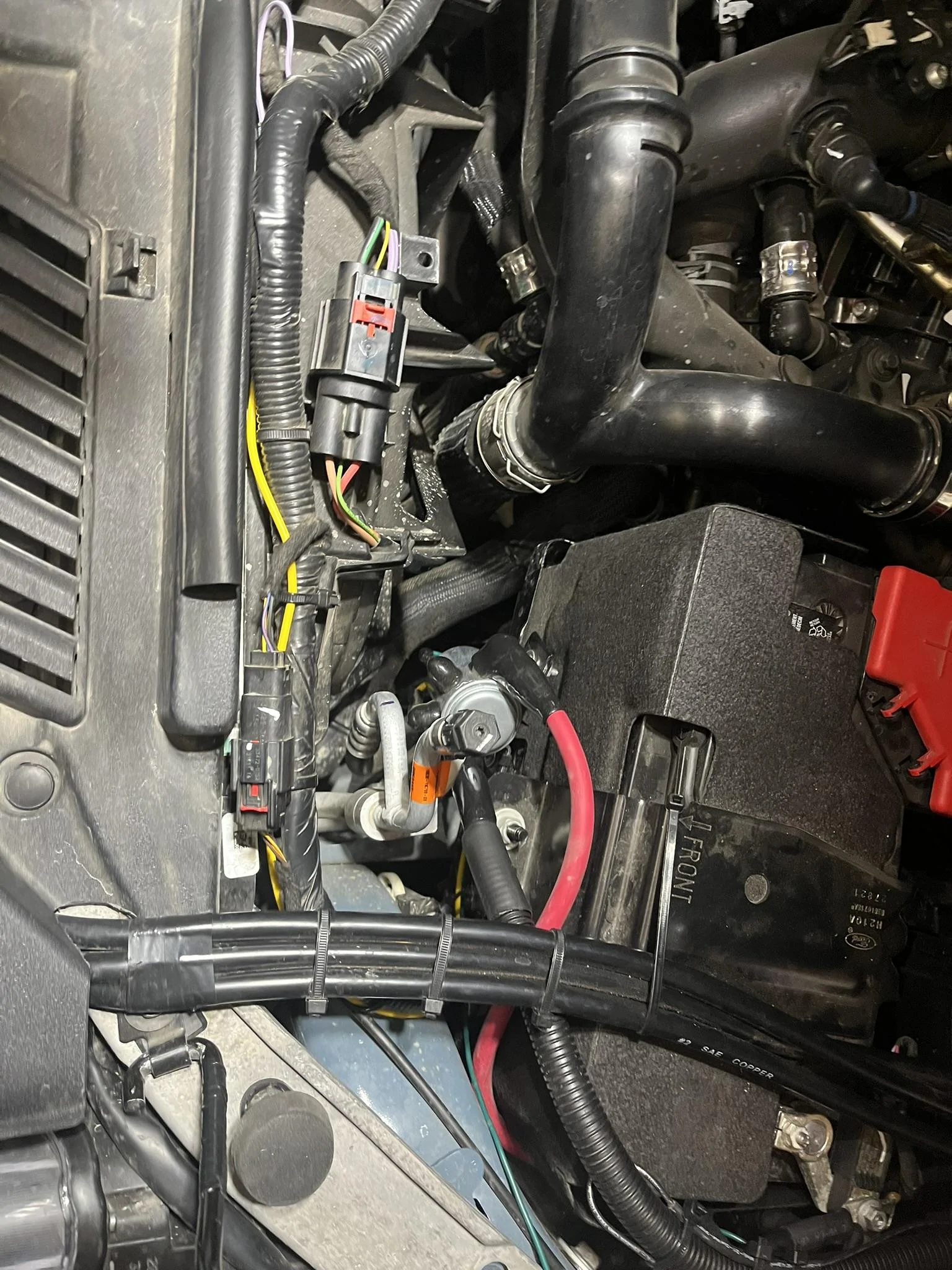

Been following and commenting on this thread for a long time and finally able to post my finished product. Over the month of December, I got my winch all mounted and control box relocated. I put the contactor into an amazon project box mounted on the fuse box. I decided to save the rubber stopper to cover the plug port and attached it on the outside of the box facing the dash. As you can see, it's easy to remove the fuse lid to access the fuse box if needed. I attached the power interrupt solenoid to the front of the battery box and tapped it to the pre-run aux wire at the top of the radiator. I had to order a longer cable than the one that came with the interrupt kit and ran around the battery box to a 90 degree lug I crimped on and attached to the buss bar. I shortened the factory red cable from the contactor to get rid of excess cable in the engine bay and ran it right to the solenoid. The contactor and battery cables all come out the front of the box to allow the whole box to be folded down out of the way and I zip tied everything up to keep it neat and tidy. I don't particularly like the contactor cables going over the battery but I didn't have enough length to run them around. They aren't touching the terminal so I think they'll be ok and shouldn't melt and arc to the terminal under heavy winching load. Any electrical guys who know more please let me know.

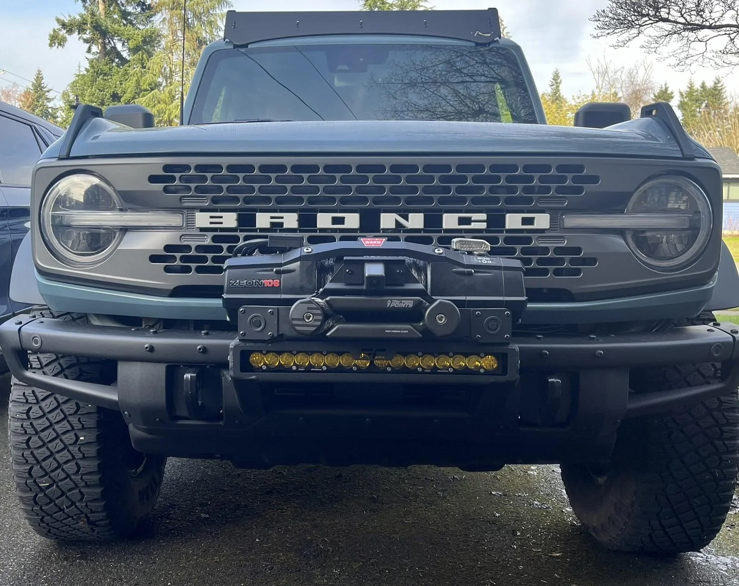

This week, I finally got around cutting off my thimble and to swapping out my Warn fairlead for the Yankum Grooved fairlead which provides the cleanest look and least metal in the system. Re-splicing an eye in the synthetic rope is alot easier than you'd think. The flat profile without a winch hook/shackle/knot means my front camera views looks 100% stock on the screen and works perfectly. The Warn Zeon has a good taper to it so I didn't have to mess with the sensors at all to get them relocated on the RC mount and they work perfectly too.
Overall I'm really happy with how this project turned out. Maybe down the road I'll add perch collars to level up the front but there is not much sag and when I'm loaded up with people/gear it looks pretty level. Thanks to everyone in this thread for the inspiration!
My parts list for the winch build out is the following:
-Rough Country High Winch Mount
-Warn Zeon 10s
-Tricky Motorsports Frame Horn Reinforcements
-Baja Designs S8 20 inch Amber Lightbar
-Turn Offroad Front Camera Relocation Bracket
-Warn Winch Control Box Relocation Kit
-Warn Power Interrupt Solenoid
-Yankum Grooved Fairlead
-Cheap Amazon project box linked 40 times in this thread previously

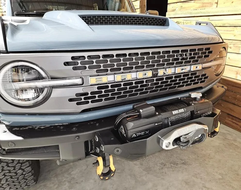

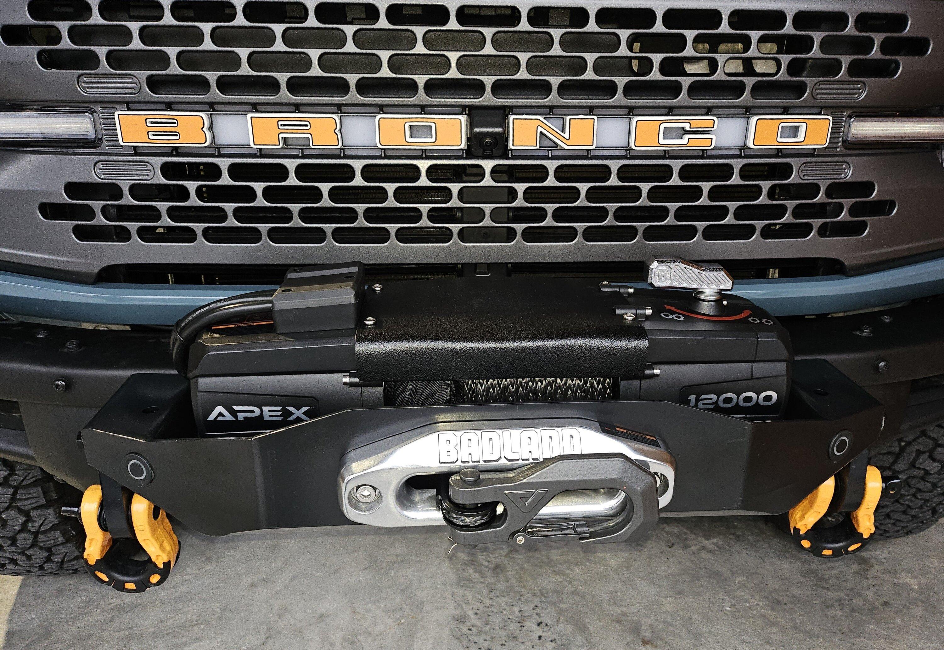

Just finished install yesterday.
I like the plate to cover and protect the rope from the UV rays. I installed mine a few weeks ago and used what I had laying around which was a sheet of ABS plastic. It's funny since I hadn't seen anyone do that before . I plan to re-make my cover out of metal when I get the time.

I had a piece of aluminum tread plate laying around and decided to make the cover out of it. I just thought it looked better than being open on top.

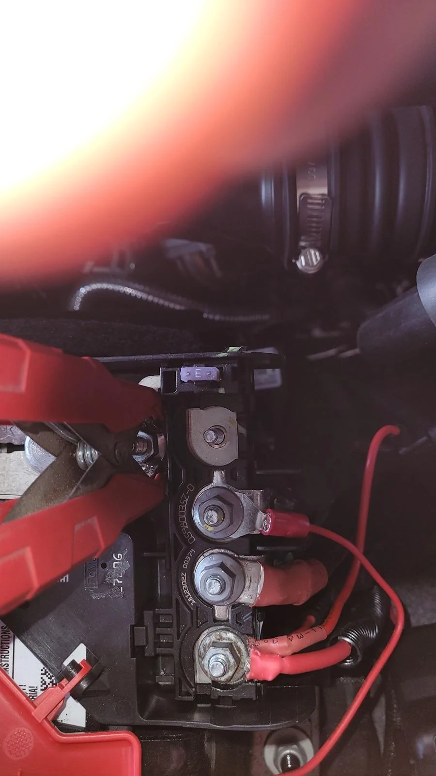

Where exactly do you hook up 12 volt positive on battery? I see there is a 3 amp fuse on the corner. I'm hoping that doesn't protect the 4 studs to attach things to! So far I haven't found sny information as to what this fuse protects.
Any should be fine
It’s the fuse for the battery monitoring sensor.
