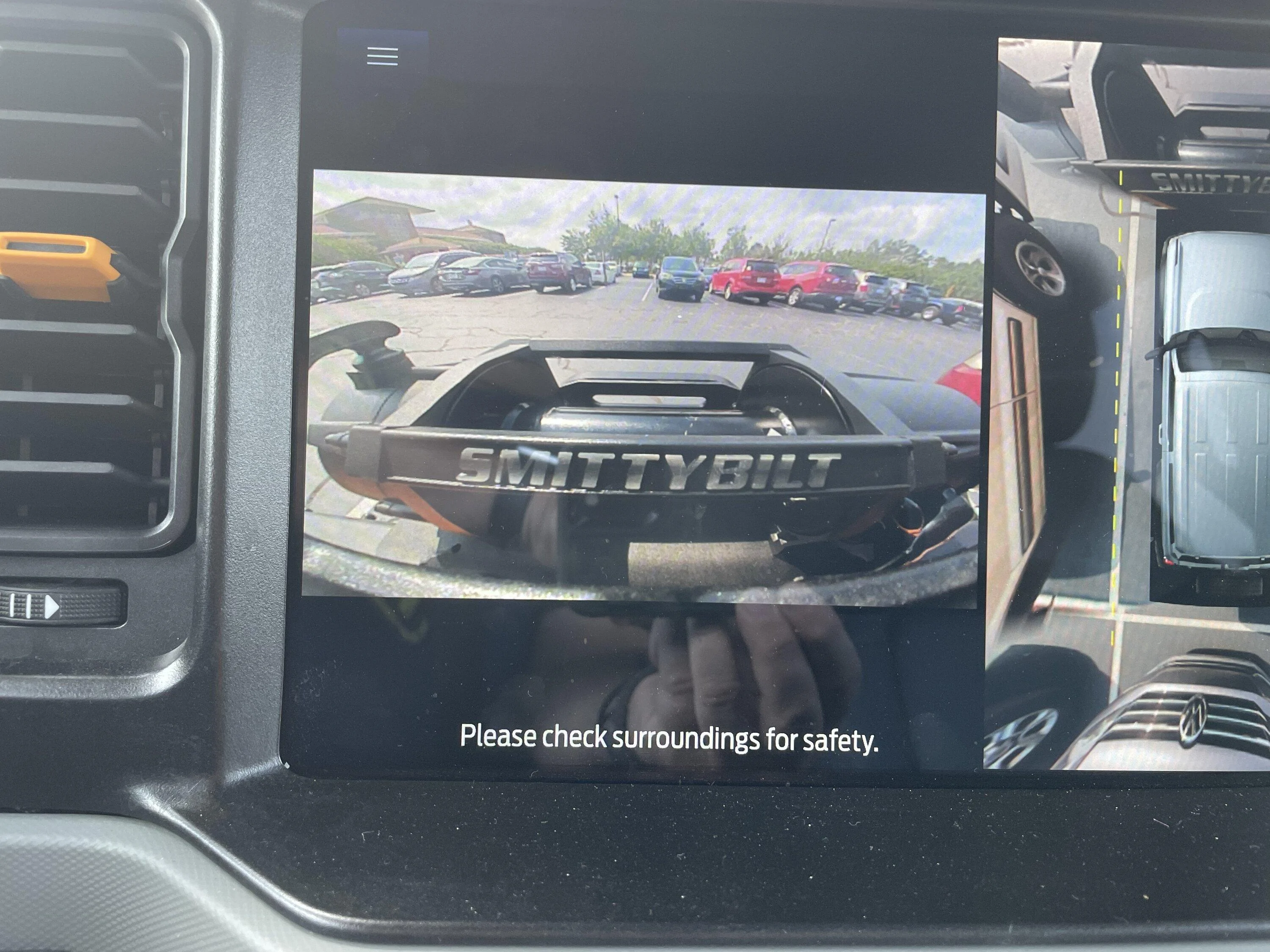

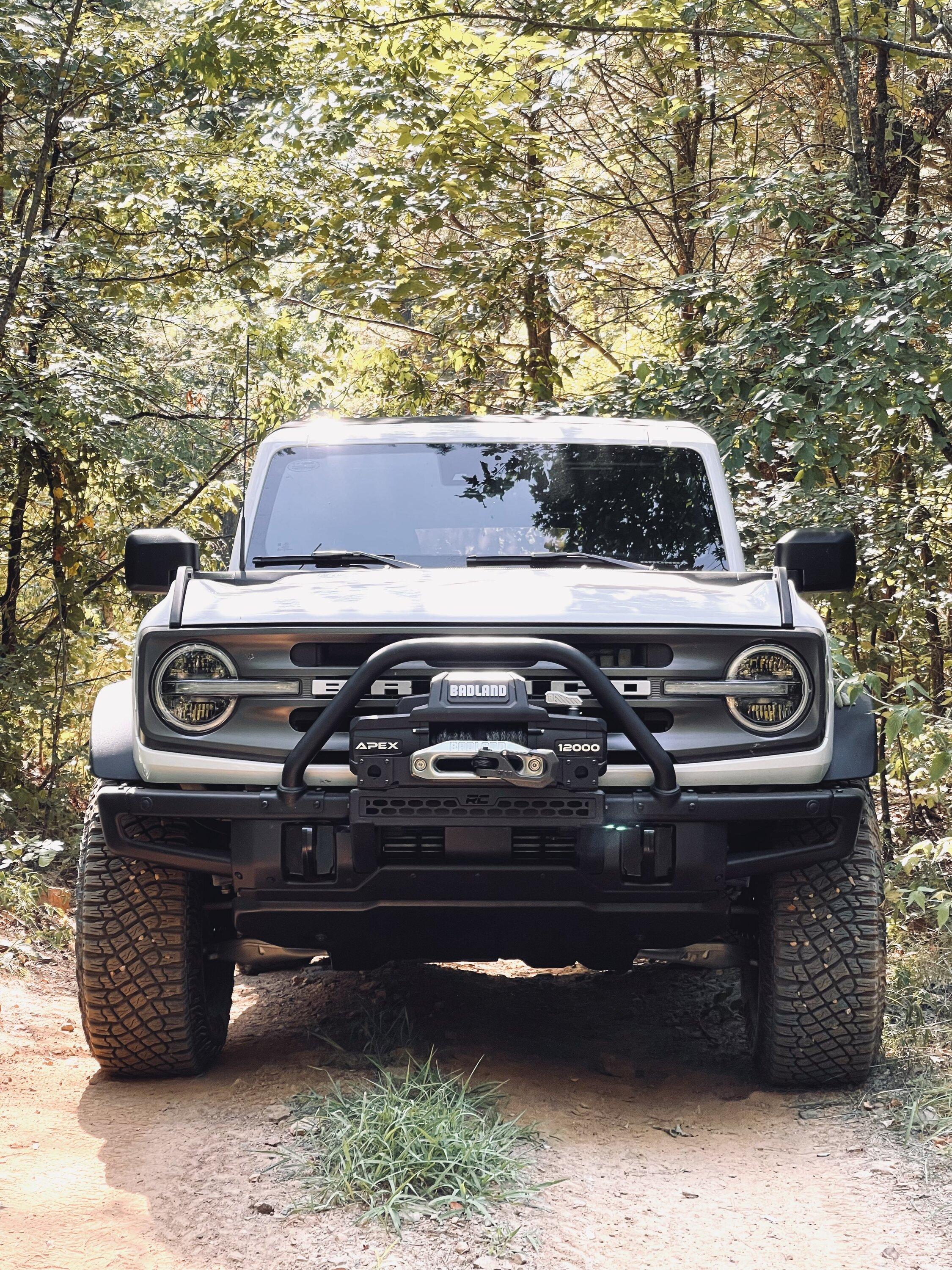

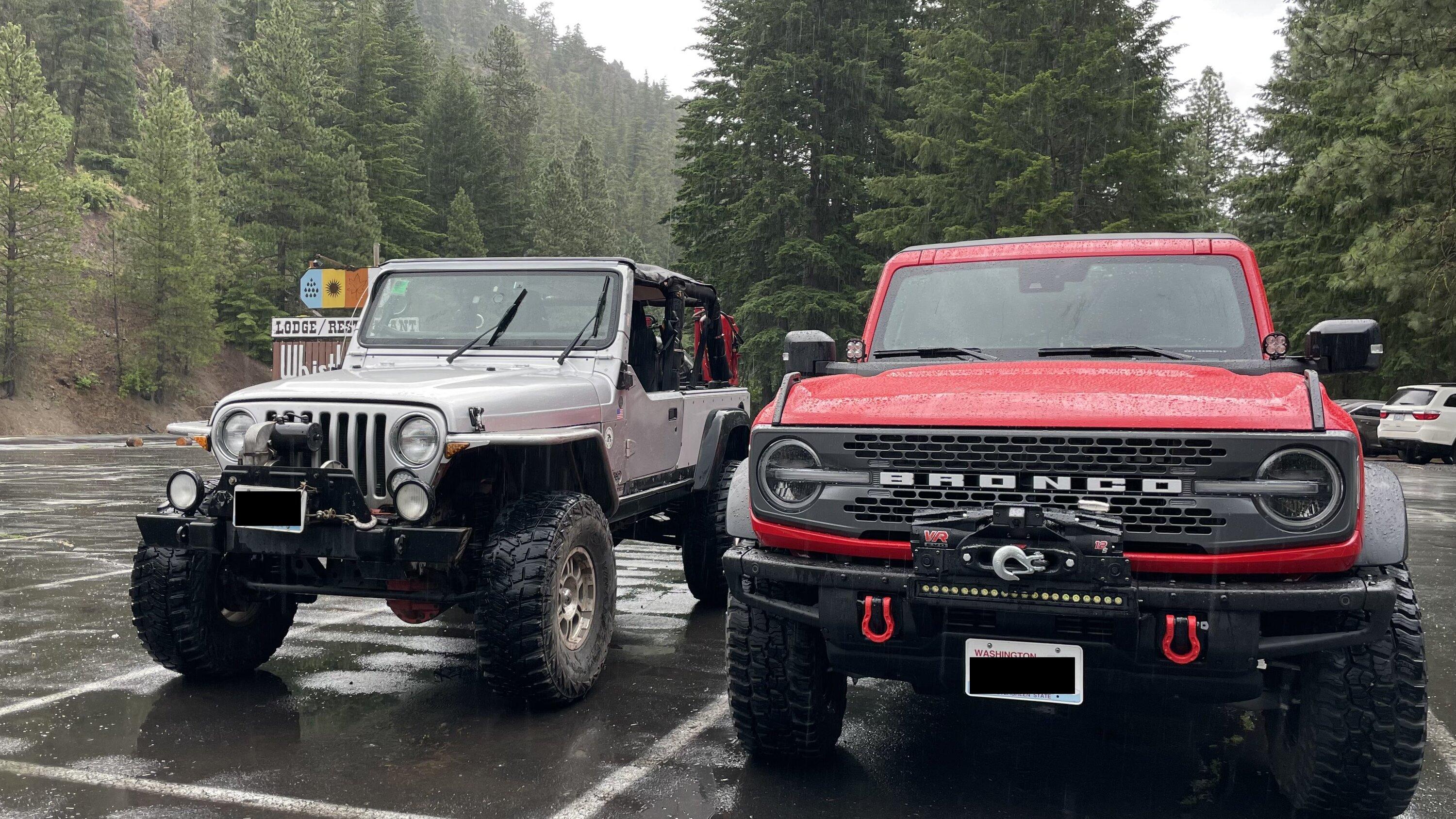

Well, I take back what I said, I'm digging the setup. Granted, I haven't gotten to actually use the winch since I haven't gotten stuck, so I can't speak to the strength which is still my concern. JCR bracket, BAFM control pack, KR Offroad Front plate bracket make it a clean install. JCR view is perfect and ACC still works.

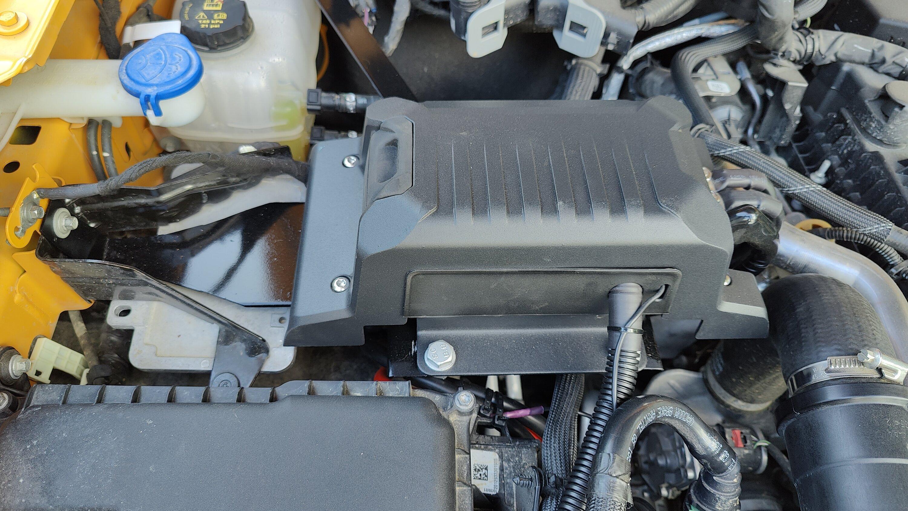

Very nice setup! Just finished mine up over the weekend, I relocated my control box to the passenger side since I don't plan on running a compressor. I ordered a JCR camera bracket as well, hoping to see that soon.
Details on the switch bracket? I mounted my apex winch but haven’t found a good way to mount the switch. Yours looks good.

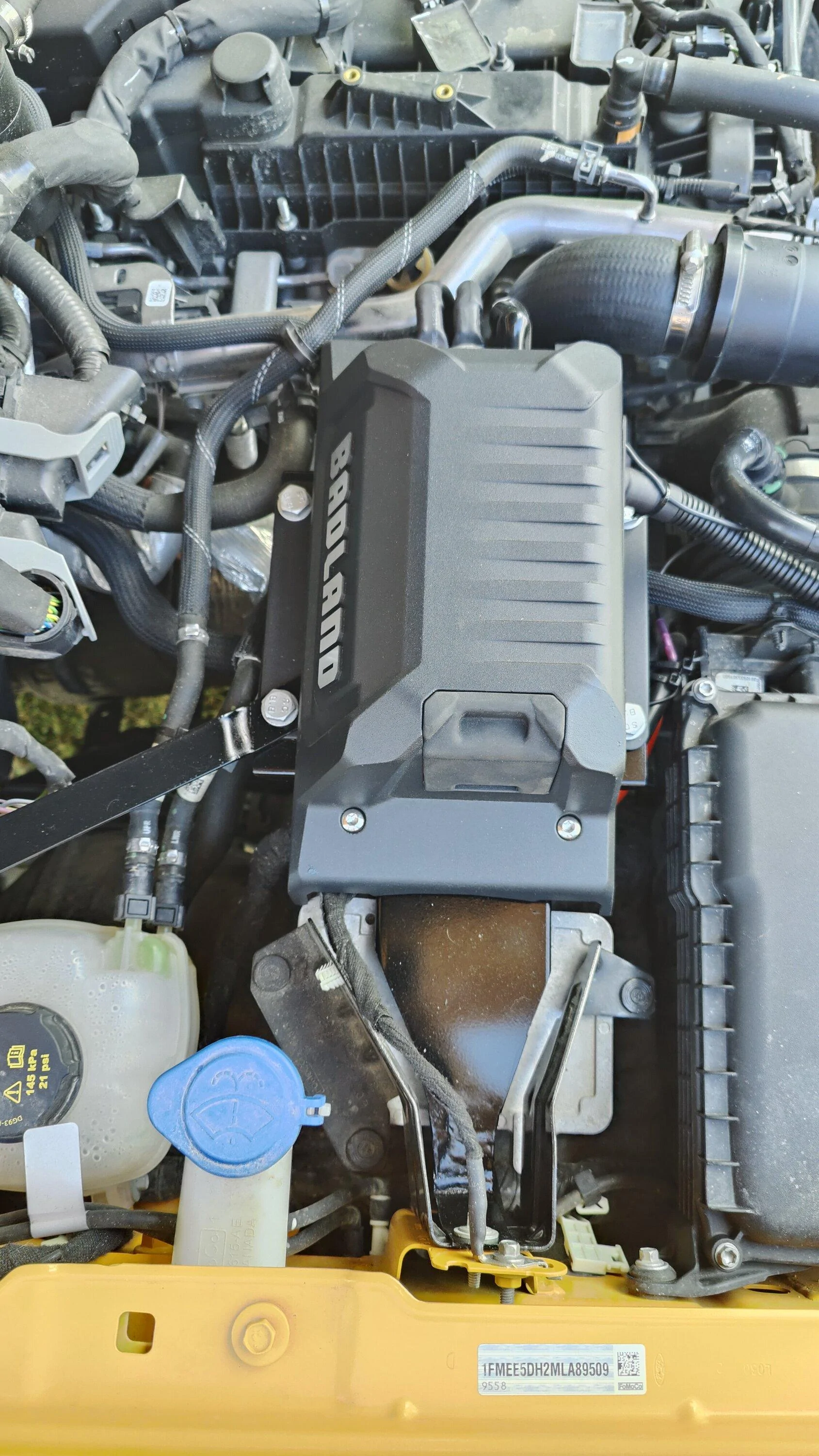

Nice job with the control box... that damn thing is huge. I ended up taking it apart, reconfiguring it, and printing an enclosure for it.
Ford Bronco RC High Winch Mount & Winch Install w/ Control Box Relocation 20220703_114258

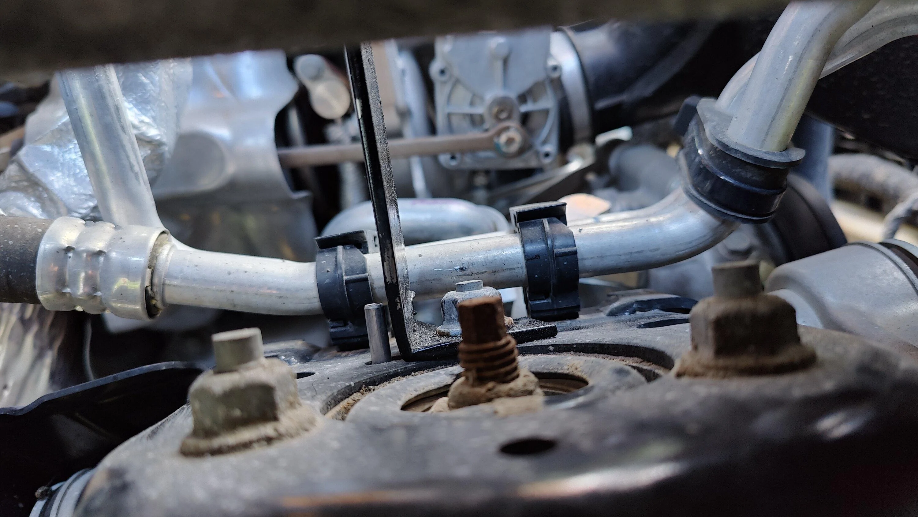

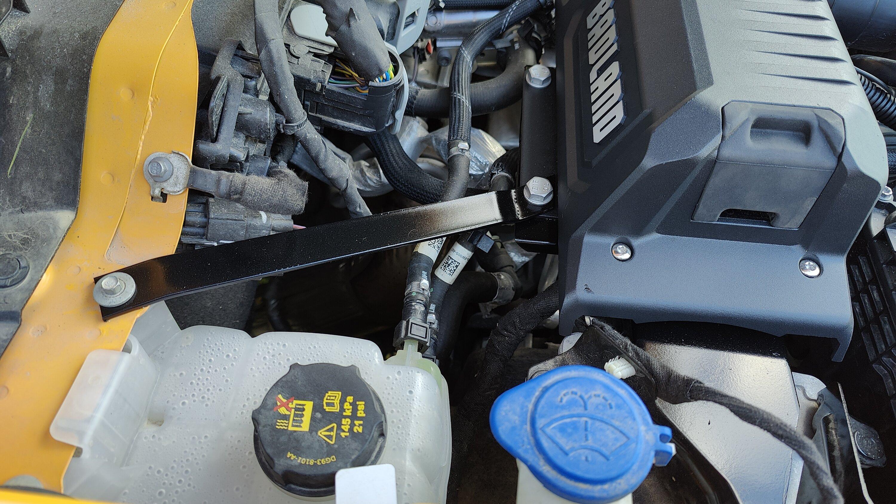

Homemade bracket, cut and welded out of some scrap I had laying around. I copied the basic design of an ARB compressor mount, made a support to the firewall, upper coilovers bolt and to the passenger fender. It's not the prettiest but it works. I didn't take any pictures of the bracket by itself but I can try to get some better pictures of it installed.
Do you mind me asking what you used to relocate the solenoid pack on that winch?
I have the same Apex waiting to be installed here, and should have a winch mount in my hands by end of the month, so I'm starting to actually plan this installation...
Vellicate
James
Feb 23, 2021
117
372
2018 F150, 2014 Flex Limited
The Apex winch will include most everything you should need to relocate . I made my own bracket out of scrap steel I had laying around. My winch came with 3 ft cables to go from the winch to the control box, which were too short for where I needed to go. I was able to find 6 ft 2awg cables that worked out pretty well. Others said you might be able to have the cables made at a local auto parts store.
As far as the bracket goes, I didn't really make a template, just measured and fabricated as I went. I did use the design of the ARB bracket as inspiration. Others have just taken the guts out and put them into a waterproof electrical work box as the Apex control box is unnecessarily huge.
If you have any more questions, I will try my best to answer. Have a good one

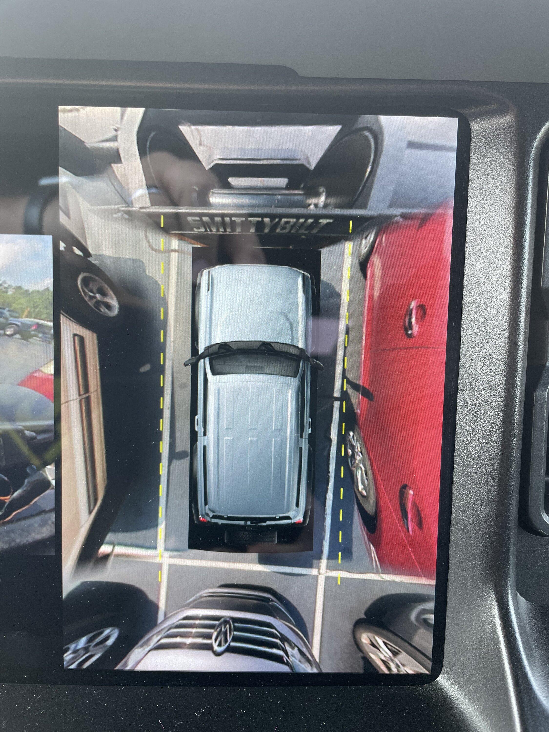

This is the view fro the camera. Finally took some.
