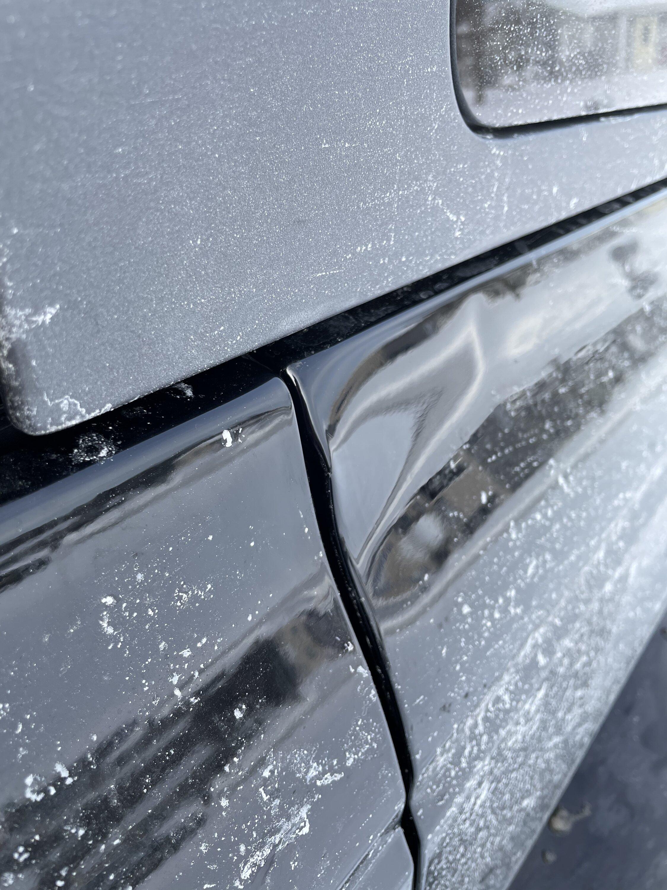

Hard top? I had a loud pop occur a few weeks ago and couldnā€™t figure it out until I noticed this (pic below, behind driver side rear door). Was driving on highway and guessing the top stressed the bolt too much that secures the hardtop. Dealer canā€™t get me in until 2/27, which is ridiculousā€¦
Yes, a 2DR hard top. This involved a very definite rocking of the vehicle, which I can see being caused by something drive train-y, not what I would expect from a stress dent or panel giving but I should expand search outside the rear area.
