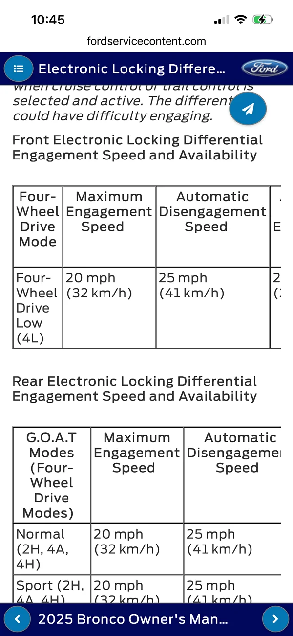

The Bronco front locking differential can only be engaged when you are in 4 low. And traveling below 25 mph.
So you need to be in a pretty gnarly situation before you could take advantage of it.
That bit of info may impact your decision.
Depending on the goat mode being used, the rear locker has different maximum engagement speeds. (No limit for Baja, 4L Rock Crawl, and direct selection of 4H (off road).
Yes and no. If you add the front locker yourself there are no restrictions. And the rear can be used in 2h or 4A. So if I was driving in a blizzard, which actually happened back in April in a mountain pass in CO, I have both available.
And as for the OP, if he was stuck in snow or helping someone else get out of snow, it wouldn't be unreasonable to shift to 4L to do it.
