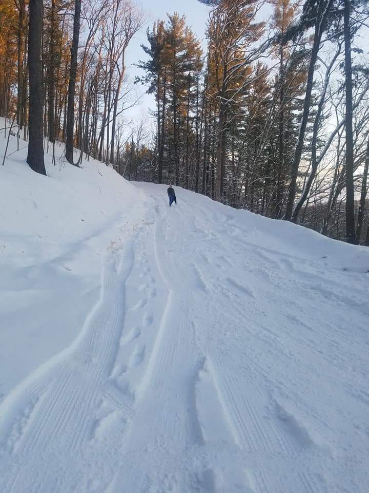

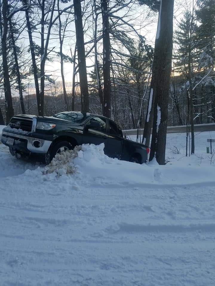

Honestly most owners will rarely ever need the front locker. But when you do, it would stink to pull winch line when you could have pushed a button. I bought mine knowing I wanted both lockers. My use is daily in the winter.
I did have a hairy situation one time in my Tundra. Came down said driveway backwards and ended up in the ditch. Took the JD 450 dozer to pull it out! The loaded Bronco was my answer. It has yet to disappoint.
