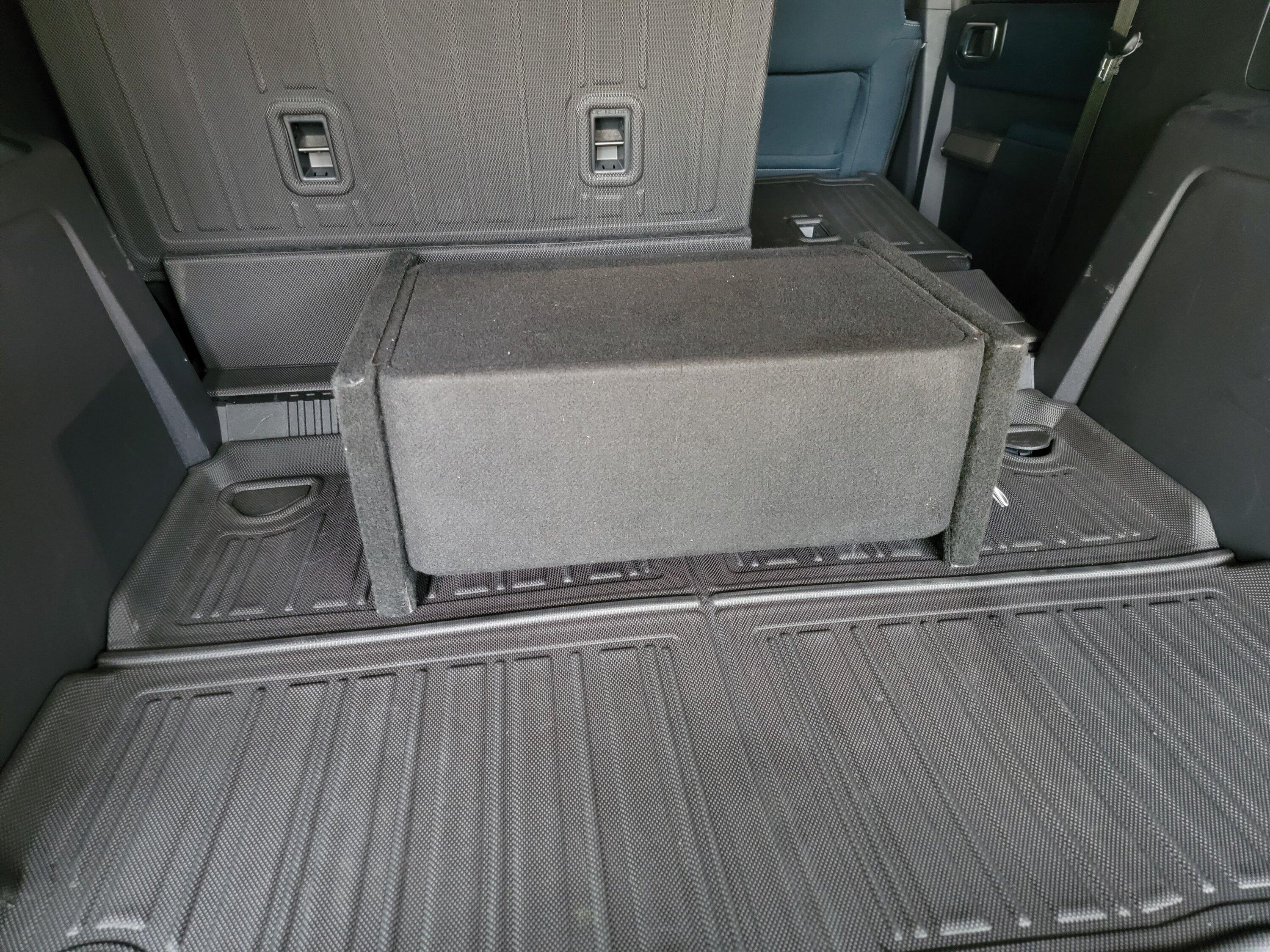

With my B&O so far I've swapped all stock speakers to JL C2 6.5" component, 4" coaxial dash corners, PRV 4" mid for center, and Kicker KS coax for the rear 4" pods. I added a Kicker 12" solo-baric shallow sub in a down-firing box that is 21 x 13 x 9.5 tall, and a Kicker KEY500.1 amp. Clarity is better, bass is 100x better. No panel rattle because the B&O sub is disconnected. I do want to replace the DSP / AMP so I have control over the factory location upgraded speakers but at $1000+ I'm not in a hurry right now.
