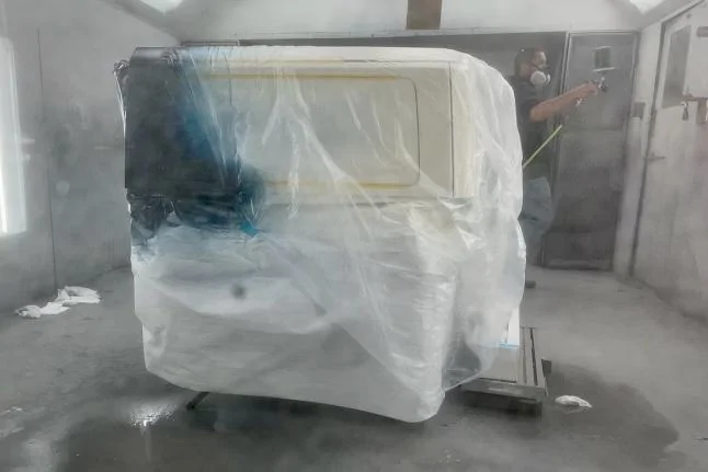

Another teaser shot from the paint shop. You can kind of see what we are doing with the top and the illusion of different body lines between the top and the front door area of the top. Initially we planned to use vynil, but instead I made some carbon fiber panels that are bonded to the top.
I'm getting anxious to see the final product, I can't imagine how impatient you must be!

Following.. I have a 2dr velocity blue and planning the same scheme with the white 2 tone down the side and white top. Im doing vinyl as opposed to paint cause I want a little protection from scratches. Going to attempt vinyl on the roof but if it doesnt stick Ill paint it.
