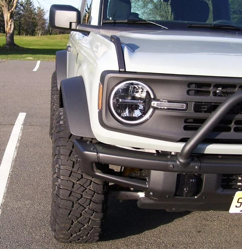

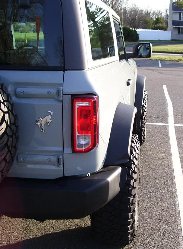

Here's a 35x12.5x17 tire on a 17x9 wheel with -6 offset with the Sas flares/suspension. I would go with the +1 offset, the -12 would be an extra 1/4" of poke over this.

Thanks for the pics, that looks good. I am thinking I'll go with the +1

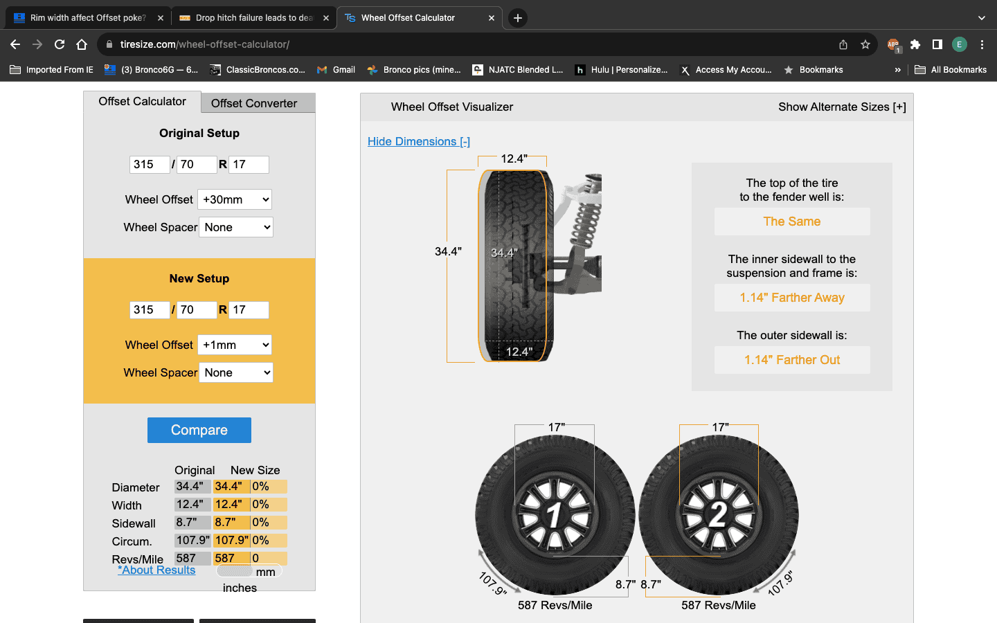

Wheel width has less effect than most realize when comparing offsets for poke.
Tire width and the amount of offset are the two biggest factors.
Tiresize.com doesn't even ask for the wheel width when it plots out the comparisons you input. I'll guess they are just assuming you are using a wheel approved for the size tire you input.
https://tiresize.com/wheel-offset-calculator/
Here's stock squatch vs the +1 you mentioned.
