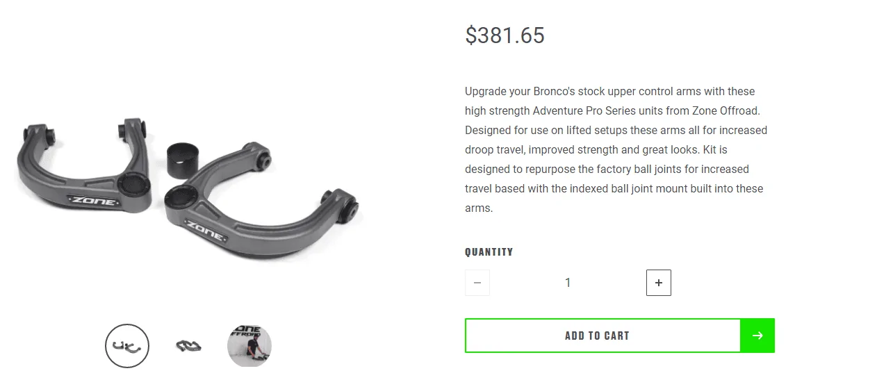

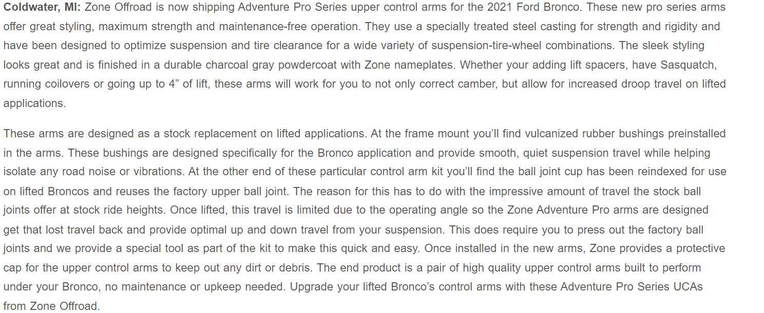

I agree, If you look at Zone Off Road's UCA it uses the stock ball joint. When I read your comment about the flex in a stock UCA it reminded me of the Zone tech article that made my decision on how to alter my Bronc......... when Ford decides to build it.😁
Ford Bronco Rock Crawler Daily 1650140096115
Ford Bronco Rock Crawler Daily 1650140249086
No bling just something that improves on what is there from the factory, because what came from the factory is pretty damn good. :D

Haha, It’s unfortunate because even that article is wrong. You don’t gain any real world wheel travel back with this arm or any aftermarket because it was never “lost” to begin with (lifted or unlifted) :ROFLMAO:
what I mean by this is, you will change your travel when you lift because you’re changing where the vehicle is starting its suspension travel from. 2” lost on the Down travel is another 2” gained on the up. However, with the bronco platform, an aftermarket upper control arm will not change any of this:p
pretty much everyone slinging UCAs know this but are choosing to ignore it
