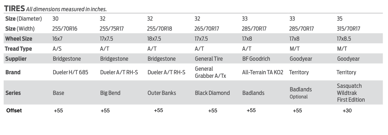

The difference in the tires is 2" and the clearance increase is 1". That's theoretical of course... Actual tire sizes do vary between manufacturers. And as someone that does quite a lot of heavy rock crawling, 35's are notably more capable than 33's.
If you are getting the lockers in the BL or WT package already, then the difference is there, but not nearly as big as not having the lockers.

Tire size does make a difference. If you plan to rock crawl go with Squatch - you'll be glad you did. Steering feedback is imperceptible between a 33 & 35. I actually think the bigger tires feel better on the trails - kind of like riding on marshmallows. On my EB, I went from 33s to 36s to 38s - each size upgrade made a huge difference in capability.

With the exact same tire but in the two different sizes, you won't be able to tell the difference on a 21' bronco with IFS imo on the road. Crawling, no difference either other than ground clearance.
