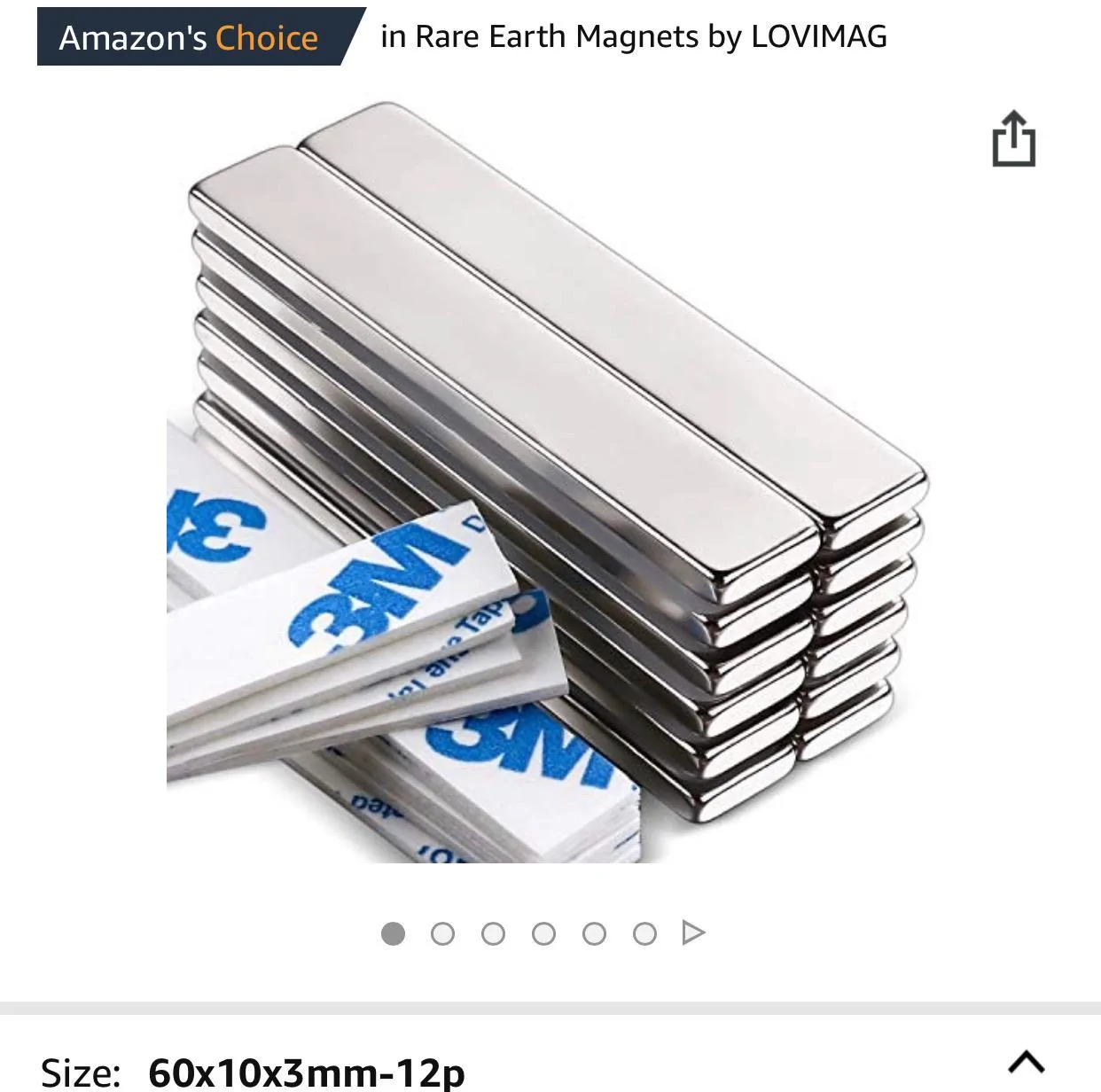

Got mine installed a couple weeks ago. Passenger side has worked flawlessly. Driver side has gotten stuck in the down position several times. The place that did the install said the magnetic piece in one of the doors was shifting such that it wasn’t consistently making contact with the sensor in the door jam. They re-attached it with some kind of adhesive and it worked for a few days. Now stuck again. Tried a few things but it’s still stuck. Not sure if this is an install issue, a mechanical issue, or a design issue. I’ll update this once I know more.
UPDATE: Now working again. Replaced all the magnetic pieces that attach to the doors with much longer magnetic pieces. Also used some adhesive to encourage them to stay in place. Here’s what I used:
Ford Bronco Rockslide Engineering Steps - GROUP BUY has started! F9726A27-7426-4B61-A6C0-0D976E03C484
