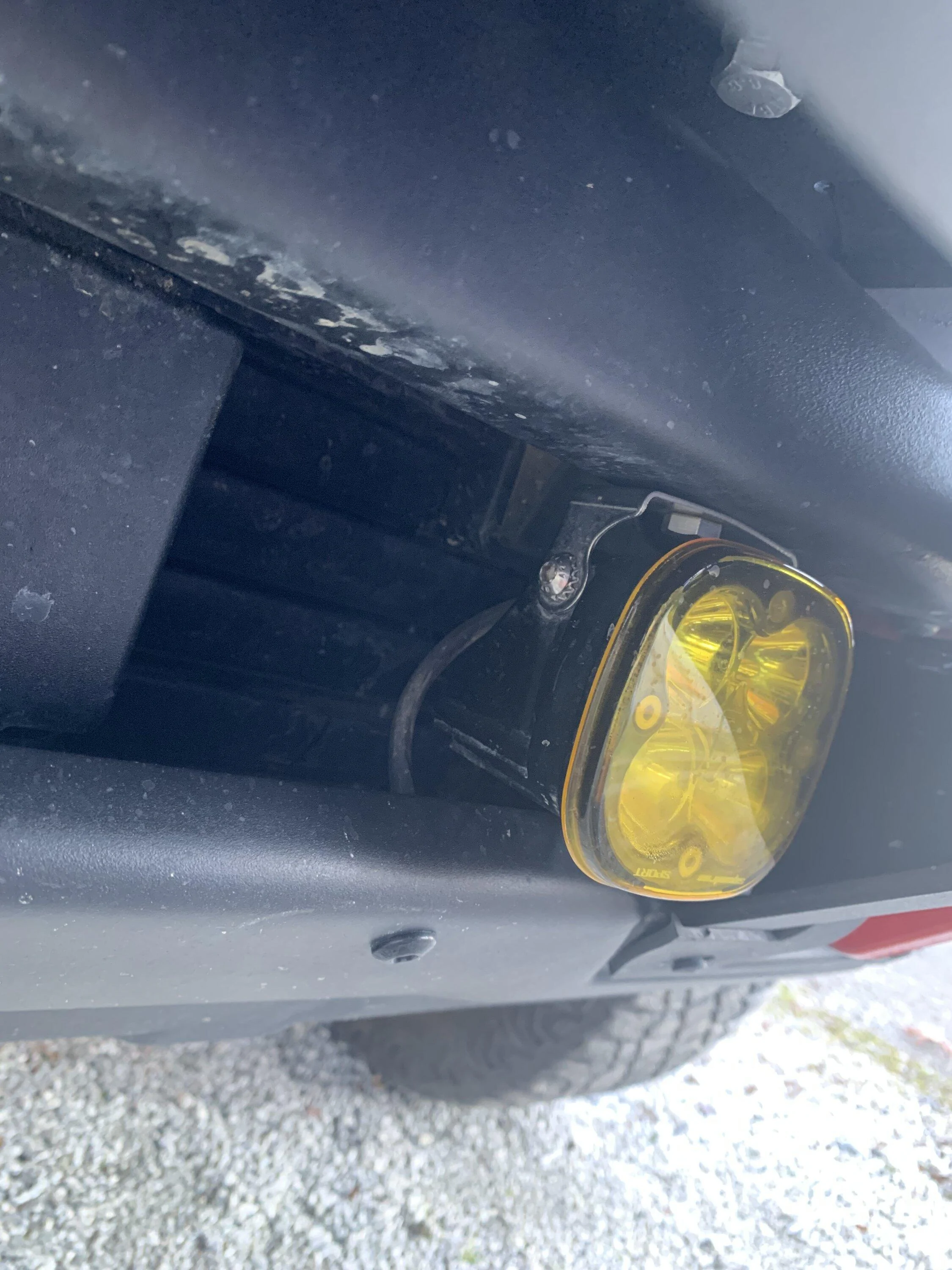

You mentioned a mounting system for amber low-slung lights.
I have 2 BD Squadrons mounted low, center of the bumper opening, on either side of the ACC block.
Now there are no Bronco bolts in those locations to readily do what I did.
It pained my soul to do it, but I drilled two holes on the upper radius fascia part of that opening and installed.
The holes are not seen nor exposed due to the shape of the bumper.
But it still bothered me to take a 7/16 (or whatever size it was back then) drill bit to a brand new vehicle.
They line up and shine out nice in that big RC mounting apparatus, are semi-hidden from view, and are protected now due to the mass of the mount and winch sitting on it.
I don't have a great pic on my PC here, but do have a few on my phone I can post up if you are curious.

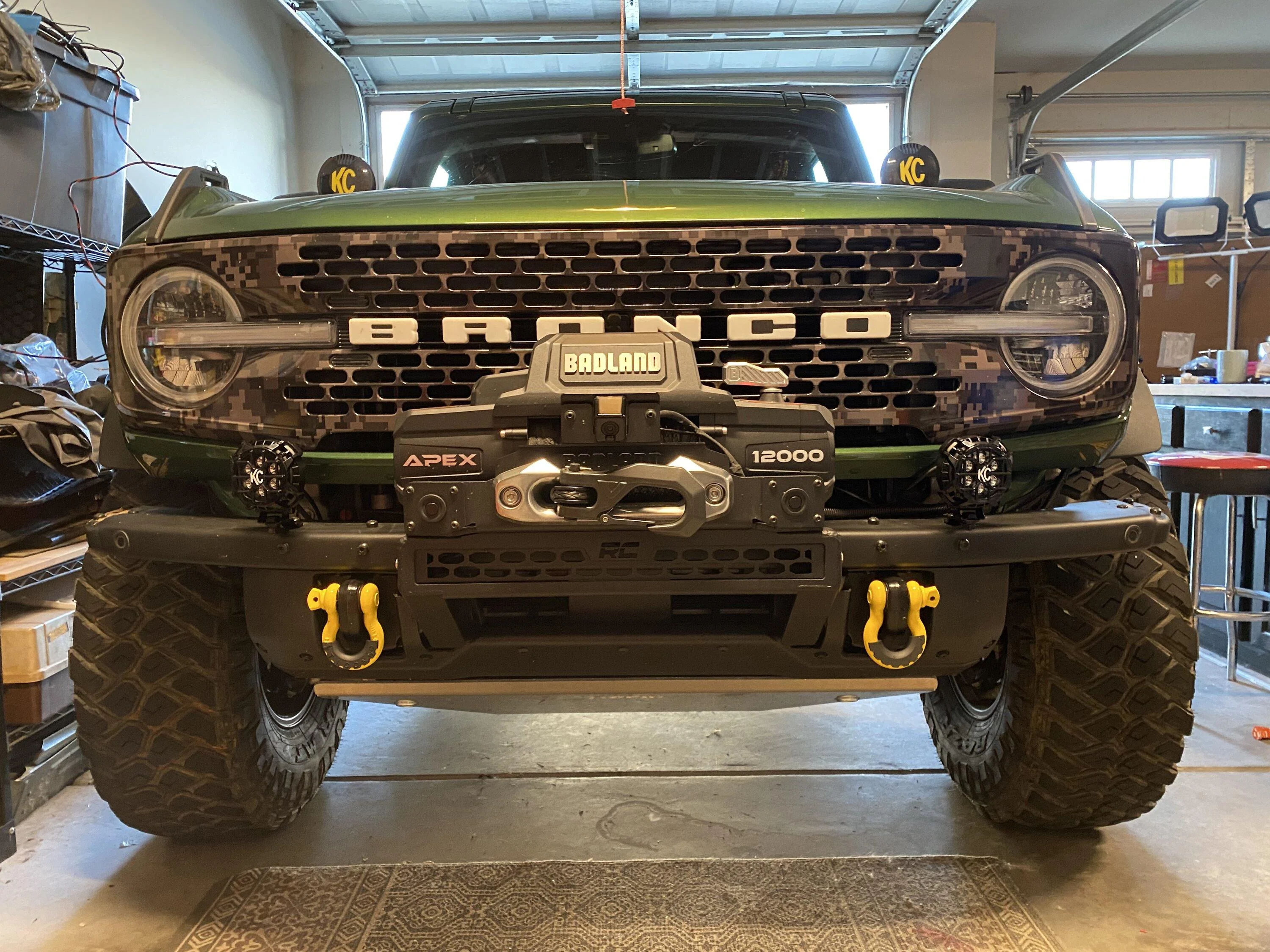

Ford Bronco Rough Country High Winch Installed VIDEO Small hill
Ford Bronco Rough Country High Winch Installed VIDEO Sand pit trail turn assist

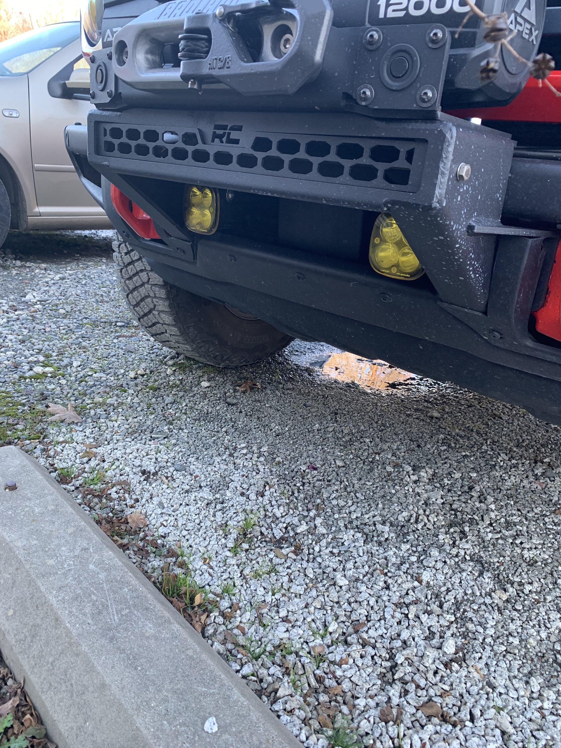

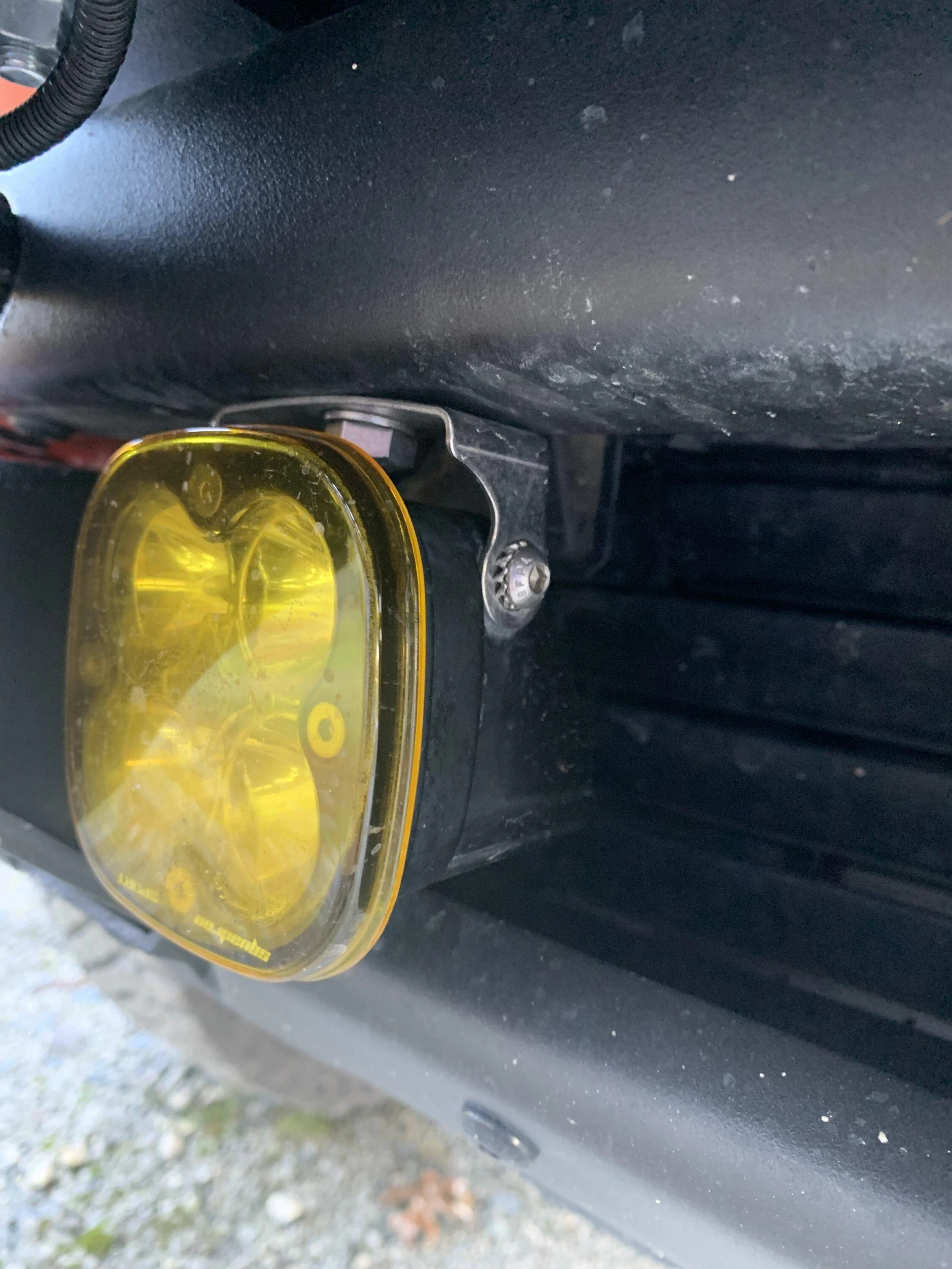

Here a couple I just took. Not super HD quality stuff but you can get the gist from it. A ratchet wrench is the ticket for tightening the brackets to the bumper, then the lights to the brackets.
