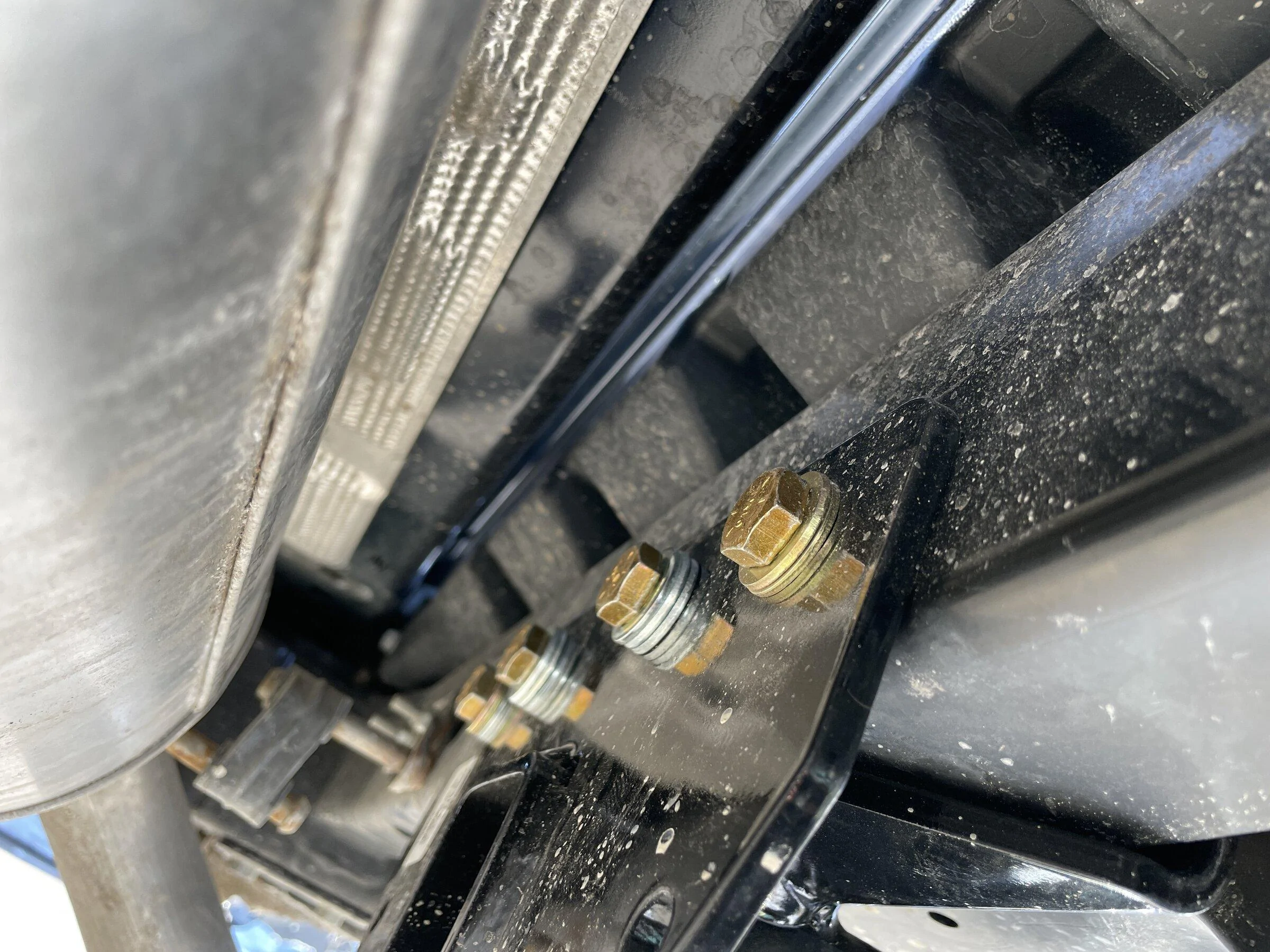

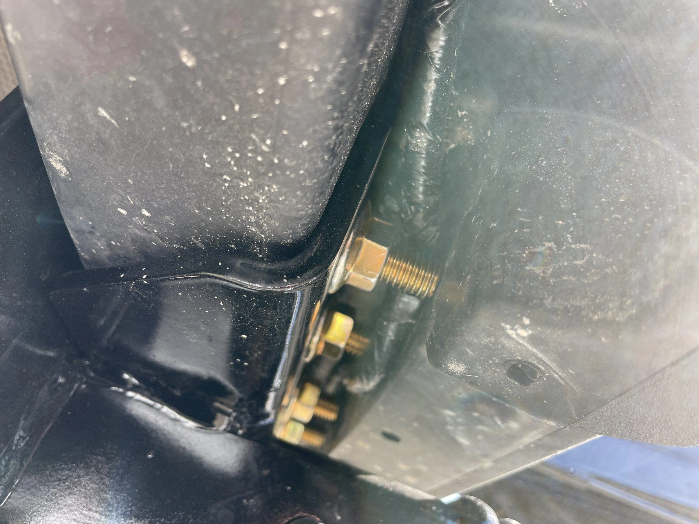

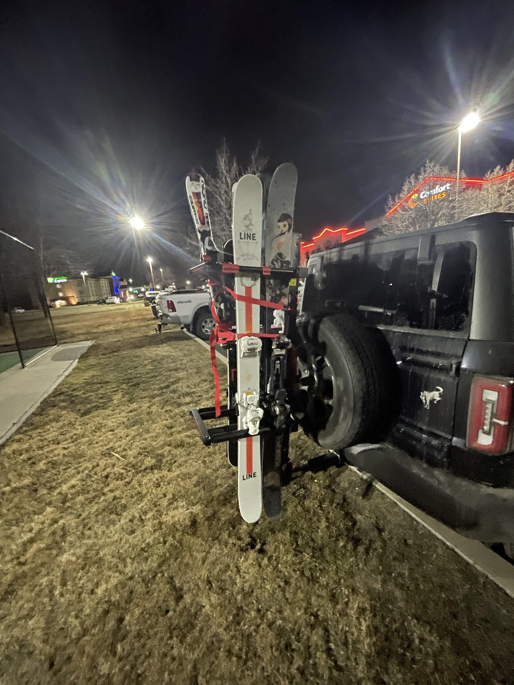

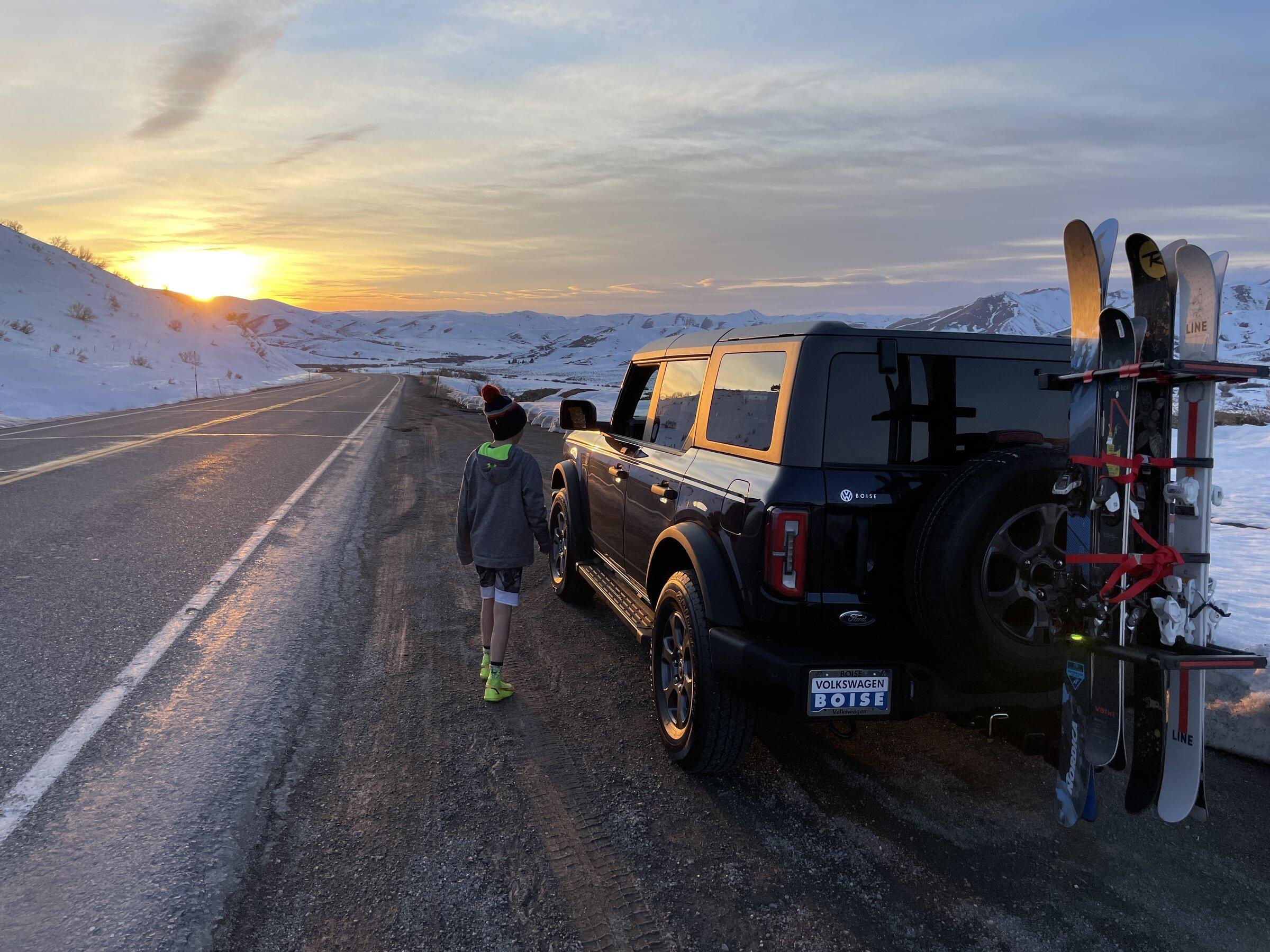

It's not an ideal setup, but got the job done. My family of 5 flew into Boise with all of our ski gear to pick up our 'used' Bronco at Boise VW and then did about a 1200 mile road trip back home to Colorado with this setup. I had all the parts delivered to the dealer and then installed the receiver hitch myself in one of their car detailing bays.

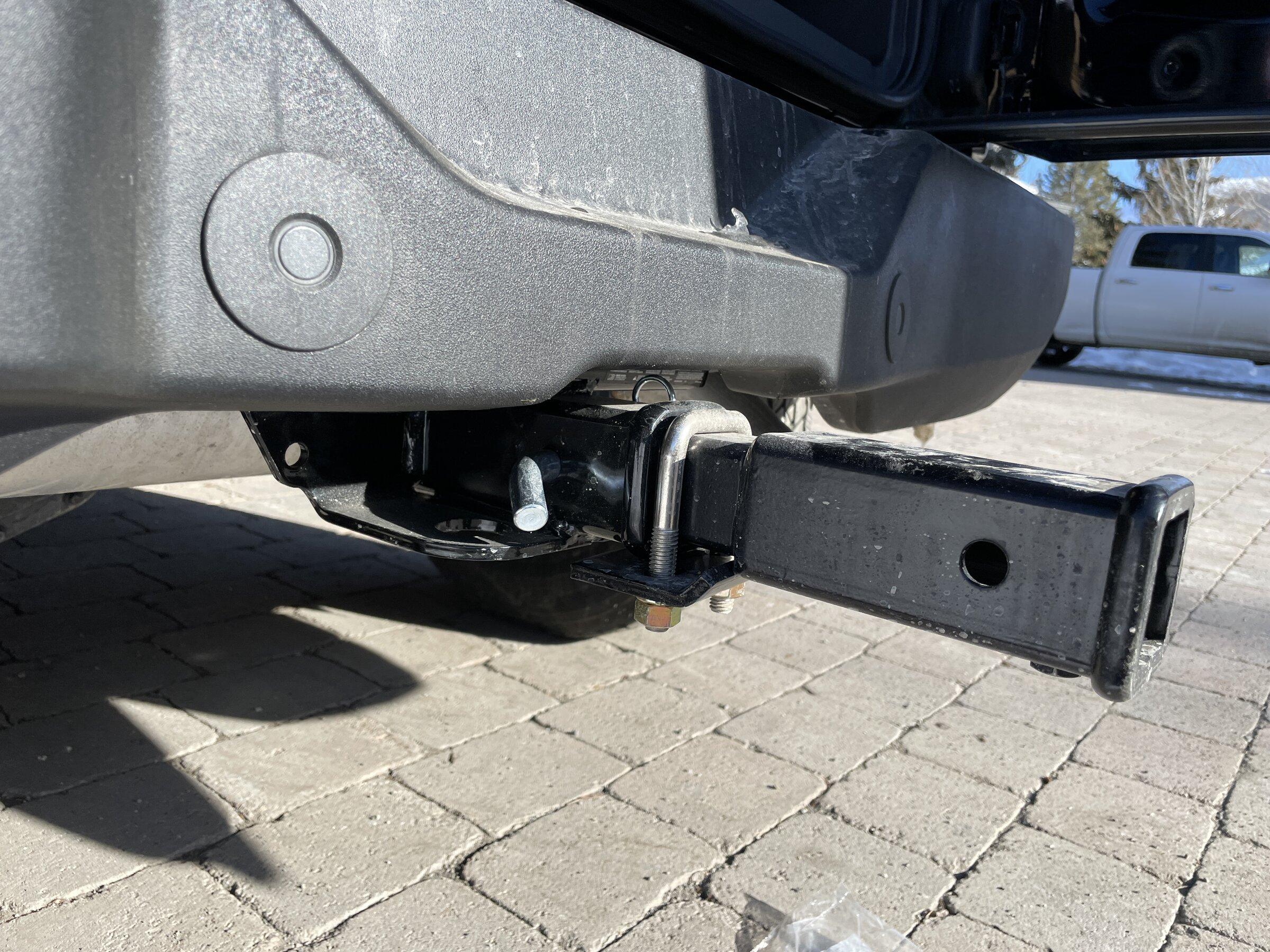

Found that the bolts for the receiver hitch are a little long, so purchased 8 additional steel washers (see photos). The ski/snowboard rack does tilt backward, but even tilted you can only open the rear door a few inches. When we needed to load/unload the trunk area we would just remove the ski rack which is very easy to do by yourself if it is empty, and fairly easy loaded with 4 pairs of skis...with two people. Something like the Kuat Pivot V2 would really enhance this setup.
Parts (no affiliations, just showing what I purchased):
Hitch - https://www.jegs.com/i/Curt/229/134...=Transactional&utm_content=Order+Confirmation
Ski/Snowboard Rack - https://www.amazon.com/gp/product/B081G7JJB2/ref=ppx_yo_dt_b_asin_title_o06_s01?ie=UTF8&psc=1
Hitch Stabilizer - https://www.amazon.com/gp/product/B07JDD8L3H/ref=ppx_yo_dt_b_asin_title_o06_s00?ie=UTF8&psc=1
Hitch Extender - https://www.amazon.com/gp/product/B09B6KQDSH/ref=ppx_yo_dt_b_asin_title_o06_s00?ie=UTF8&psc=1

How was the noise/moving around while driving?
Worried about the stability.
Thanks for posting.
Thanks for posting.
No noticable difference in noise or stability. We drove 70-80mph in high winds and I was surprised at how well the Bronco handled that even with the ski rack on there...some vehicles get pushed around a lot in those conditions. I do highly recommend the anti-rattle/stabilizer part, and the vertical bolt on the hitch extender really helps keep the ski rack from wobbling too much in the hitch extender.

Thank you so much for this! I've been looking for hitch solutions for my skis over a roof option since I might as well get some use out of the $500 hitch option. I'm also planning on adding a swivel so I can get the tailgate open to about 90 degrees so I can actually sit down in the car and put my boots on.

How did you guys feel about the usability of the hitch mounted rack vs a roof rack?
I have a Thule roof rack for snowboards from my old ride - Need to decide if it's worth getting the roof rack from ford and putting that on top (I have the MIC) or if this is a simpler solution
My preference is to use a roof mounted box for skis/snowboards and I was trying to arrange a roof mount option but couldn't find the Ford Roof rails for the hard top anywhere. There are a few aftermarket roof rack options our there for the MIC, but they are really expensive. Also not sure about clearance getting into parking garages using a roof mounted ski rack or box. We didn't have any issues with that with this setup...but it was close a couple of times.
Downsides of this setup are that you can't easily get in the trunk area, and the skis do get very dirty if the roads are wet/snowy.

Wondering if the bolts for the hitch were reversed, you wouldn't need the washers?
Followed the instructions from Curt to install the hitch, so they are installed in the correct direction. You'd have to take the rear bumper off to install the bolts going the other direction. Mine is a Big Bend with rear parking sensors, not sure if the other models could have slightly more room for the bolts.

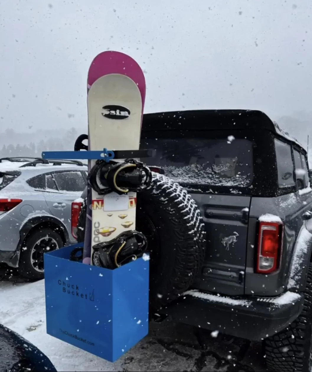

I bought this off a guy making them and advertising on Instagram it’s a Chuck Bucket. It works real nice especially untill
I can get a hardtop and throw a coffin up on top.

oh I like the Chuck bucket. How dirty does your gear get on the road? That’s why I’ve avoided hitch mounts so far. But this has promise it seems. Also like that you can toss poles in it.
I assume the swing out tailgate does not open? That accurate?

Tail gate doesn’t open but I did just buy a drop hitch and I think it will clear, just haven’t tried it yet. I’m in N East so tons of salt, gear gets a little battered but honestly I’m not bothered by it.

Which drop hitch did you get?
please keep us posted on the drop hitch solution. I've been watching the Chuck Bucket
