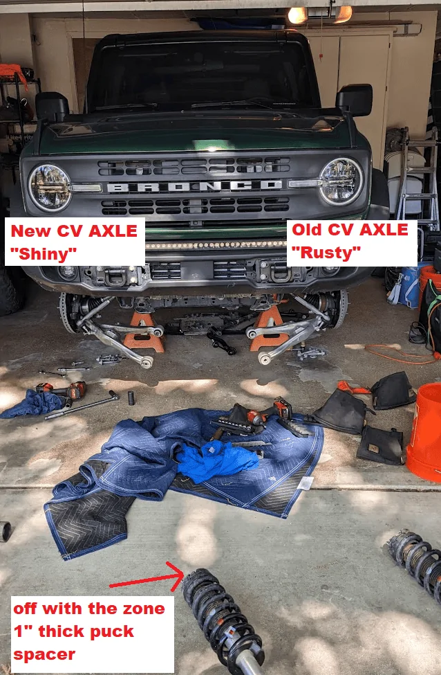

So today was fix a torn CV boot, install some Rough Country Bushings and add some @Metalcloak goodies on @Rob_Bronc91 Bronco. Please understand this normal wear and tear for offroading. The only real surprise was the condition of the driver side steering bushing.

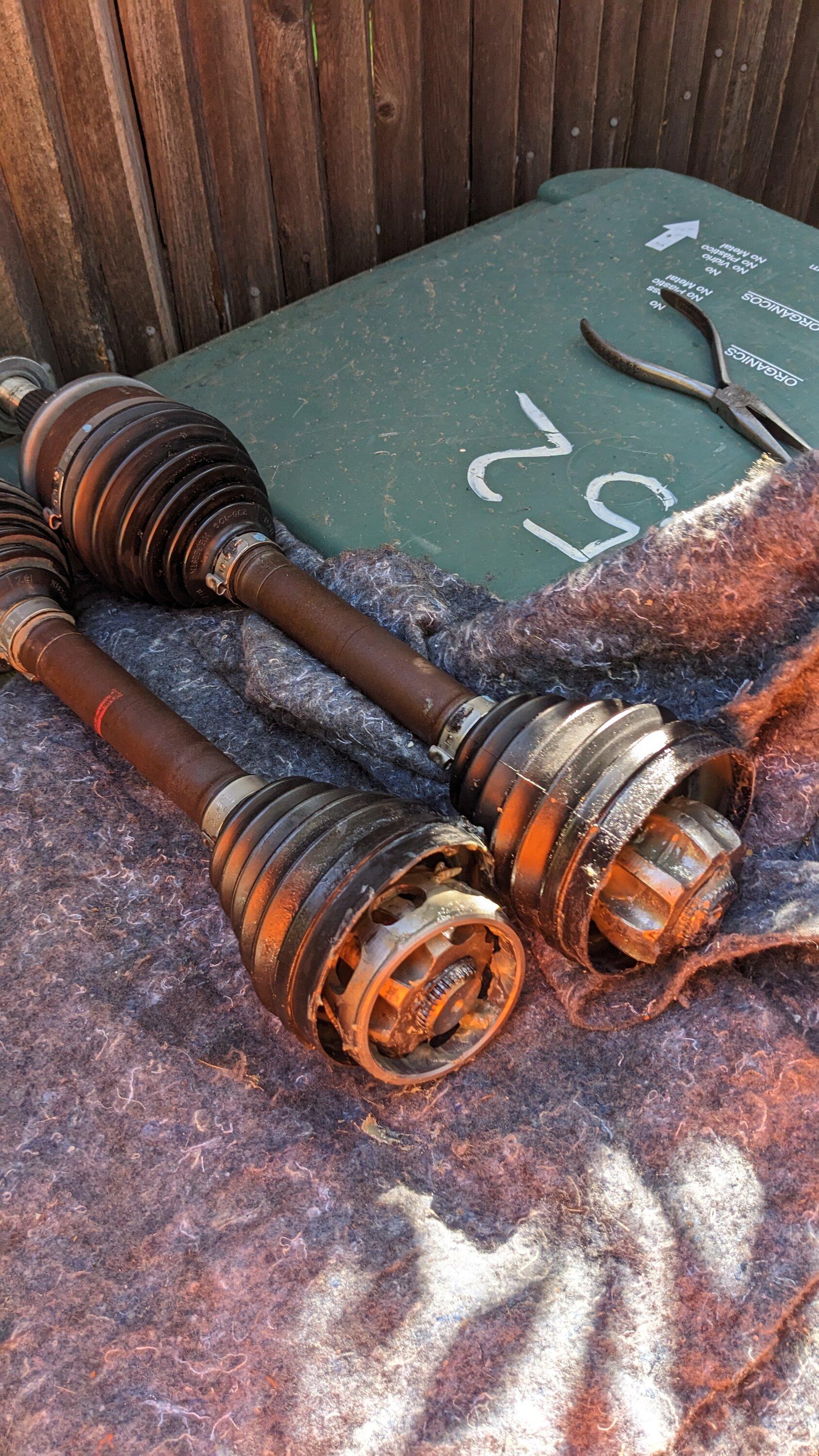

First up the blow CV boot. Definitely from an overextended axle. The hole was made from the inside from the retaining ring. Note M190 passenger and driver axles are identical except for the inner shaft section.
Ford Bronco Snacktime's Bronco maintenance starring someone else's Bronco (torn CV boot fix, bushings install, and Metalcloak goodies) PXL_20230607_162149725
M190 inner shafts, Drivers side is shorter
Ford Bronco Snacktime's Bronco maintenance starring someone else's Bronco (torn CV boot fix, bushings install, and Metalcloak goodies) PXL_20230607_162126233
The torn CV is the one with the bearing cage had just a small 1/2" hole. We stole the boot off my broken CV axle to save a trip to the stealership.

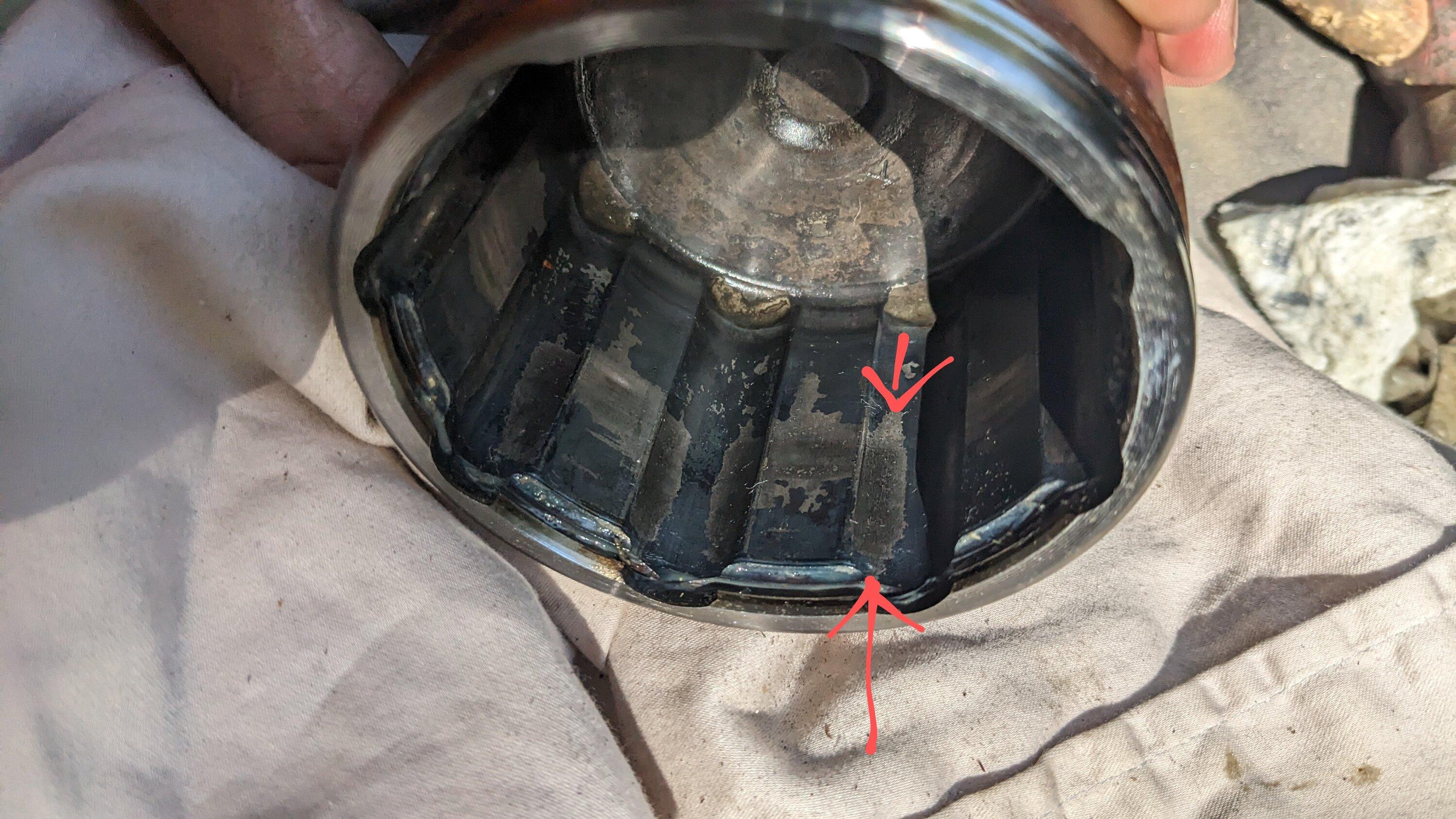

Treasure! This is the wear inside a CV in a Bronco with Hitachi shocks and 2" Zone lift. Look at the wear location near the outer surface. You are pretty much at max extension before you even get binding. I believe this axle was over extended and the outer snap ring came off and poked a hole in the boot. This is literally what everyone considers a safe lift.

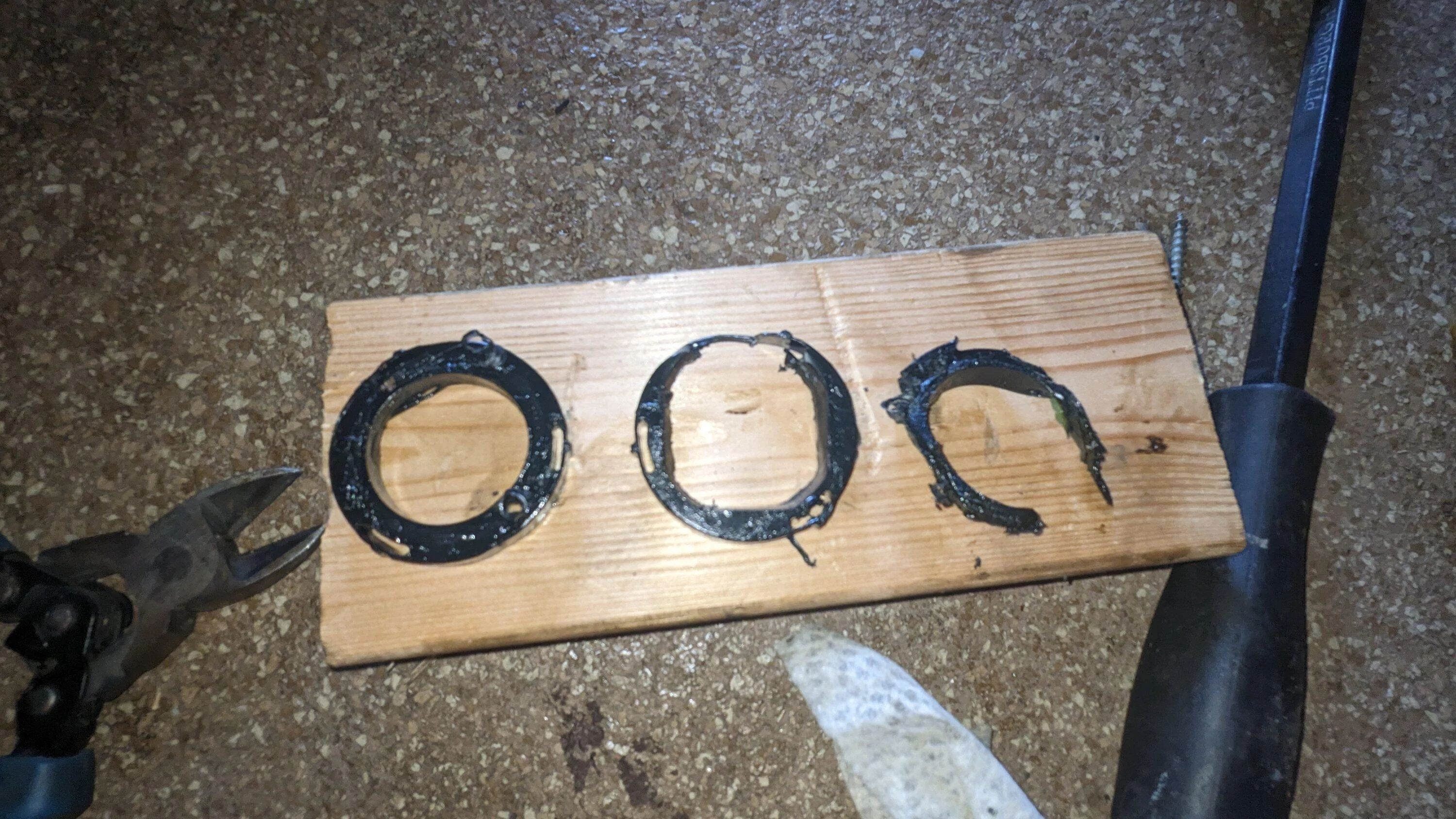

Drive side was $&@# into 2 pieces! This is with 35s and stock steering.
Ford Bronco Snacktime's Bronco maintenance starring someone else's Bronco (torn CV boot fix, bushings install, and Metalcloak goodies) PXL_20230607_175604694

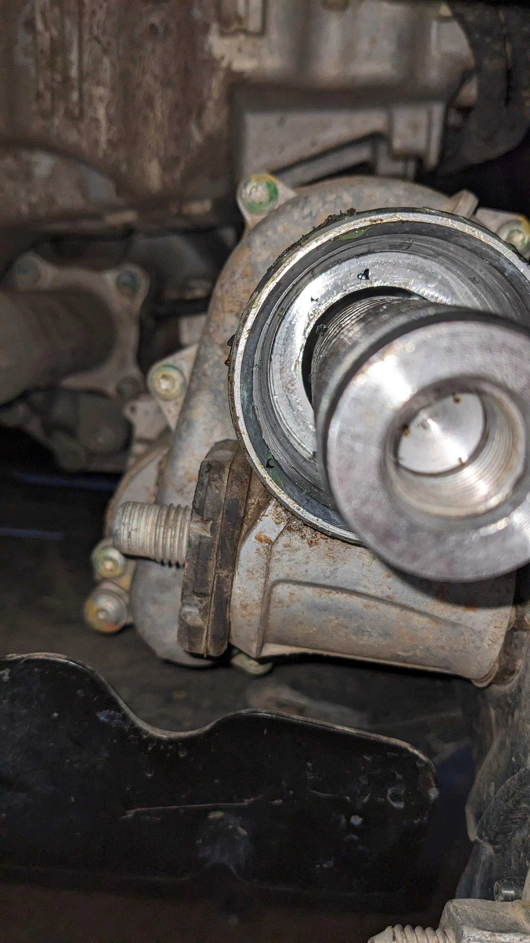

In the housing
Ford Bronco Snacktime's Bronco maintenance starring someone else's Bronco (torn CV boot fix, bushings install, and Metalcloak goodies) PXL_20230607_174713080.MP

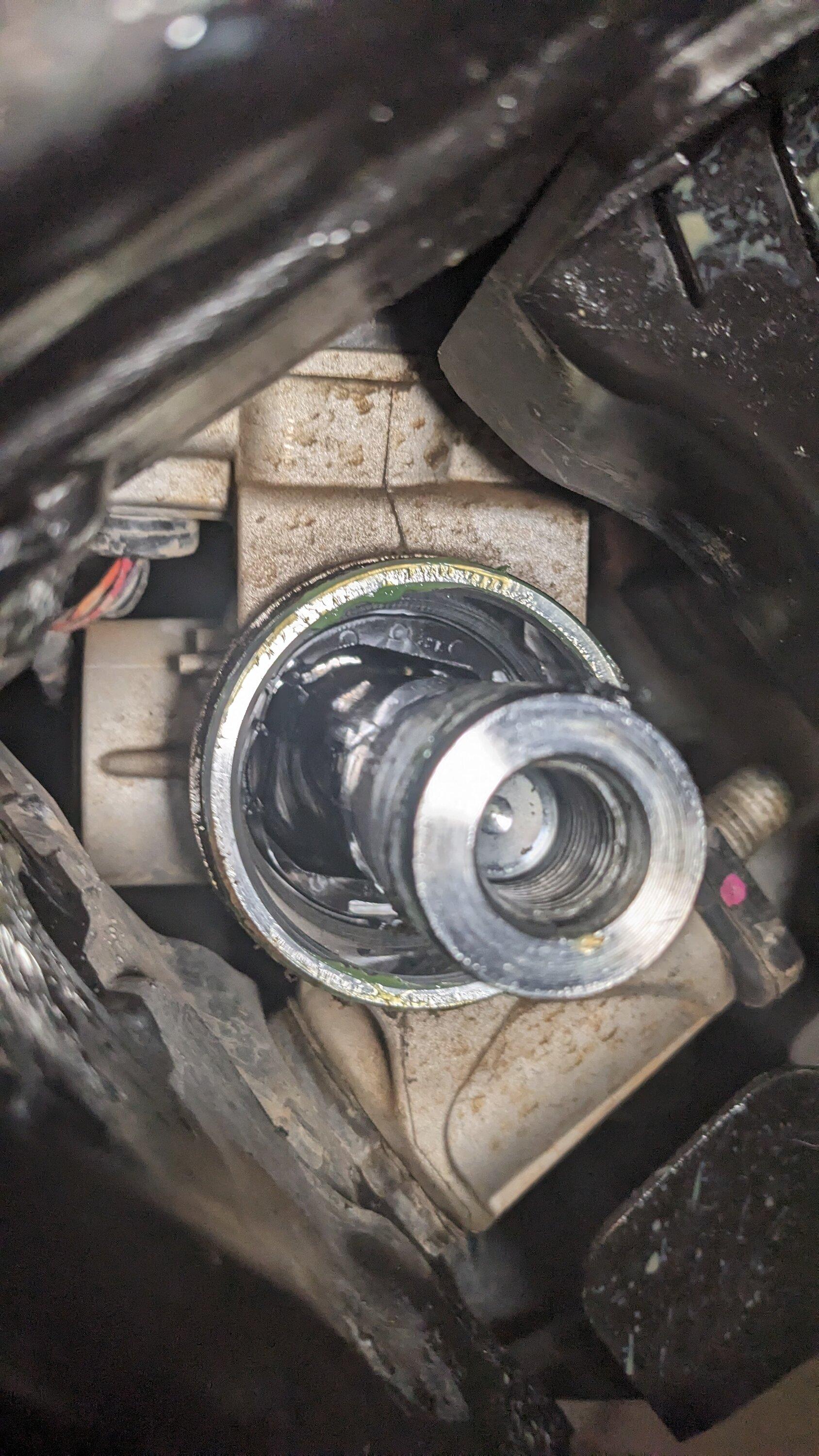

Housing had serious damage, filed it down and cleaned it up. Otherwise not much you can do.
Ford Bronco Snacktime's Bronco maintenance starring someone else's Bronco (torn CV boot fix, bushings install, and Metalcloak goodies) PXL_20230607_175609893
Second chunk was all the way into housing and could have got caught in the gears.

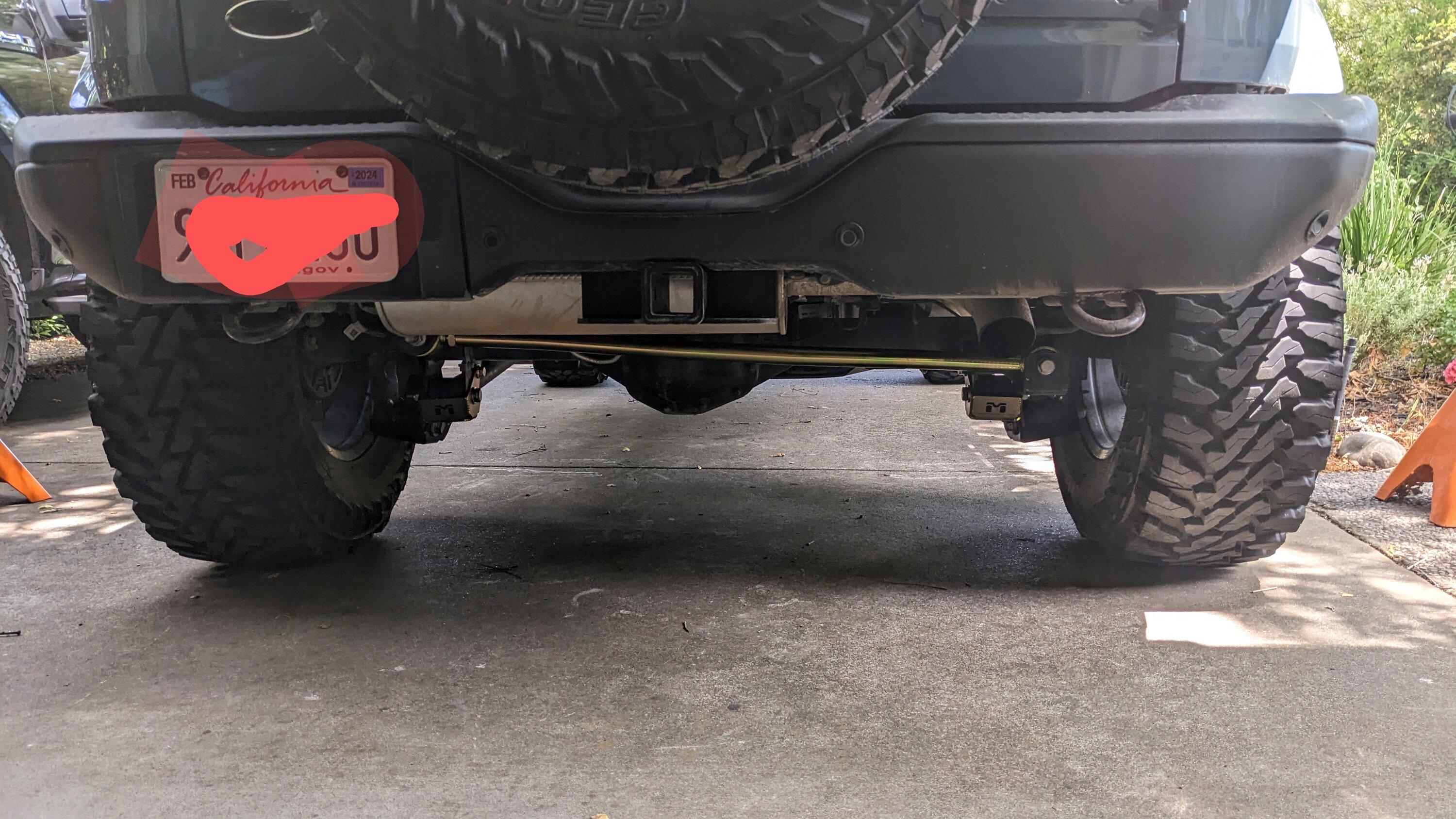

Then we threw on a few goodies he won at @Wild Horses 4x4 event provided by @Metalcloak fit and finish was excellent. Milwaukee impact made this less than a 1 hour job to install.
Metalcloak adjustable track bar
Metalcloak lower control arm skids
Wild horses shock skid plates

@popo_patty CV axle isn't worn out at all. It's the location of the wear near the outer edge of the cup. It's just a tell tell sign of that the cvs are to short or being ran at to much angle. Also I tried to leave out how famous Robert is locally lol.

I tore off those exact SAS length puck spacers, yes they are 100% safe to run. They do reduce the strength of the stock CV Shafts to a noticeable amount. I find myself recommending Bilstein 5100 & 6100 due to the length and quality of product as the best lift option. I am very pro spacers as I still run .625" of spacer lift.
