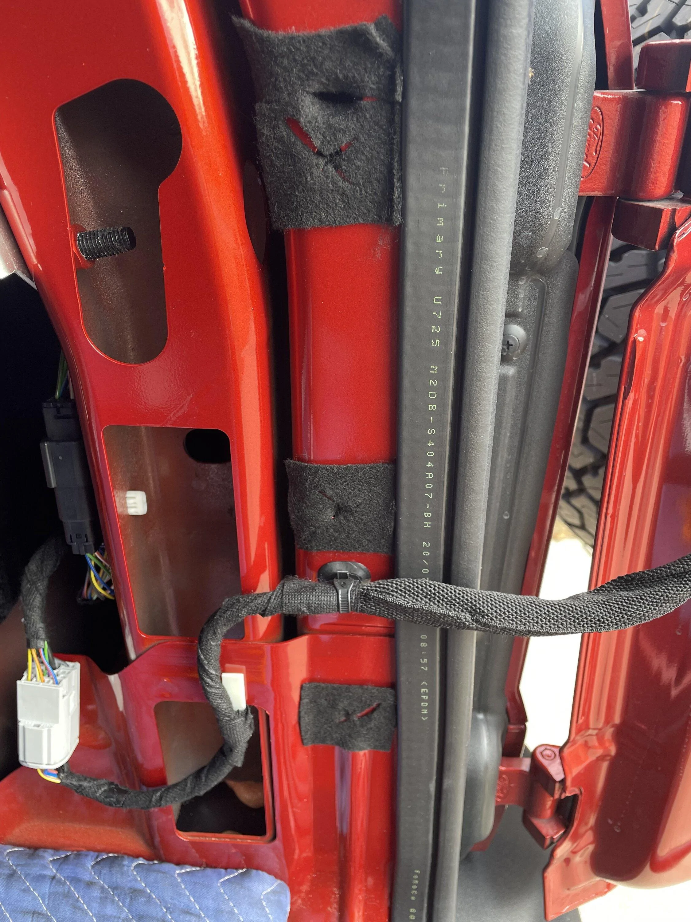

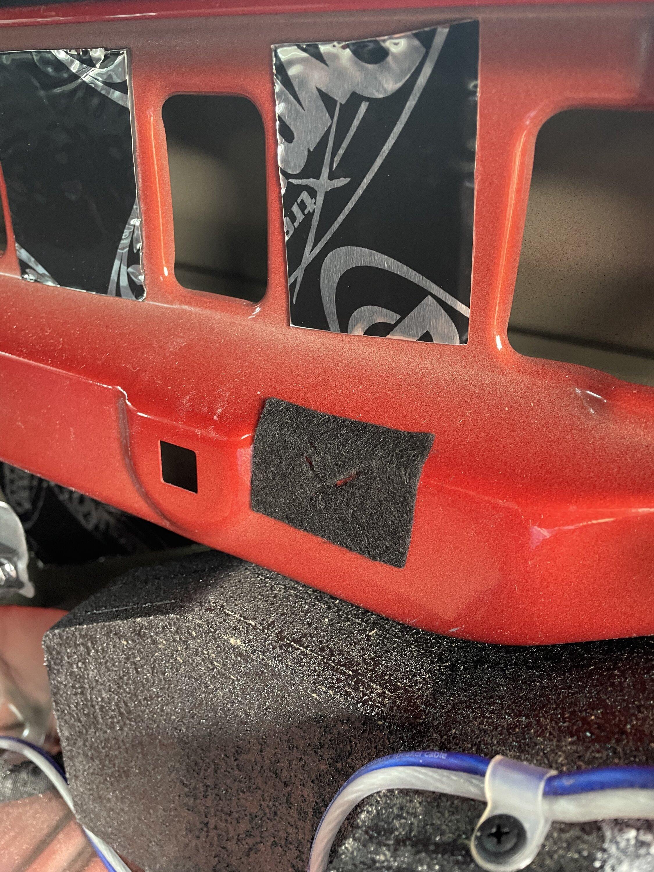

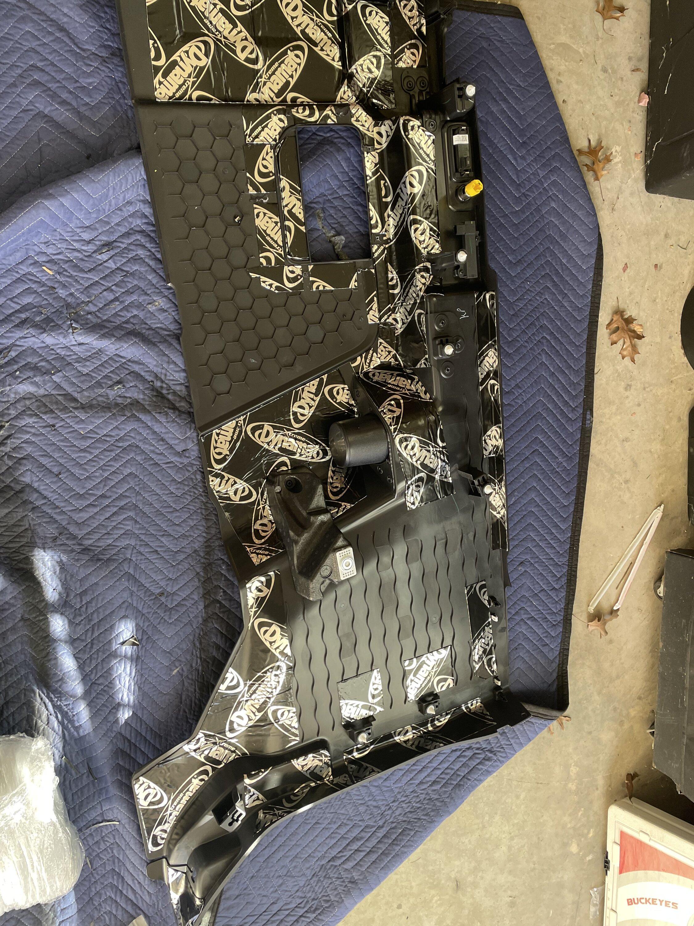

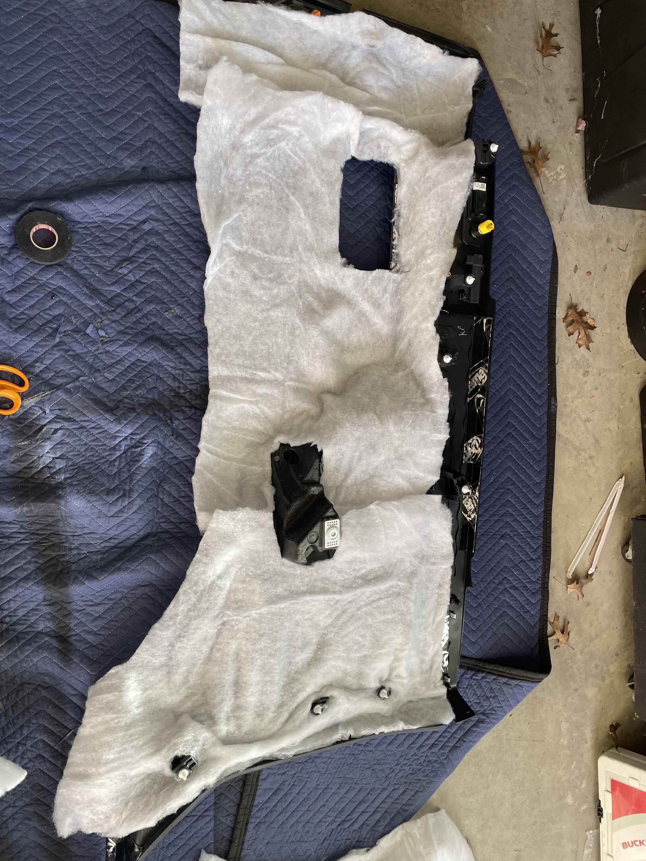

I have the base system and installed the kicker key amps and a Kicker sub in B&O sub location with an aftermarket box. Here’s what I did to prevent rattles.
1. adhesive-backed felt over trim pin/clip holes and cloth tape on panel where the pins mount.
2. dynamat on fiat areas of trim panel to add weight
3. Attached quilt batting with double sided tape to back of panel to prevent metal to plastic contact.
