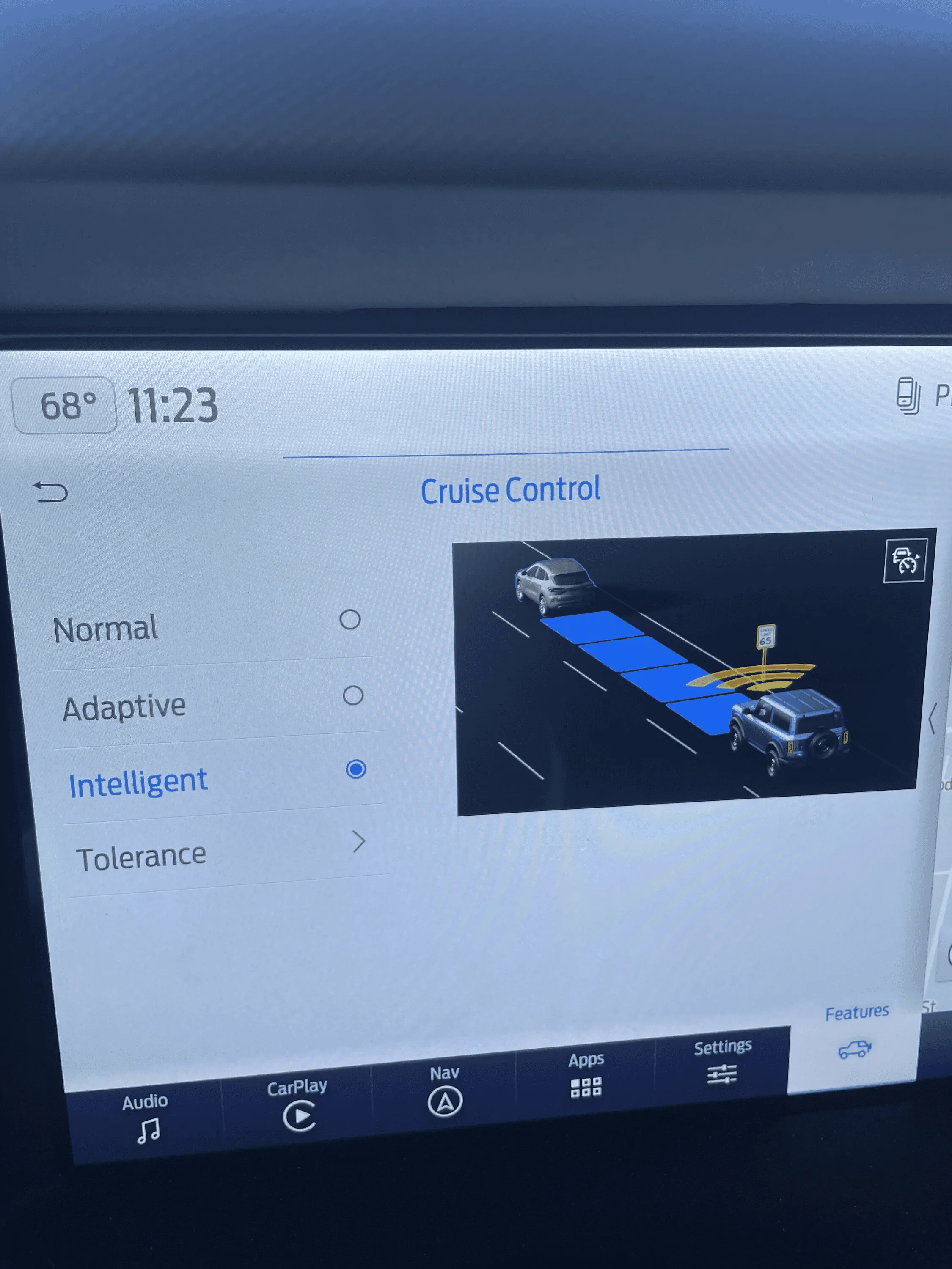

You have to use intelligent adaptive cruise control for the feature, on vehicles that have co-pilot assist plus or 2.0 or whatever its called. What shows on the dash comes from GPS unless your using intelligent adaptive cruise option. Like the speed limit in highway construction zone by my house, Bronco still tells me speed limit is 75 when there are 55 signs posted every half mile. My wifes Expedition sees the 55 and shows 55.

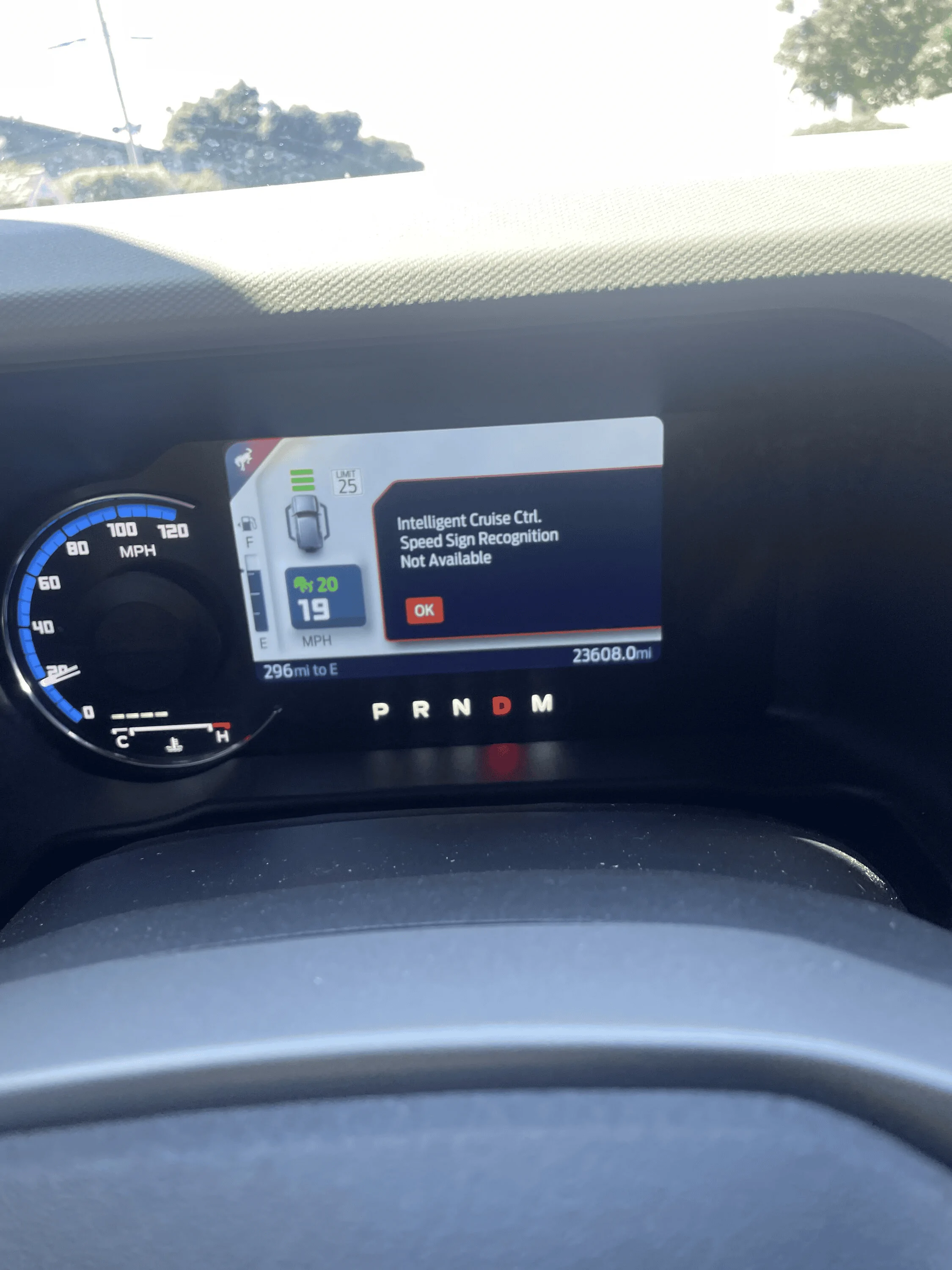

Want to see something cool that Ford is hiding from us.
Ford Bronco Speed limit reader 1694014466253
Ford Bronco Speed limit reader 1694014494667

Fascinating. I always assumed it was coming from Waze or whatever. Noticed a week or so ago on a country type road it wasn't showing speed limit and wondered about it. Happened a few times. Now I know. No signs!
I understand how the systems work. I'm just saying Ford does not mention anything about speed sign recognition coming from GPS on any models that have the capability even those without intelligent adaptive cruise control. Once again, it is possible the information I have is incorrect, I just don't see any evidence that says otherwise. Maybe I'll need to watch the speed sign recognition closer in construction zones like you mention.

There are even discrepancies between Carplay and the built in GPS map data. I can see different speed limits in areas depending if I have Carplay on or not, so the system has the ability to pull from multiple sources.
