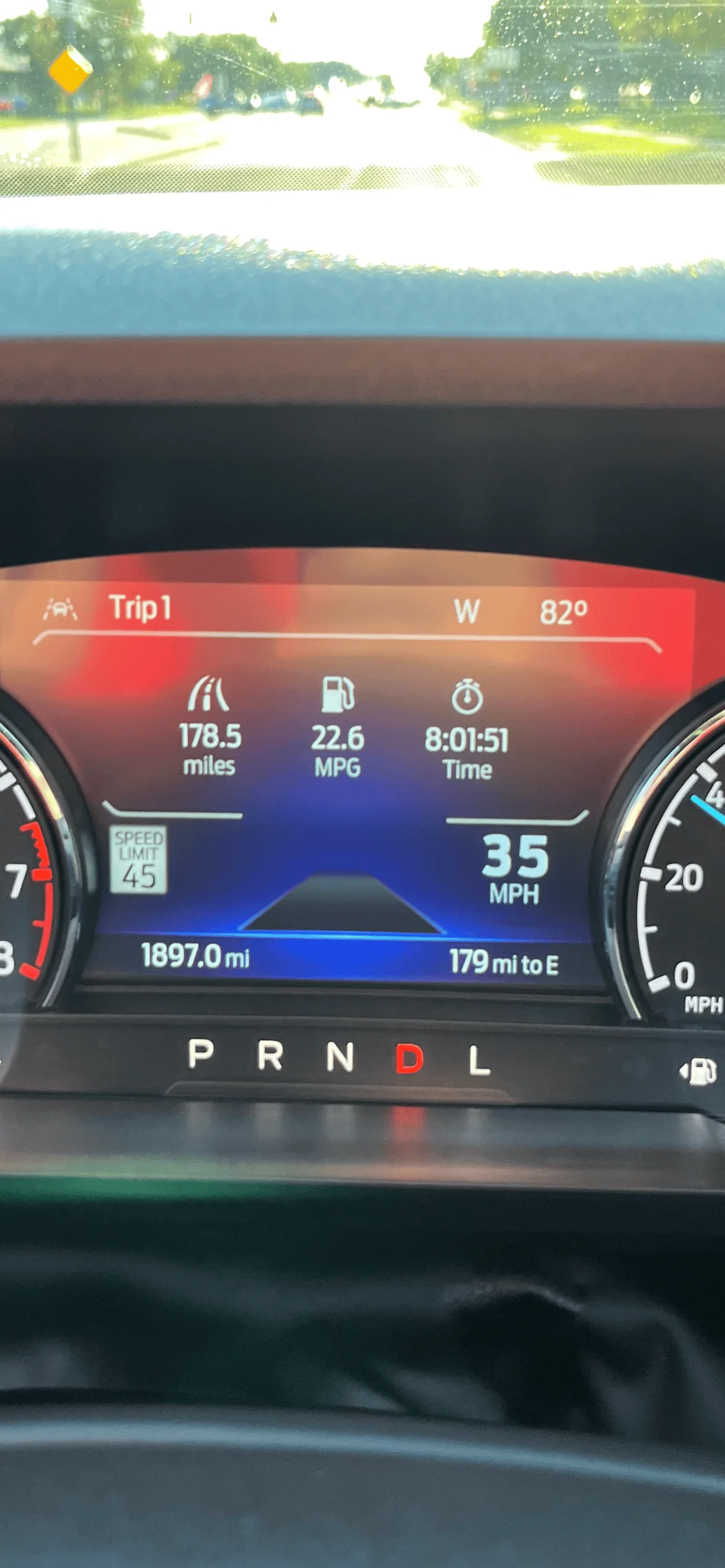

1. Every Ford Bronco has a front facing camera
2. Speed Sign Recognition - which displays the speed limit sign on the driver information cluster, uses the front facing camera which can be enabled in the IMPA module, it in no way shape or form utilizes GPS to determine the speed limit // This is different from any speed limit displayed on your navigation
3. Speed Sign Recognition may not show up as an option on your Bronco's menu but it can be enabled via Forscan
Source - I enabled it on my Maverick and don't a single one of your dare try and tell me that my 2.5 Sync lite can do something Sync 4 can't do.
This discussion is about included features from the factory. Others are working to get it done via FORScan.
