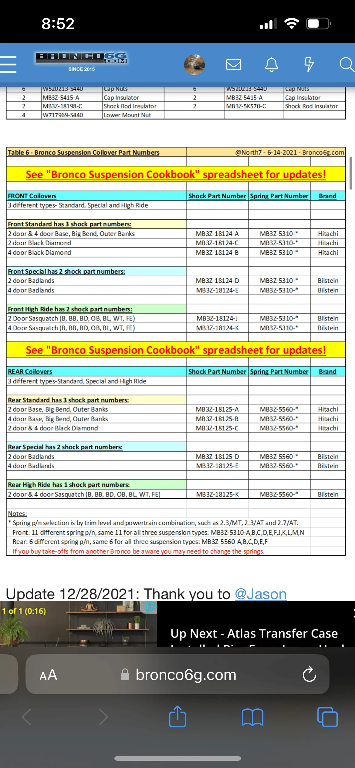

https://www.bronco6g.com/forum/thre...ide-lift-heights-with-wheel-tire-sizes.17719/
It does. Ford doesn't adjust the shocks based on bumper, but only on trim, tow, engine, and or sasquatch.
A 1" front level will level off most Broncos if you're riding in it unladen. Modular bumper would probably be level with 1.5 i guess, but thats probably a bit too far out of suspension spec worth going.

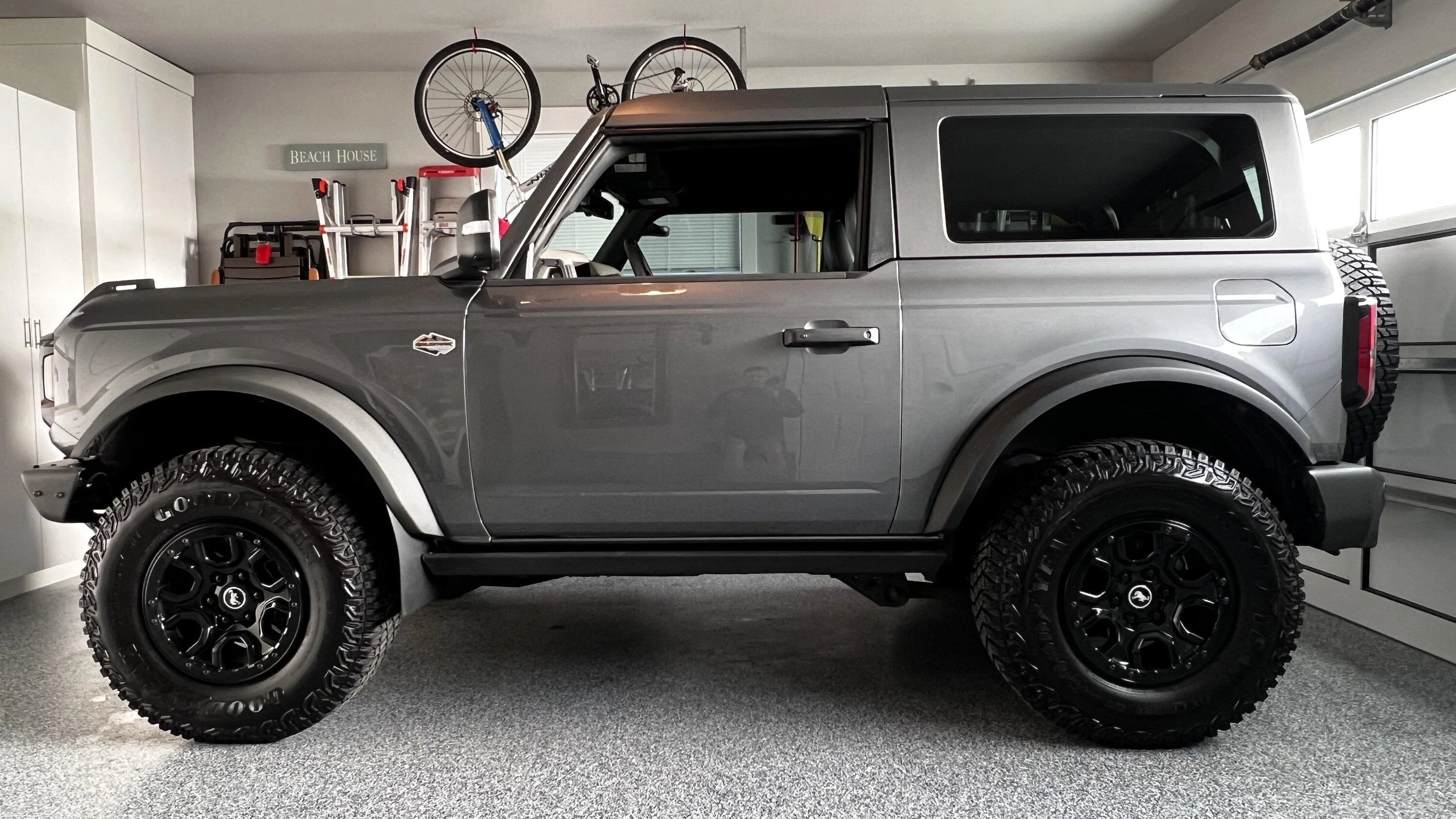

MY23 WildTrak. 1.25'' front rake with the HOSS 3.0. I leveled it with the standard Rough Country 1'' spacer.
