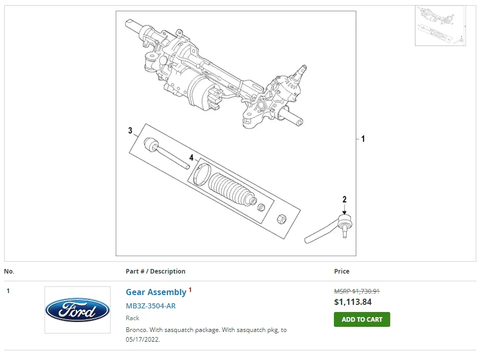

I'm curious what exactly "steering gear" refers to? Did the housing on the passenger side fail? Did the rack jump a gear?
The whole rack (1) is the "Steering Gear"
Ford Bronco Steering Gear Broken 1687458456635
Since it's 1 part number, dealerships aren't going to tear them down to examine the specific failure of housing verses belt, In fact, I'd wager the majority of dealer techs don't even know there is a belt in there..
Correct...serviced as an assembly. "Gear" and "Rack" are two terms for the same assembly (traditionally worm and sector type were "gear", and rack and pinion type were "Rack" but the term "gear" applies to all technically)
