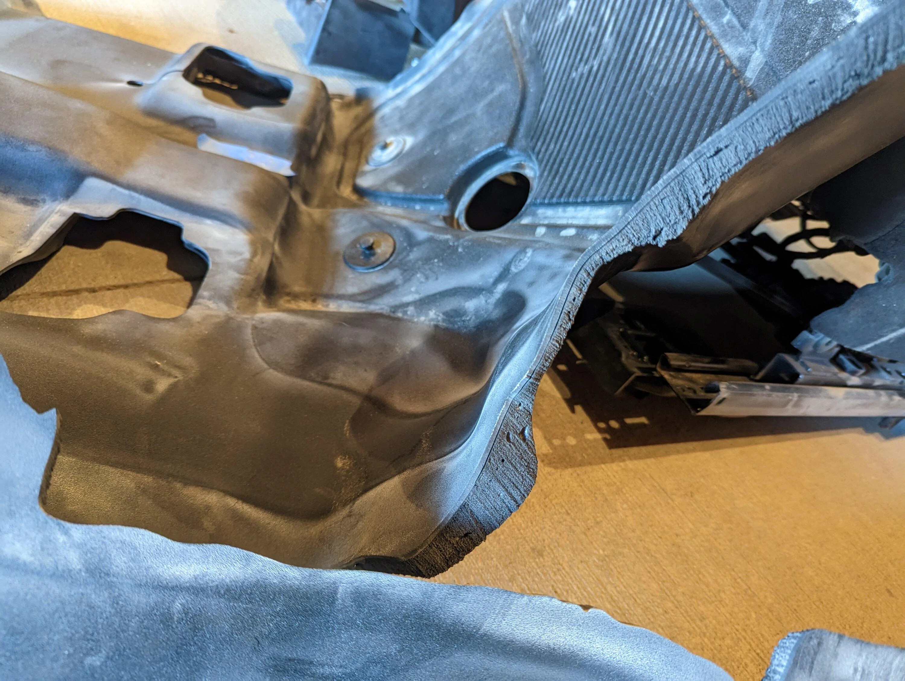

Some mild documentation from last night and today:
First, thank you to @Broncola for this post. Saved me some head scratching. There's ample documentation about getting through the firewall for automatics. They get the handy, accessible, and large grommet covering the hole through which the clutch passes for us 7MT folks.
Feeding my bulky bunch of wires through the small upper nub of the main grommet was NOT FUN. I was a bit beat by that time later on yesterday, so maybe that's a factor. Top of list so far for PITA factor.
The best I can describe is this. You can choose no more than two of the following at the same time:
  • Have a line of sight.
  • Get flashlight on it.
  • Touch it.
The challenge was exacerbated by a few factors:
  1. I chose to run 4ga instead of 6 recommended for the mObridge in case I decide more amplification is better someday.
  2. I ran a separate 10ga for the sound effects amp so I could keep the fuses as close to the battery as possible.
  3. I also had a pair of 16ga speaker wires for the external speaker in the engine bay.
But it's done now, so I will stop complaining.
