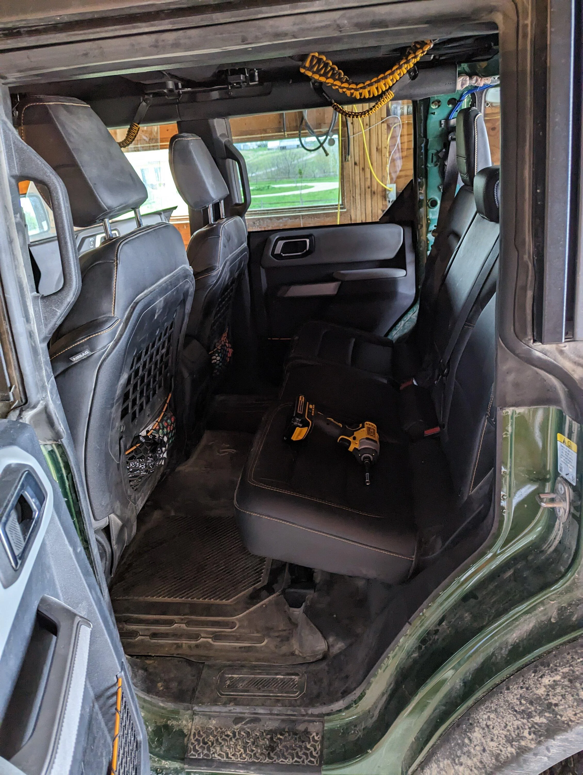

It had appropriate cutouts for everything except these three rear seat bolt holes. These were overlooked (red circles in last pic).
I did the doors (with Second Skin Damplifier - made a big difference) then got busy. I have been intending to do the floor since I got my BD last autumn, and bought the stuff; but am concerned about the possibility of creating a mold sandwich between the deadening layer and the reinstalled washout floor; or maybe even under the deadener. I think once the deadener is down it ain't coming back up if a problem develops. My theory is maybe it isn't a bit deal so long as the drain holes are fully sealed - maybe lay down some silicone beads before laying the washout floor back down? Did you consider this and if so what are your thoughts?

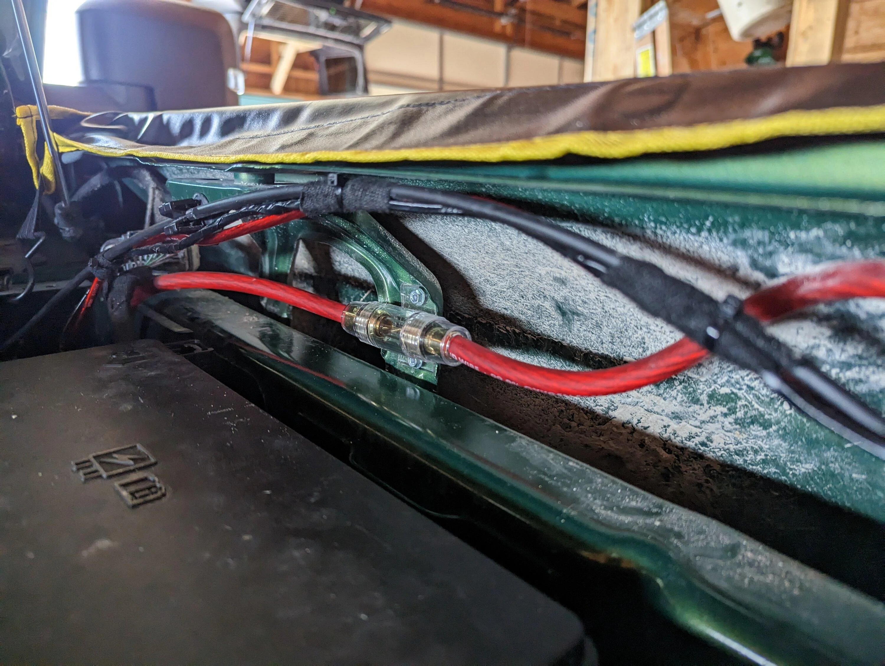

Glad to see another manual transmission owner trying to run wire through that grommet. I will need to get one 4 AWG and one 8 AWG run for my amplifiers through that grommet (or by another means). I’ve seen people also poke through the lower part, too.
I was originally going to run 0 AWG to the amps; glad I changed course.
0 awg would have been a challenge. Probably possible but not fun.

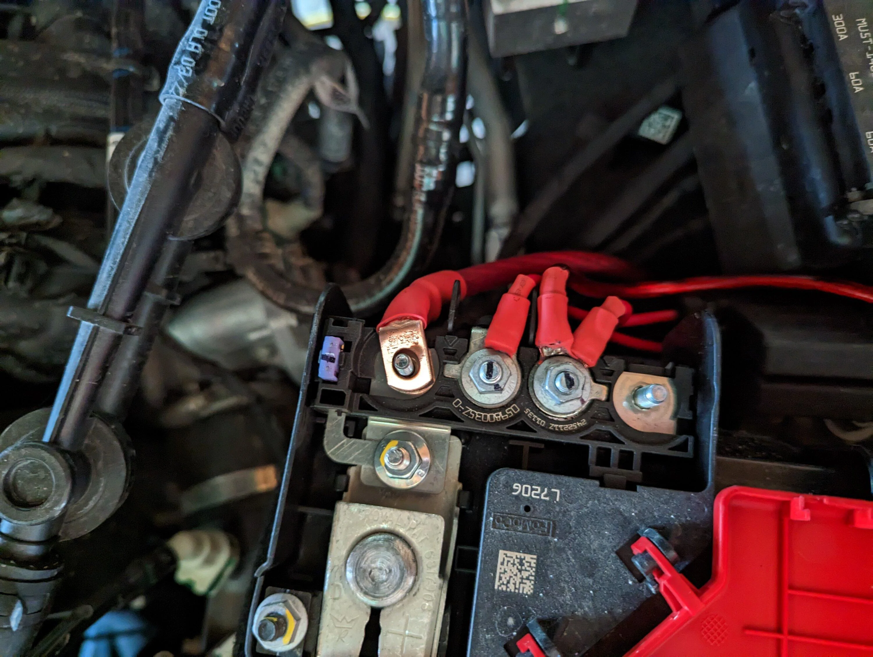

I ran one cable through the firewall (4 awg I think) and put a distribution block under the dash by the steering wheel brace, a little farther back or off to the side, towards the fuse box. Ran 8 awg to each kicker key amp (200.4 & 500.1) from the distribution block. Worked out really well!

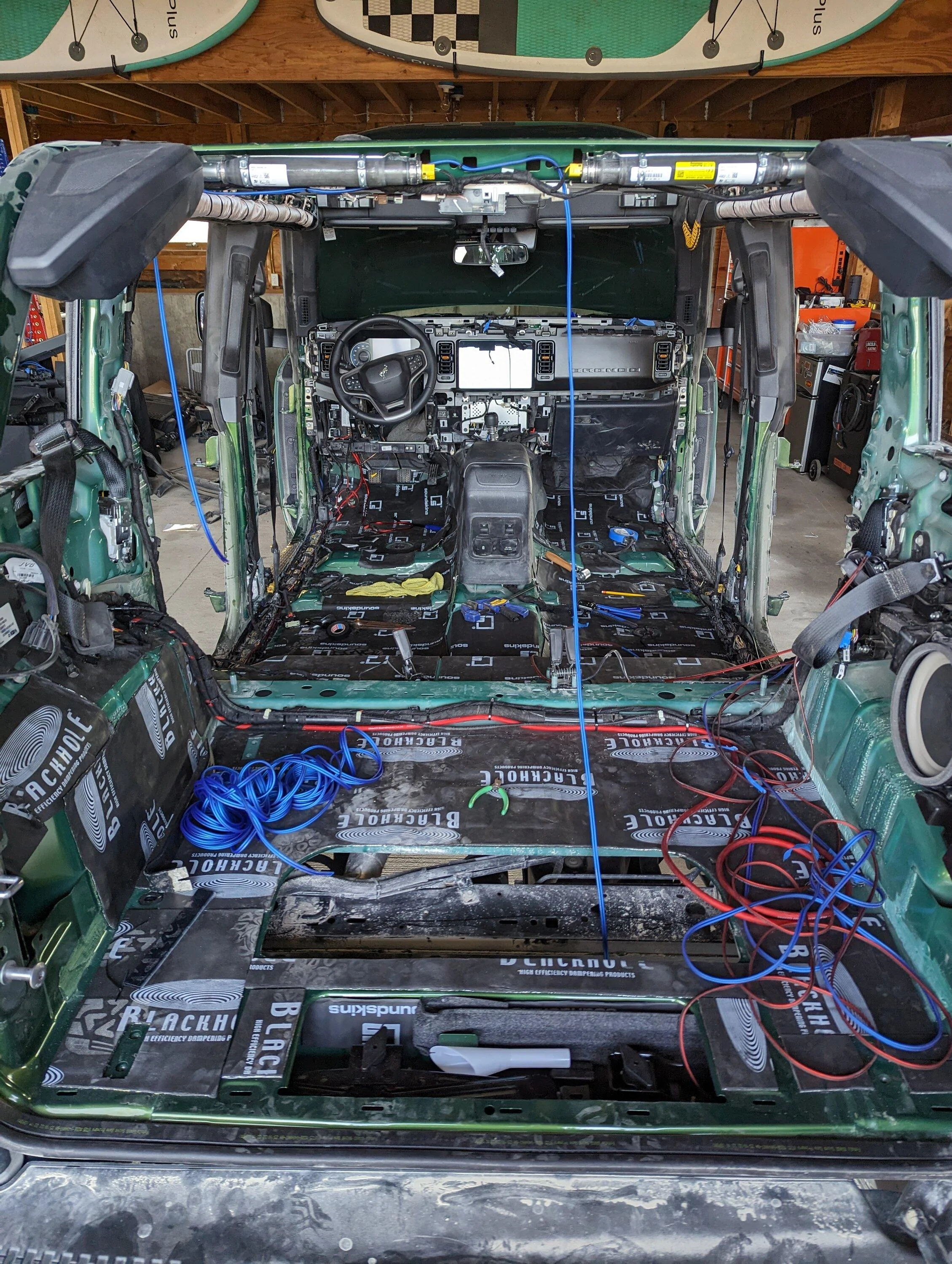

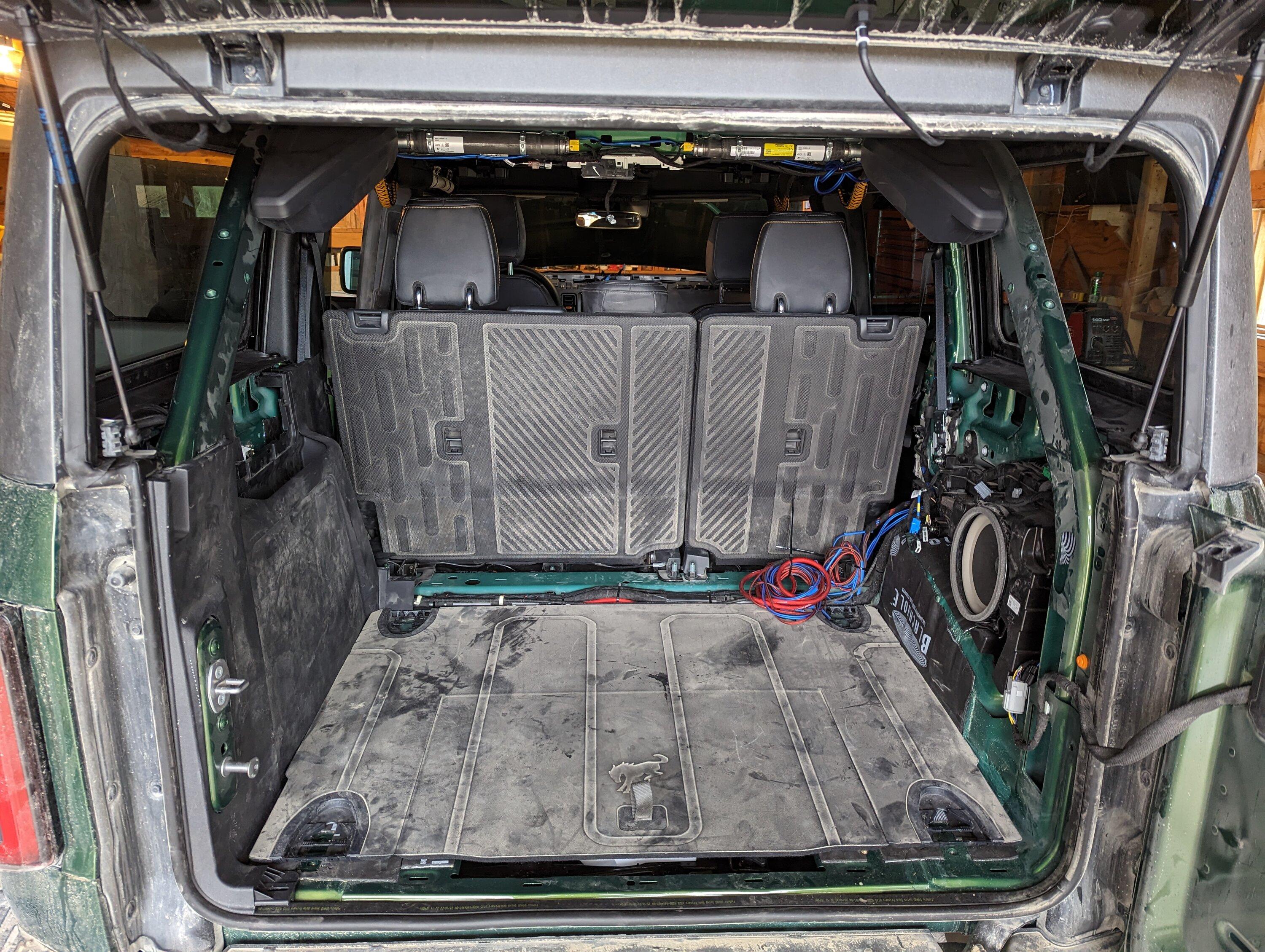

Sorry for the delay. Today's Wordle got in the way of me posting here for the last few days. 😝
Wiring is done. Home runs from the stock amp location to all speakers, 9 in total.
Washout floor, seats, and most of the interior trim went back in without too much trouble. Broke some clips along the way. I had ordered a variety pack, but none of them really helped.
The door card clips I had tucked away in the back of my 2015 LR4 really came in handy when I reinstalled the drivers side panel in the trunk. Perfect fit.
Dash bits are still on the floor of the barn. Waiting on the speakers before the final snap in.
Received the mid woofers for the kick panel yesterday. Mounting plates from soundsgoodstereo provide a little extra clearance. Not sure how much trouble this will cause when I put the trim back. Cross that bridge later.
M3 Carbon mid for the center channel arrives tomorrow. Not sure what improvisation will be needed to make it fit.
Machined mids and their tweeter pairs are with the "Meshman" now. I should have those and the custom mounting plates next week sometime.
Fraser from mObridge is waiting on some mounting plates for the amp to adapt it to the stock location. I'll be rolling with that and the BO sub until something better comes along (Stealthbox probably).
Hard to tell if the sound deadening makes a difference. I want to say it does, but that could just be confirmation bias. And I'm now driving with no audio at all, which is not how I spent my time in the car before this operation.

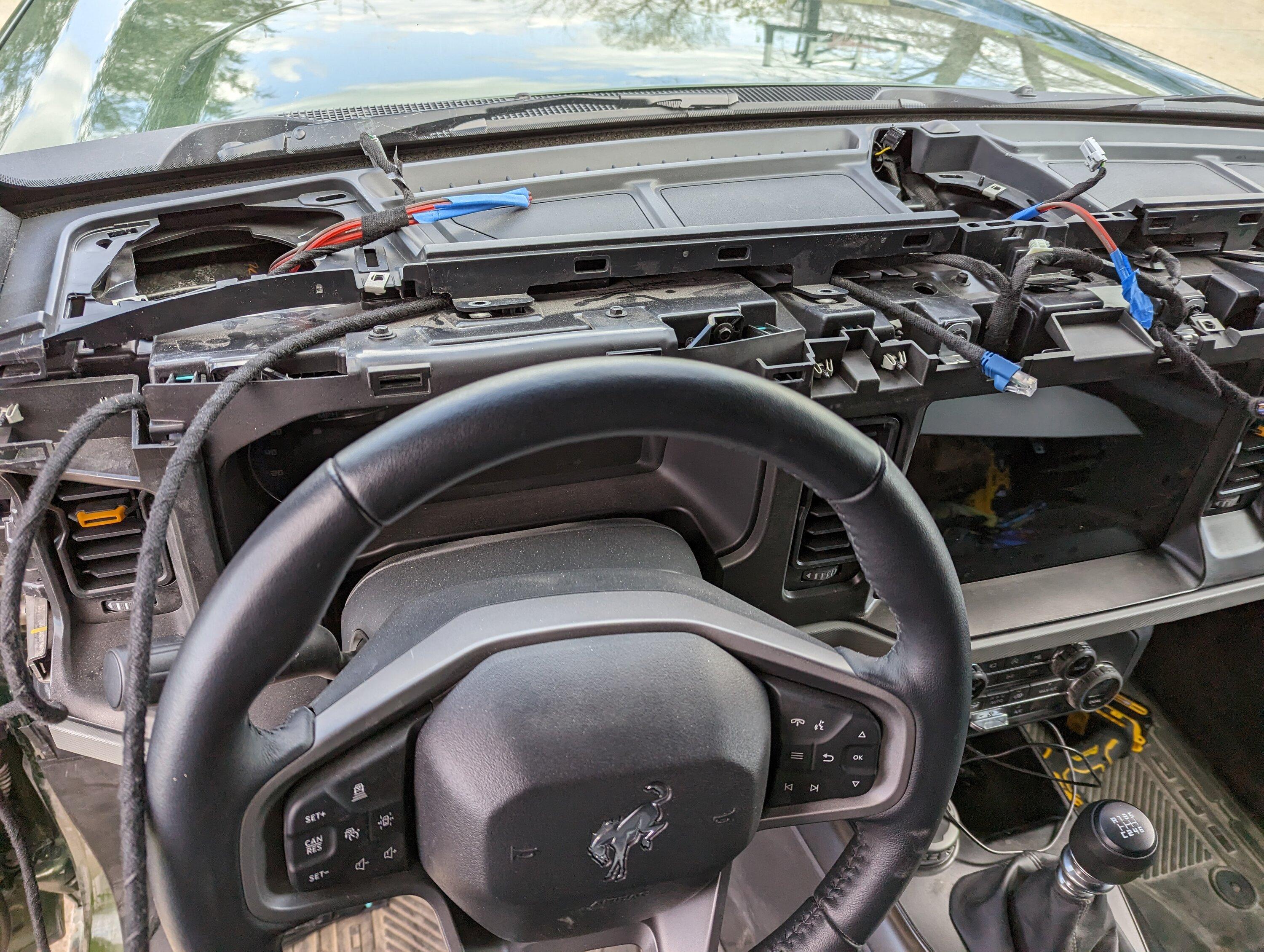

I have detailed pics of the wire routes if anyone wants them, but honestly there weren't that many forks in the road. Just sought to make it fit and keep some distance between the power wire and the speaker wire runs.

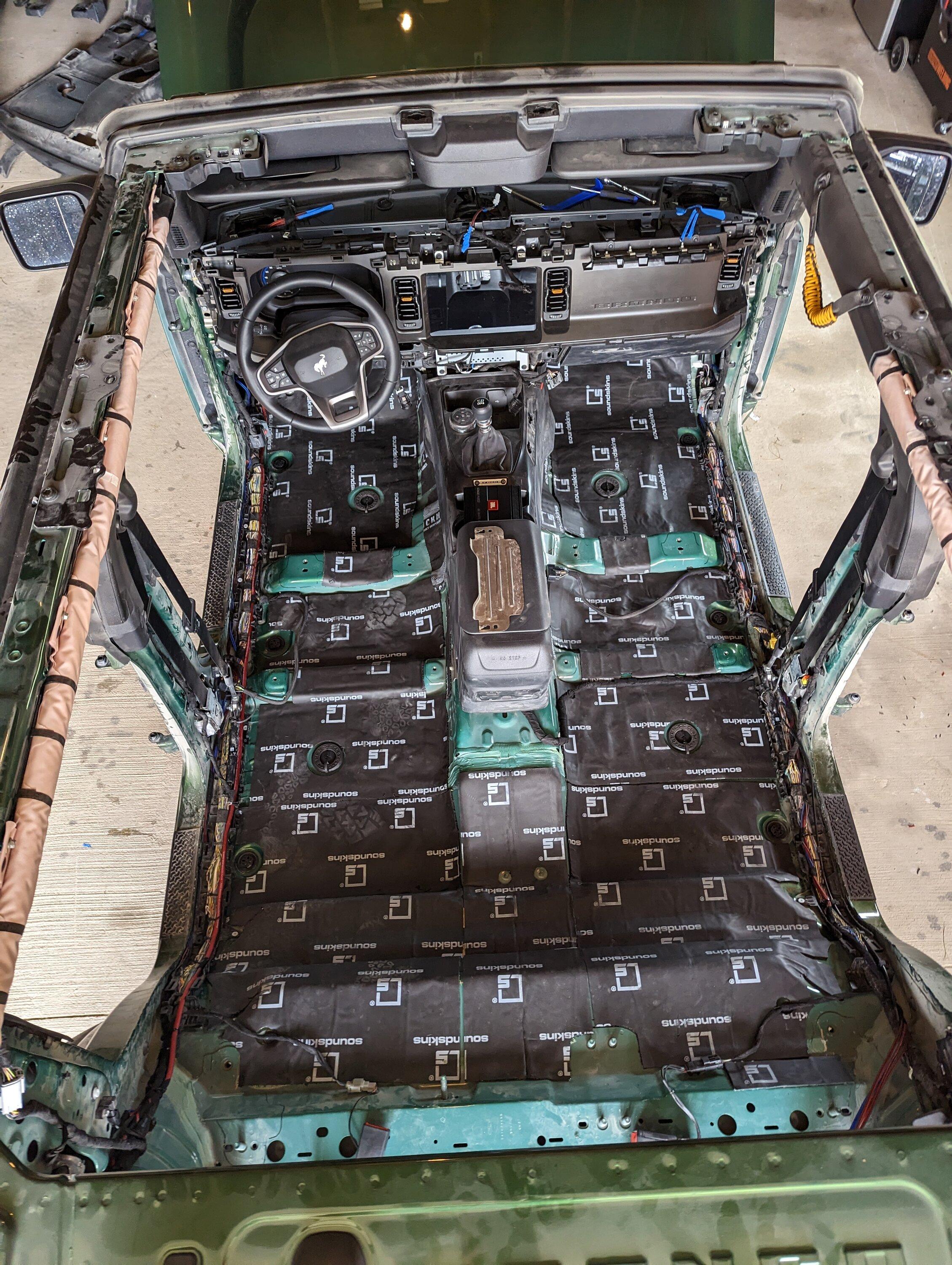

Here's the last few pics before I started piecing it back together.
Ford Bronco Stereo Overhaul - Mild Documentation PXL_20230418_235911063
Ford Bronco Stereo Overhaul - Mild Documentation PXL_20230419_181508625

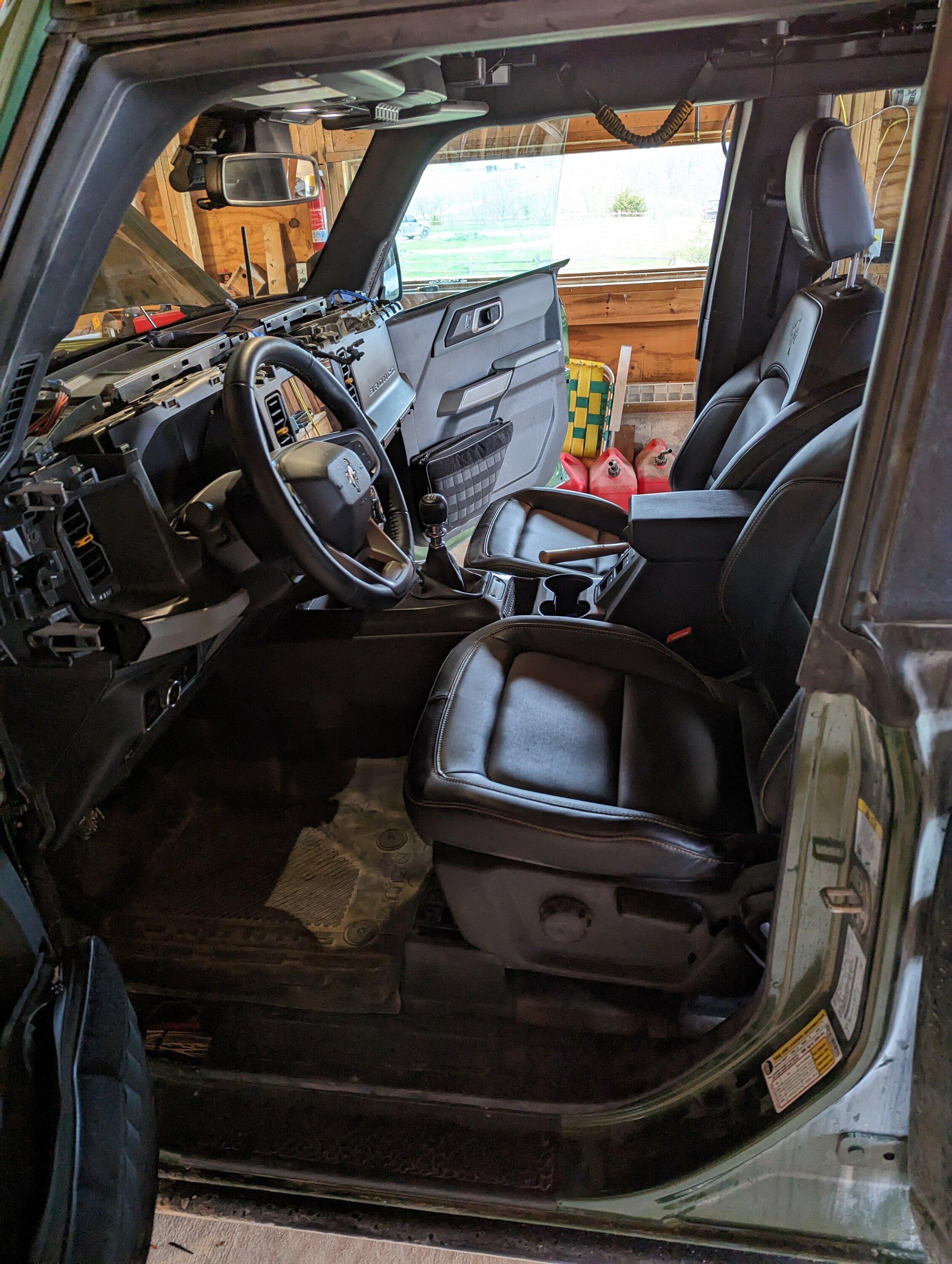

And here it was yesterday.
Ford Bronco Stereo Overhaul - Mild Documentation PXL_20230420_180046310
Ford Bronco Stereo Overhaul - Mild Documentation PXL_20230420_180056800
Ford Bronco Stereo Overhaul - Mild Documentation PXL_20230420_180100638
Ford Bronco Stereo Overhaul - Mild Documentation PXL_20230419_224000598~2

Your impression of sound deadening and confirmation bias seems consistent with other posts I’ve seen on the forum, including empirical dB readings. So much noise comes through the tops on these vehicles—soft top or hard top—to work against your efforts down below.
I have used mass loaded vinyl (Luxury Liner Pro from SSA) before in other cars, and that had a big impact on exhaust noise coming up through the trunk floor (Audi S5 with a V8 and AWE track exhaust, also a manual). That’s the right material for blocking noise.
I’ve already bought 36ft2 of sound deadener (and everything else for this project—thread coming soon). I plan to use it inside the kick panels and trunk floor; definitely not going all-in like you did with the floors. Knowing me the Bronco would be disassembled for a year if I tried.
Do you notice a difference when shutting your doors, though? Mine certainly have a tinny sound when shutting them, so if it helps I’d probably put a panel or two on the inner door skin.
Looking forward to next steps!

The floors were probably overkill, and maybe a waste of time. But this is my YOLO build and the what-if would probably nag me if I didn't go the extra mile.
Going full out on the doors definitely made a difference in the sound of the doors shutting. Still get that window slap a bit, but they are not as tinny as they were before. And the knock test from the outside is remarkably improved.
I also added remnants from the soundskinz panels to various points on the inside of the plastic trim pieces as I was reassembling. Nothing drives me more mad than rattles, either from road vibration or low frequency sounds from music. That should help.
I'm sure there will be additional spot treatments needed once I get everything hooked up again and can run some sine sweeps to locate resonances.
If I didn't already mention it, it should be noted that the soundskinz kits for the doors do not include any material for the outer door panel. I had some extra dynamat laying around for that.

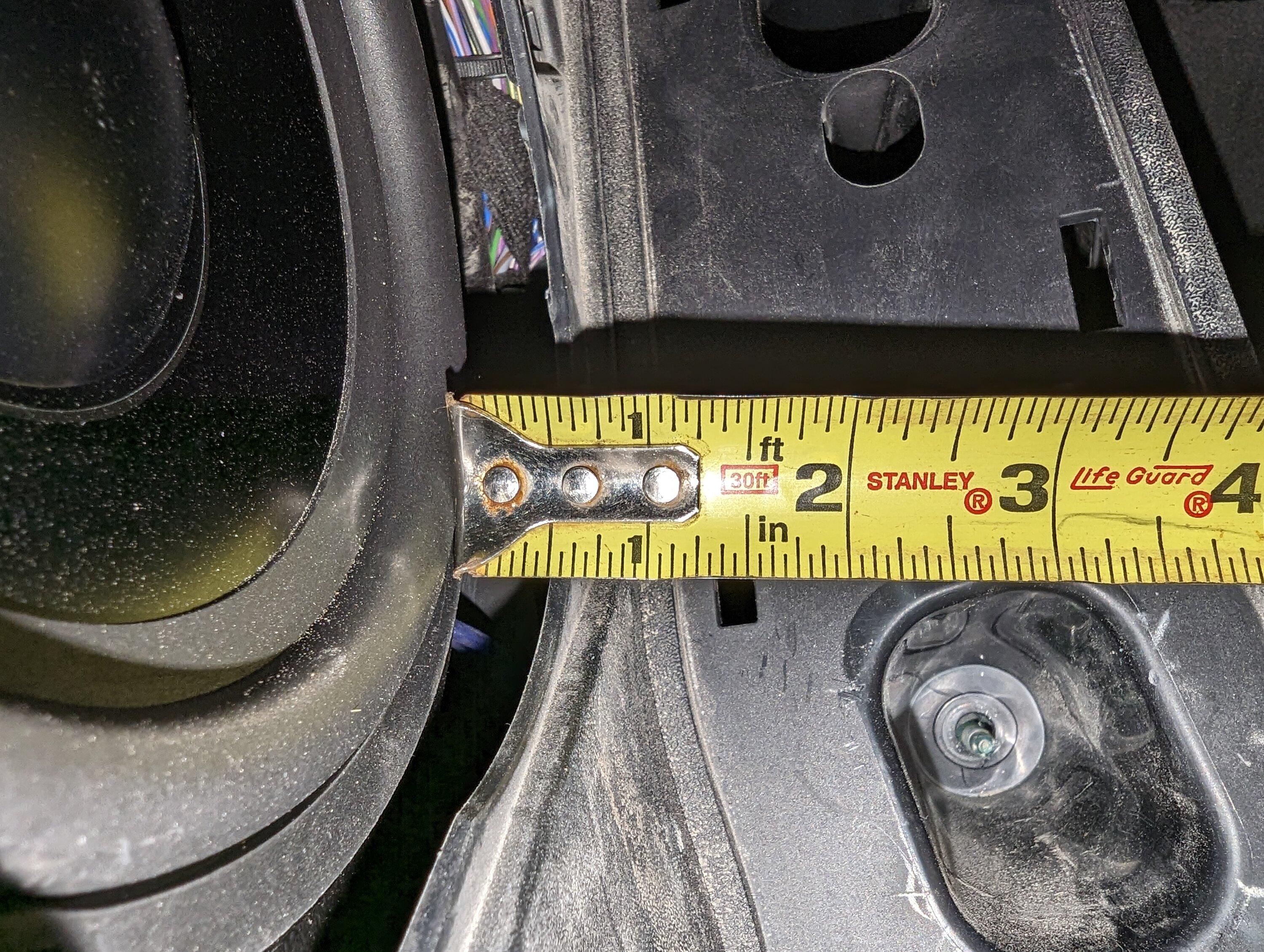

I would like to share my joy.
I wasn't sure if the kick panel trim would disagree with the half inch thick mounting spacer for the TM65s.
To my great pleasure, it fits without issue.

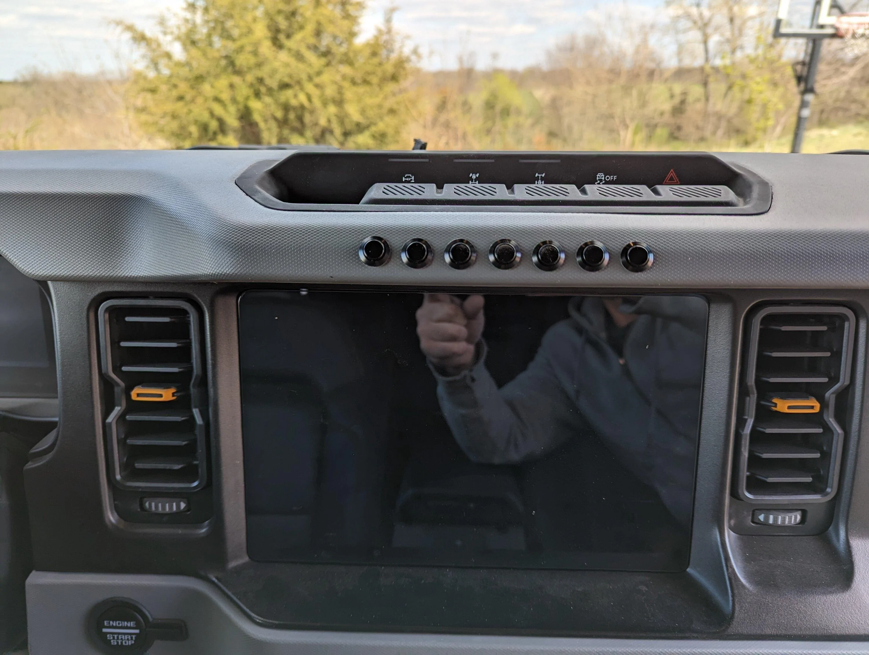

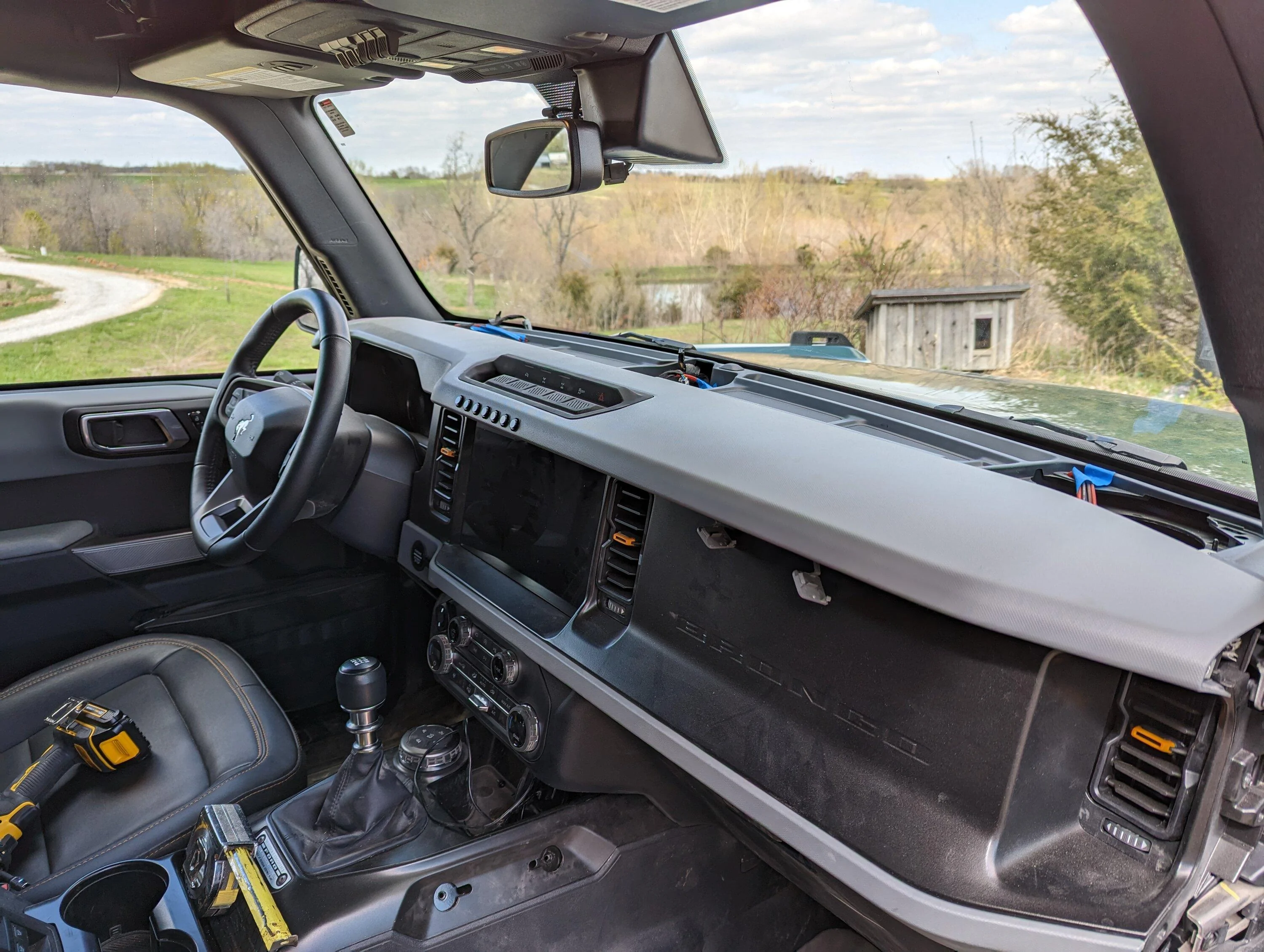

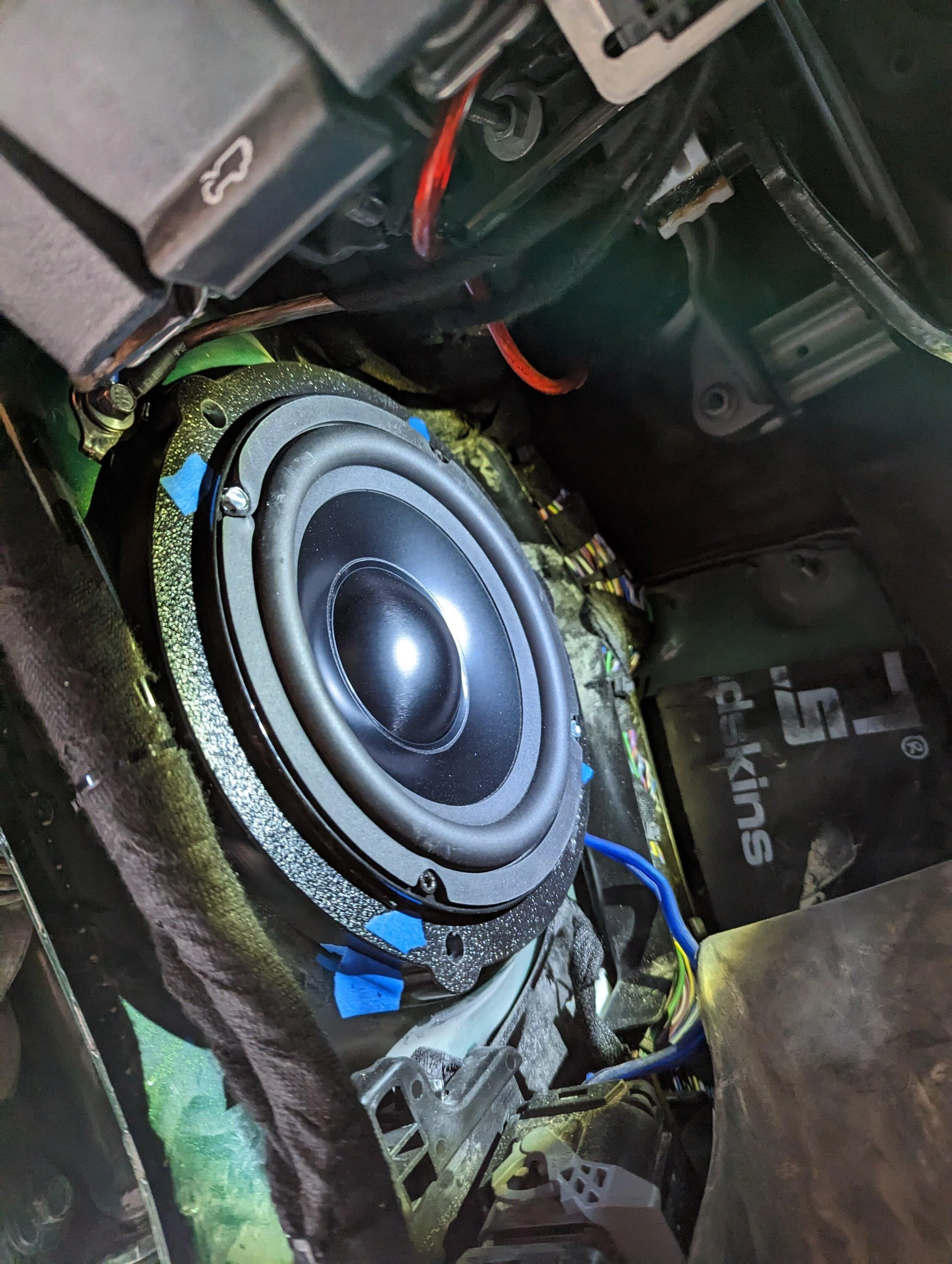

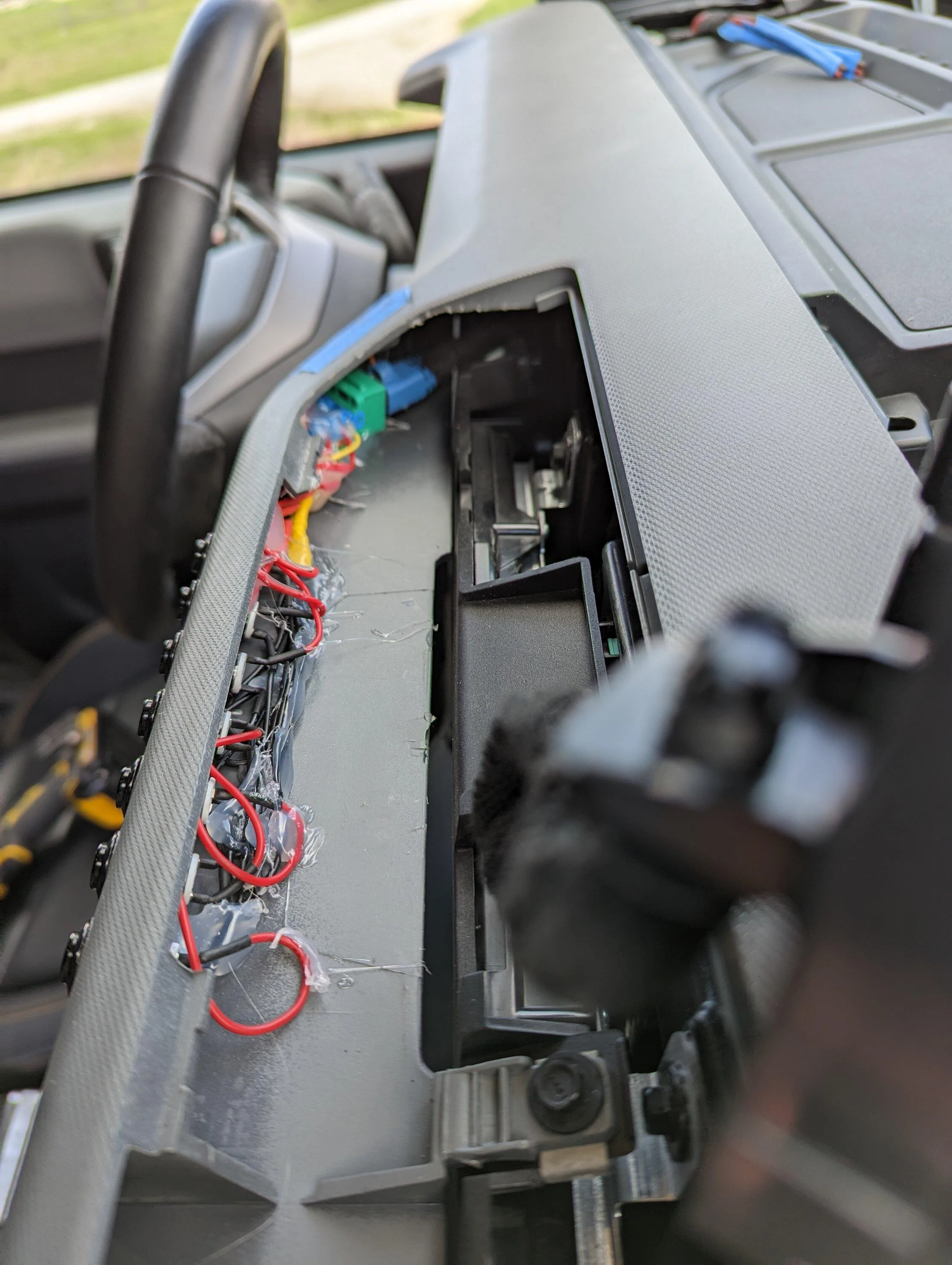

Woofers installed today in the kick panels. And I've got my dash somewhat put back together. Ethernet run from the buttons down to below the steering wheel.
Better speaker coming tomorrow for in the engine bay.
I'll be close to wrapping this up next week if all goes to plan. Probably won't have the remaining drivers until late in the week at the earliest. Adding to the Meshman job a mounting plate for the center speaker.

Oh wow, thanks for the info/link on the adapters! I'm planning on the TM65's as well and was figuring I wouldn't know what's what until I had everything apart and THEN would have to figure it out. This is perfect, thanks!

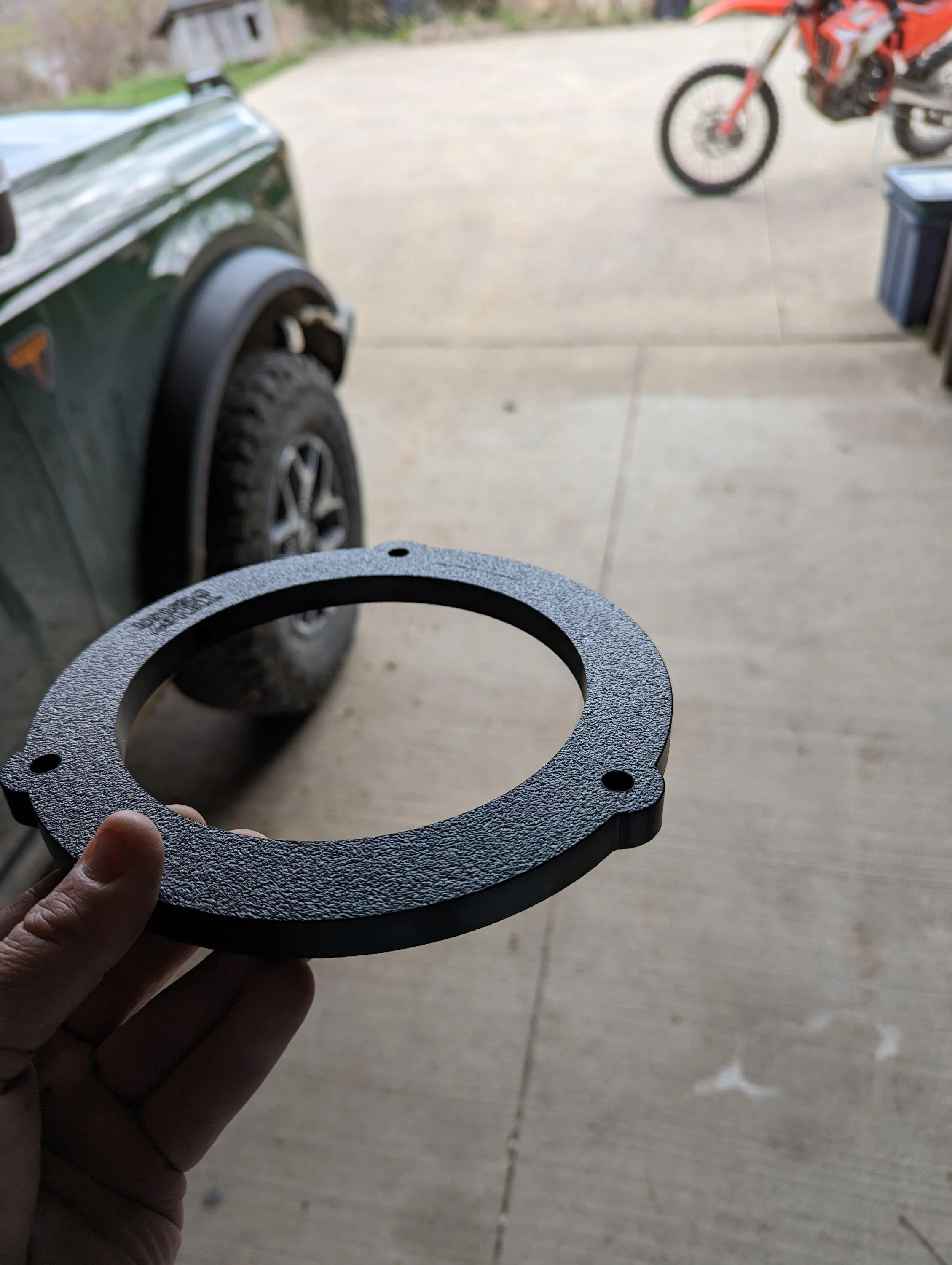

Here's a little preview of the front mounting plates from Meshman.
John P.
Jan 15, 2023
82
102
Orange County, CA
BMW X5
Nice. I reached out to Meshman, thinking that the plates were ready-to-install. Seems that more work is to be done after receiving them. I may still go with my plan to try the a-pillars for the tweeter location.
