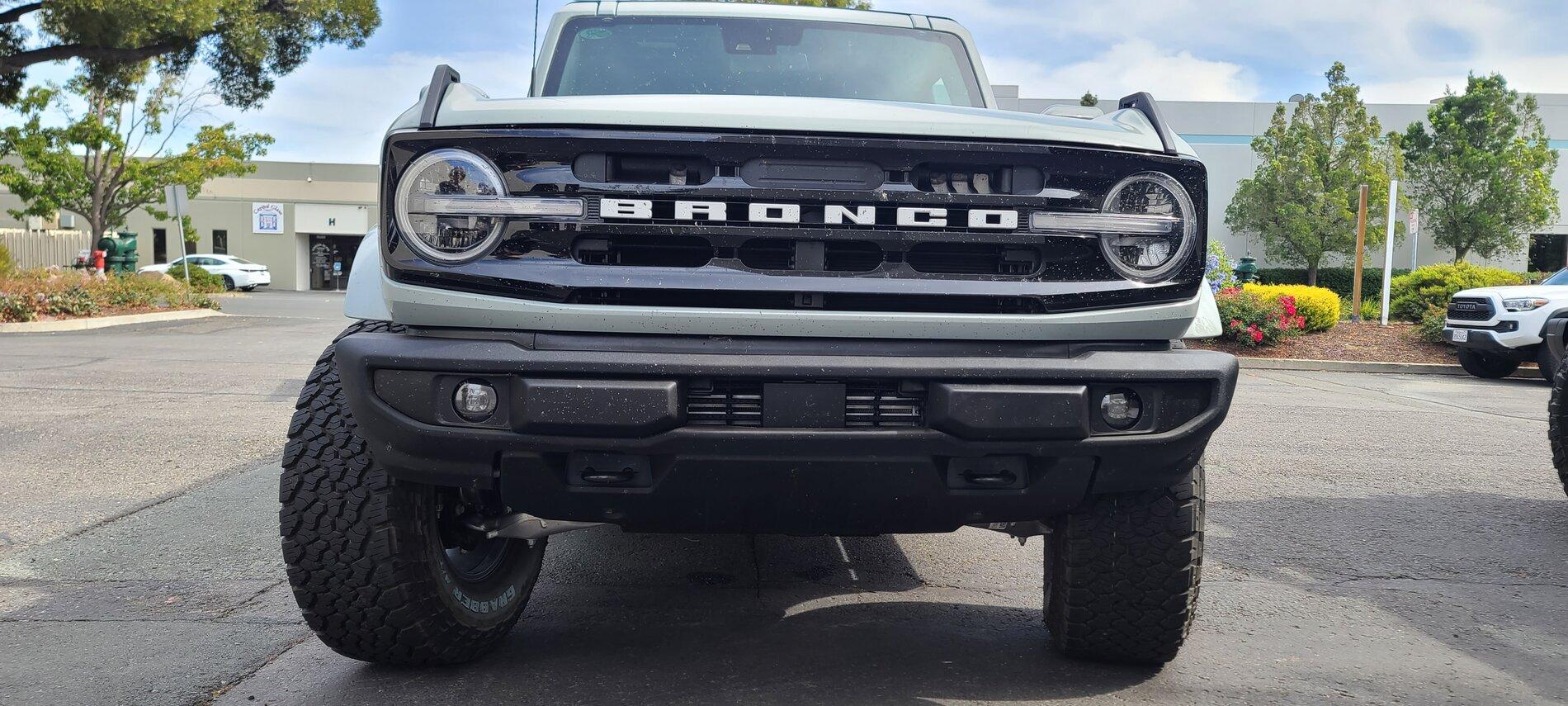

Ok I was feeling silly so I went down to the dealer to take a look at an unmodified setup. Looks like the installer removed the wiring harness back to the connector in the engine bay.

Positive, here a before picture.
Ford Bronco Stock Foglights, plastic bumper 20211006_124139
