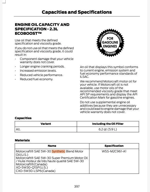

I dropped my Bronco off for service this morning and among the request was a full synthetic. The Ford dealership service writer asked why I wanted that. I told him it has been what I have always put in the car and he said Ford recommends a synth-blend... news to me. I still went with the full synthetic.
And sure enough it is a synth-blend...
Ford Bronco Synthetic Blend 1728934201017-zh

There’s Full synthetic and there’s synthetic blend (which is what Ford recommends like you mentioned)
No different than 87 vs 93 octane. Ford recommends 87, but that doesn’t mean 93 wouldn’t have additional benefits.
There is no “full synthetic blend”
