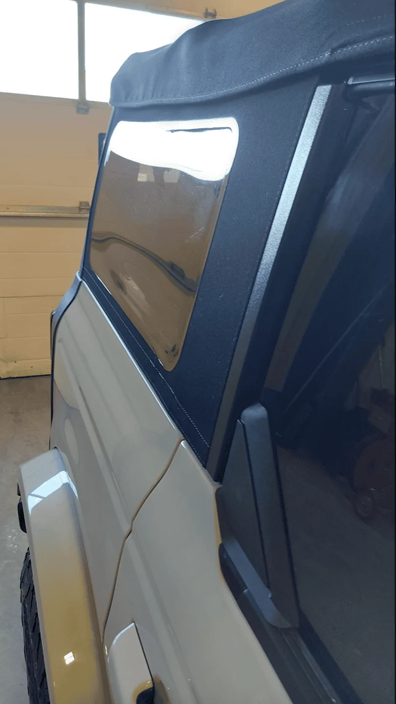

You just have a ‘22 with the redesigned top. My ‘21 clips are on a long flat part and can’t be twisted.I was able to tighten my rear softop windows a bit by just twisting each top fastner (male side) a full 360 degrees prior to being fastened, which had the effect of decreasing the fastner's overall length.
This method might strain or wear the strap of the fastner, but I found it worthwhile.
The results make it less wavy than normal, however, it does not eliminate the wave entirely.
Overall, I'm more satisfied with the look of my softop now.![]()
