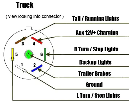

All vehicles/trailers work this way? Trailer brake controllers are needed for trailer brakes to work. The ONLY exception is surge hydraulic brakes.
Find a vehicle at the dealership without a trailer brake controller and put your multimeter on PIN number 2- there will be no voltage when you press the brake pedal. Do the same on a vehicle with a brake controller and note the difference.

Good info, already have and know this, nothing here says the Bronco does not have break controller capabilty if equipped with the tow capability package.
