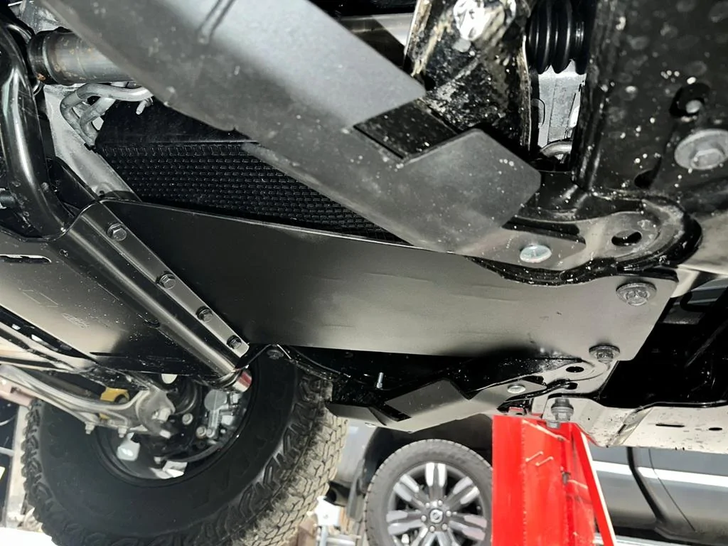

Before I climb under my Badlands SAS with full factory skids. Is my cross member covered with a skid or not? If not will the RCI work with the factory skids?
Our "full skids" do not cover the cross members (2.7 only) or transmission pan. RCI cross member and trans skids work with the OEM skids.
Not covered from the factory. They will fit, this is them on our Badlands -
Thanks I just ordered the Tranny, fuel tank and cross member skids. they are having a 15% or 20% off if you spend $1000 or more. It covered the cost of shipping and a little extra.
